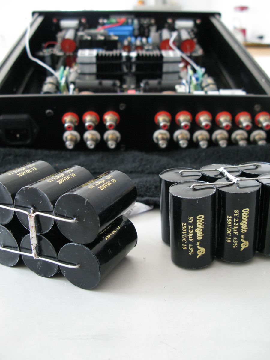

Morten, you are still using the six Solen 2.2uf tinfoil caps in the output stage in your Tram2?

Hi Peter,
I have never used Solen caps. I use 6 x 2.2uF Obbligato tinfoil (I kept the one delivered with the Tram and replaced the 10uF PP with 5 more of the Obbligato tinfoils)... This is one of the better upgrades for the Tram, these caps are really good and not very expensive.
It will be interesting to hear what you think of the rectifiers... My experience with the Philips is, that the break in is quite long so have patience... I still go back and forth between the Philips and Brimar. I can't say one is ''better'' than the other, they are slightly different and the ''better'' one is the one that has best system synergy. The difference between the Philips and the Brimar is much smaller now where the Philips is fully broken in, than it was when I wrote the comparison review earlier...
Hi Peter,
