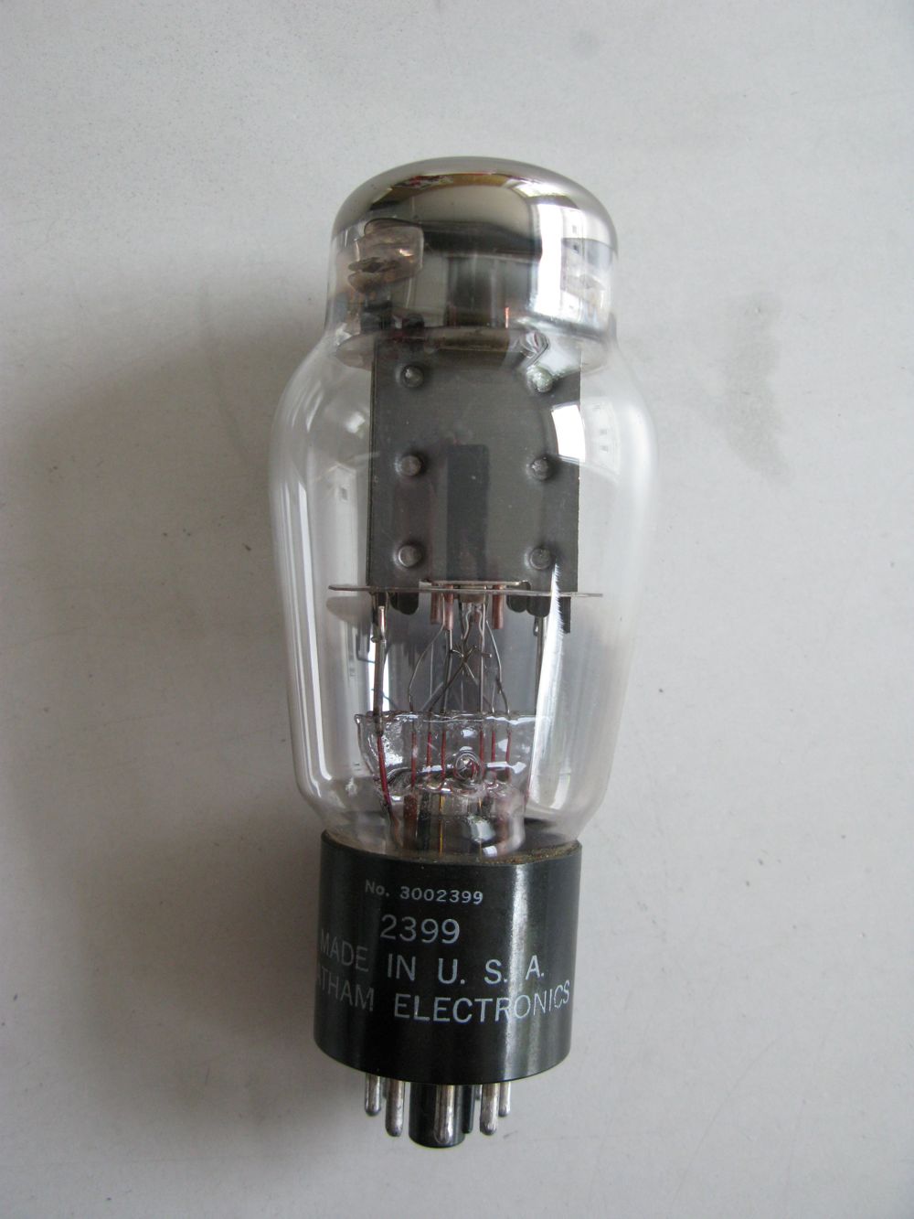

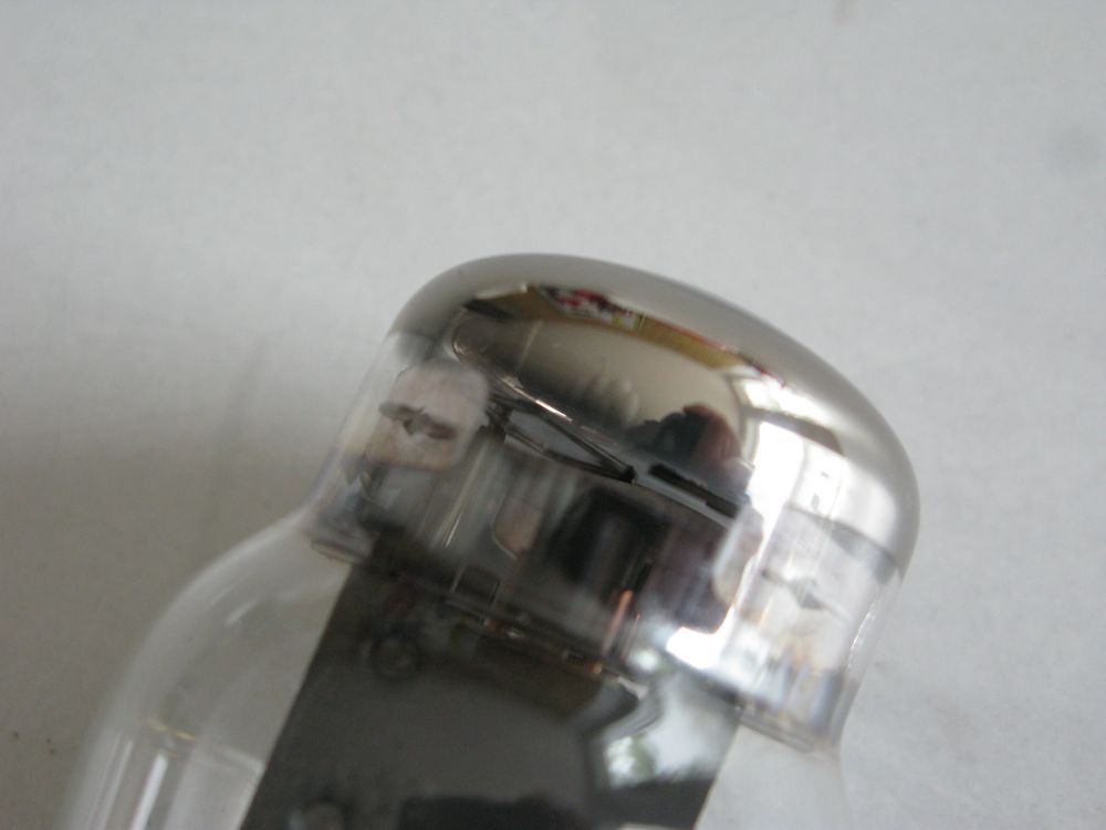

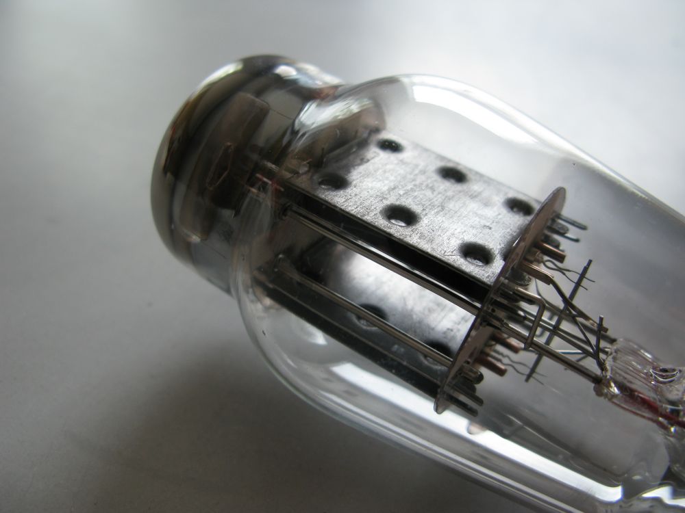

I'm looking into Mu tubes... The Chatham Electronics 6AS7G are very nice sounding, and should be some of the best 6AS7G types. Then I read that 5998 can be replaced for 6AS7G, and to make it even more complicated, then 5998 is sometimes labeled 2399 - like the Chatham Electronic I just bought. The 5998 / 2399 has totally different internal construction than 6AS7G, so I was a bit skeptical when installing in my Tram II yesterday, but there is music 🙂 Time to burn in the tube, it will be interesting if it works even better than the Chatham Electronics 6AS7G

I read that 5998 can be replaced for 6AS7G....
The 5998 has a different mu rating to the 6AS7G.
6AS7G Mu = 2 Gm = 7000, Rplate = 280 ohms
5998 Mu = 5.4 Gm = 15500, Rplate = 350 ohms,
6080 Mu = 2, Gm = 6500-7000, Rplate = 280-300 ohms
6520 Mu = 2 (1.9-2.4) Gm 6400 - 7600
6H13C Mu=2.4 ?????
7236 Mu = 4.8 Gm = 12500, Rplate = 350 ohms
Does that matter in its use as a mu tube?

I am reading this thread quite a while. Congratulations on your mods , every single time executed neat and skillful. Great ideas here and fantastic atmosphere of sharing knowledge about this design. Regarding your 2399 ,it actually looks more like 5998 any brand inside than 6AS7G itself. Never tried those you have got ,by the way ,but they look pretty intriguing.

Maybe I did not write clear enough regarding the 2399 tube... The 2399 is a 5998 that is for some reason branded 2399. It's NOT a 6AS7G tube..! So it's not that strange that it looks like a 5998 in it's structure 🙂
