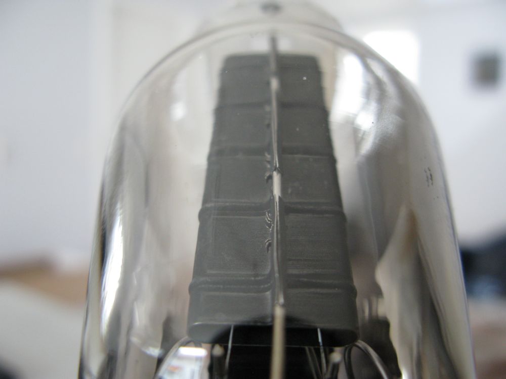

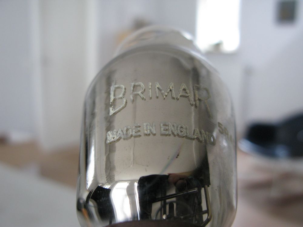

Ok... Finally did enough comparisons between the Philips and Brimar rectifiers to lock in on the differences. I think it's hard to compare rectifiers because it's not a simple A/B test. The preamp/amps has to be shut down, new rectifier in, power up, wait for everything to settle in again... And by this time it can be tough to remember small differences (for me at least). But I have gone back and forth enough to be quite certain of the differences now. Mind you, the Brimar is mentioned as ''one of the great ones'' and in the same league as the WE 274B and a few others, so how does the Philips compare..!? This is what I hear in my system (system picture for reference).
The differences are really at the ends of the frequency spectrum, where the Philips has it's focus in the bass and midrange, the Brimar has it's focus in the midrange and treble.
The Philips has the fuller, more dynamic and powerful sound. Compared to the Brimar it's fuller in the bass and lower midrange and the treble is sweeter and a bit more recessed. This gives the impression of ''meat on the bones'' and a sonic landscape that has an excellent foundation, grounding and punch. But the treble is a bit mellow and not as open as the Brimar.
Swapping in the Brimar the impression at first can be a bit like; where did the bass go..!? Getting used to the Brimar, there is not a lack of bass, but the bass is more nimble and not with the power of the Philips. This gives a slightly leaner sound, but also a sound that appears to have a bit more transparency and more precision. The treble of the Brimar is truly wonderful and noticeably more open and resolved compared to the Philips.
If one think the Philips is neutral, then the Brimar will sound a bit too bright. If one think the Brimar is neutral, then the Philips will sound a bit too dull... So in a system, that is a bit on the lean side: Philips and in a system that is a bit on the full side: Brimar. I think they are at the same sonic level, one is not better than the other, it's a matter of system matching. I think the Brimar was lightly used before I got it where as the Philips was clearly NOS (unopened original box), so maybe the Philips needs more hours to fully open up in the treble range, I have only around 50 hours on it now. I will continue to use the Philips for now to put some hours on it, if it opens up more in the treble range and get's closer to the treble of the Brimar then I will say the Philips (in my system) is the better choice...
Here are some pics of the Brimar if you want to look for one. They are made in the 1950's, not that expensive but not that easy to find. This one has the logo on the glass bottle, some has it on the (brown) base. The internal structure is with black ribbed anodes and with dual halo getters at the bottom.

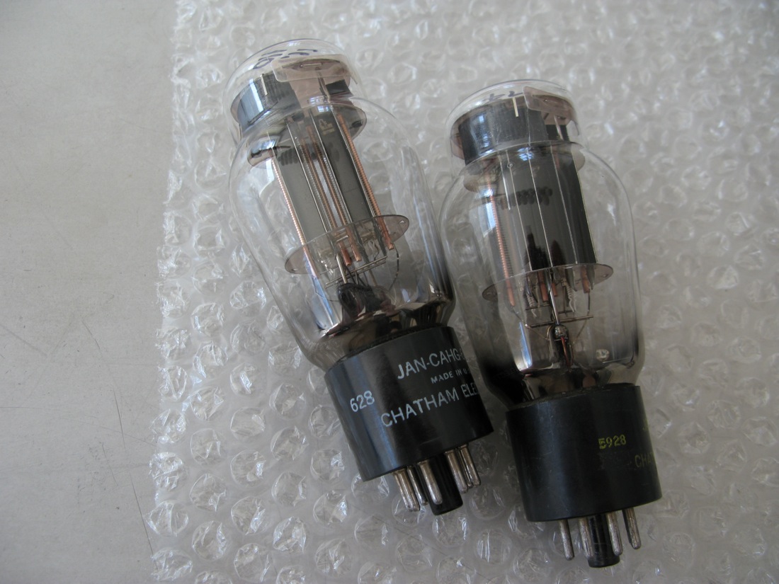

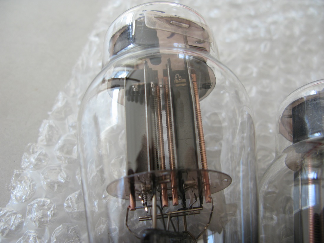

Time for some Mu tube rolling 🙂 I have used the Russian version of the 6AS7 (a bit warm sounding), but most of the time I have used the Cunningham 6AS7 (a bit leaner than the Russian and more open sounding).
I have been trying to get a idea about what is considered the good sounding 6AS7, and as usual the one that are considered ''best'' are the very rare and expensive ones. I can't help but think, that because these nos tubes are considered so good is -partly- because they are so exotic... When reading comments on the Internet I noticed that many consider Chatham Electronics 6AS7 amongst the good sounding ones, and they are reasonably prices. Apparently Chatham Electronics was acquired by Tung-Sol, so later on these tubes was named; Chatham / Tung-Sol.
I have bought a nice pair of Chatham Electronics 6AS7 and it will be interesting to hear, if they make any difference in sound. Beautiful tubes with their copper posts..!!!
The 2399 can sometimes be substituted in a 6AS7 circuit. Here are a few other tubes that might be considered.
