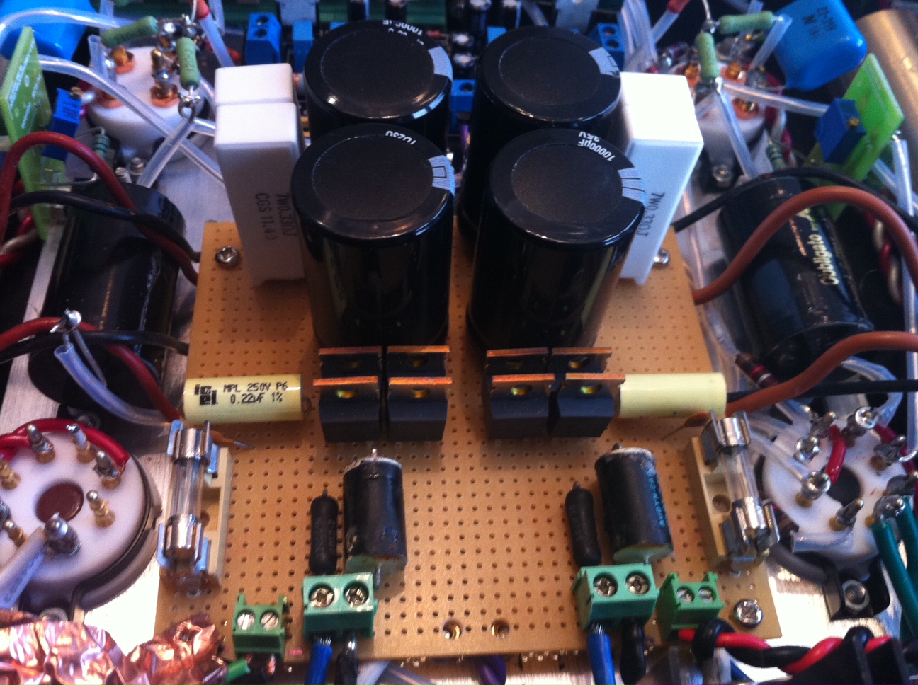

Hi, has anoyone tried to move the Tram output voltage divider (the relevant part of the resistor network at the output RCAs) to the input of your power amplifier.
My belief is that this would lower the Tram's output (DC) impedance so that the capacitance of the following RCA signal cable to the poweramp does not shape the tonal balance. Please protest if I've got it wrong.
I find that I only use the -12dB output of the Tram and it should be easy to move these four resistors in total to the poweramp input.
I've heard that SET tubes might get broken if they do not see any load (might only be applicable for poweramps with transformer on output). The Tram is decoupled with output capacitors so my belief is that the removal of an output load at the RCA outputs should not hurt the preamp.
Any knowledge on this?
Geir 🙂
Geir 🙂

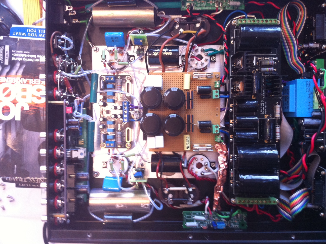

Yess, finally installed the the Rod Colemans heaters too.
First impressions:
1. Lower noise floor
2. Increased transparency
3. Expanded soundstage
4. Somewhat drier base/lower mids
The drier sound might well also be due to some exchange of the output resistors.
Overall, well worth the work.
Thank you Rod for offering this technical advance :-D
Geir

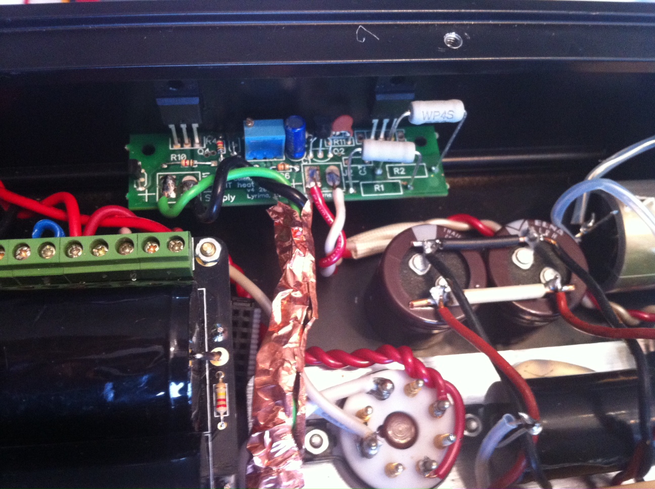

An update on the above post;
The sound is even better today. Yesterday I could only get the heater voltages up to 2.4V but today managed to get exactly 2.5V on the heater voltages by fiddling (reducing) the resistor values on the Colemans heaters out. Also swapped back to my old resistors (Dale) on the pre outlet.
The dryness in the sound is gone now and it is all music :-D
Thanks Geir, Pleased to hear that you like them!
The Current-Sense resistors do need some running-in time, and probably the same for the capacitor C3. These are also the parts that Morten and Bjarne have switched to more exotic parts, to good effect. It should be worth trying them on any Tram with the Filament Regulator upgrade.
Thanks Rod, I'll already contacted Morten earlier to get info on the suppliers in northern Europe of these parts.
Currently my current 🙂 sense resistance inserted is very low as I had to put some 1 Ohm and 2,2 Ohm resistors in parallel with the resistors supplies in your kit. Is there any danger that too much current is flowing then?
The heat of the regulators are OK since I simply glued them onto the chassis.
Geir
Geir
Hi Geir, it's OK provided the dc input voltage does not vary too much.
If the current range is a little too low, increasing the supply voltage slightly will be effective in increasing the range slightly. A lower value for the resistor (between C1 & C2 in the raw supply) will allow this.
This method will probably give better sound.
Setting the filament voltage within the range 2,44V .. 2,50V (measured at the socket) will be good in all cases.
Thanks Rod,
then I'll rather reduce the resistor values in the power supply than the filament heater resistors.
I'll listen for any 50 Hz coming through the DC supply. Currently it's more silent than ever for this pre.
Thank you again for your support.
Geir 🙂
Geir 🙂

@Geir... Could you show pictures of your implementation of the Rod Coleman regulators? It's good to share our experiences and the solutions we make (I believe)... Also: The dry sound you describe is not something I have heard with these regulators, but it appears that it's gone now so all must be good...
@ptashton... Thanks for the tube info. When I bought the Tram I was reading all I could find on all kinds of NOS 45's and 2A3's, from what I was reading the 45's should -generally speaking- be the better tubes. However, of all the tubes I have now tried in the Tram I find the 2A3's superior sounding. In the beginning I also thought that NOS tubes would sound better than new production tubes, and I have bought my share of NOS tubes for the Tram. No I have stopped rolling tubes because the best tubes I have heard for the Tram are the ones I use now... And hey, they are current production tubes, and from China 🙂 Hearing is believing 🙂

And the sound is not "dry" anymore. the shift in tonal balance was due to a too low heater voltage at a time before I manged to raise the voltage by reducing the resistance.
As I've been surfing away at Ipanema, I still have to adjust/reduce the resistance in the power supply so to give a higher supply voltage for the Colemans regulators.

Hi Geir,
It sounds like you've been having a great time!
2 things...
1) how are the transistors attached to the chassis. I don't see any bolts.
2) you should be ok to remove the capacitors across the heater socket pins.
I like the apporach of using the chassis as the heatsink, it frees up a lot of space for the power supply filter section.
