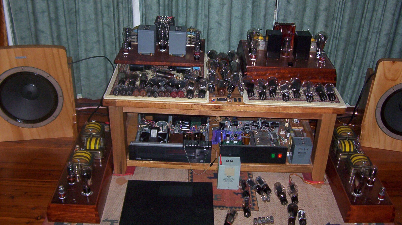

Morten, the journey to audio heaven sounds like it is over. There will be lots of unwanted Tram2 tubes on ebay from this. One way to recoup for the cost of the Full Music tubes. All the best
Peter
Peter
I'm not buying more 45's or 2A3's for sure 😉 So I a bunch of tubes collecting dust... I have a pair of EH 2A3 (cheap ones just to get started). Two pairs of NOS RCA 2A3. The Treasure 2A3 and a pair of NOS Sylvania 45's.
The NOS RCA 2A3 might be the ones that come closest to the Full Music 2A3/SE. The have some of the same sonic footprint, or maybe I should say some of the same LACK of sonic footprint. They do not sound as good though, and what has kept me from using them more is, that there are all kinds of problems with them: With one pair there is hum, I could reduce this by making shielded tubes / housings for the tubes, but I don't want that. The second pair is extremely microphonic. Too bad because they sound quite good, but ultimately they are not for preamp use (IMHO). For a power amp I'm sure that they will work much better...
Anyway, with the Full Music 2A3/SE there is no need to consider tubes for a while 🙂 And with the soft start of the heaters from the Rod Coleman regulators and the intelligent start up from the autobias module in the Tram II tube life should be up to 2000 - 5000 hours for a pair of these tubes, so the investment is not too bad - per hour.
I will play a bit with rectifiers and mu tubes again. For now I use NOS RCA rectifier and a NOS Cunningham 6AS7. This combination is the most transparent and clean sounding of the tubes I have. The NOS Svetlana rectifiers and mu tubes I have are a bit fuller and warmer sounding. I will try these together with the 2A3/SE soon...
