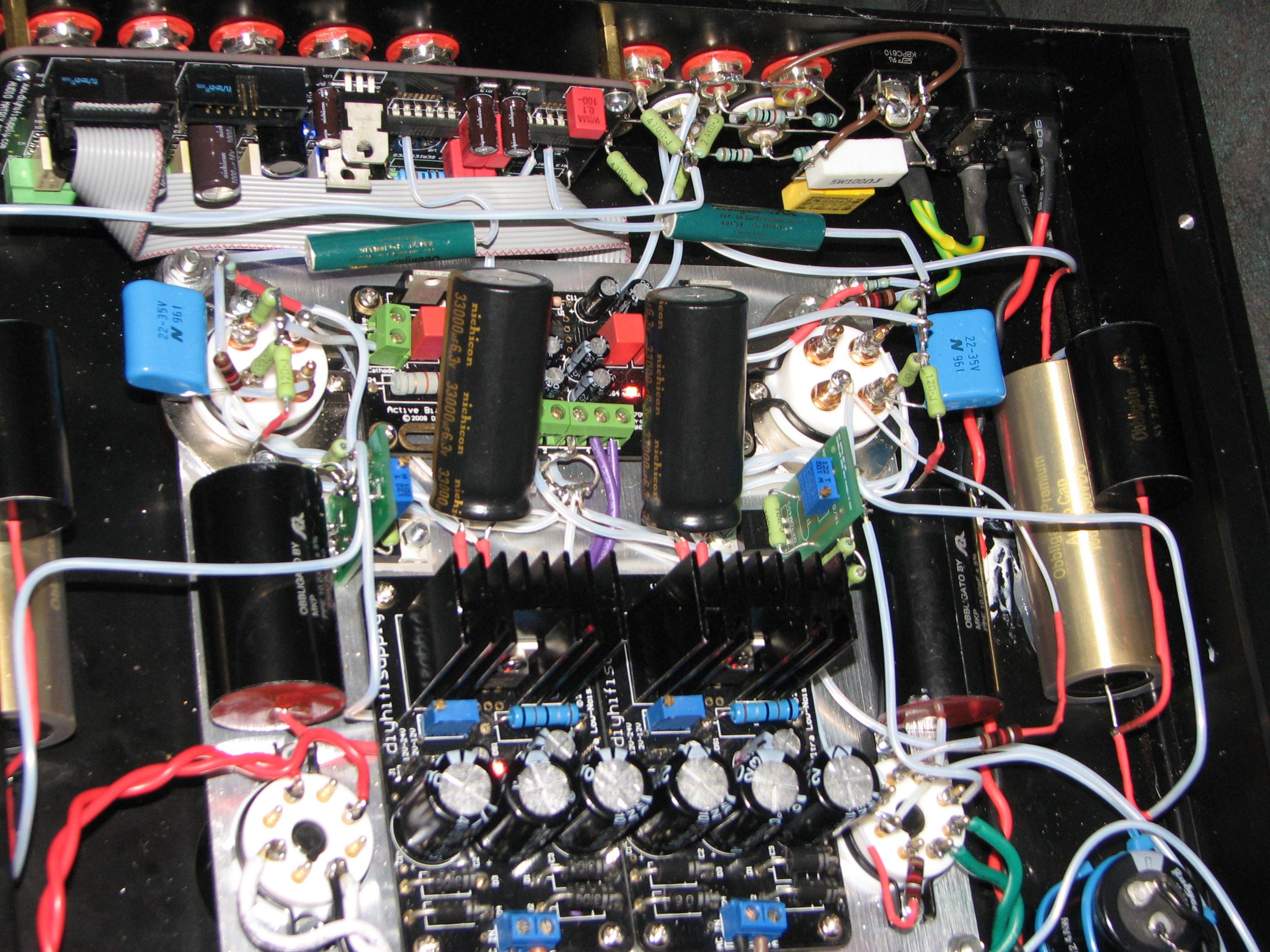

I've finally commenced building my TramII kit. In the building of the PCB for the CCS'es I'm a bit puzzled about one of the resistor values. According to the schematics there shall be a 10 Ohm resistor on the reverse side of the potmeter. On the PCB itself a 1R value is printed at this location. However, in the package containing the CSS bits the only risistor value in the ballpark is 33 Ohm. Do anyone know if evolution has shown this to be a better value? I plan to run 45 DHTs first (for testing) and then swap to 2A3's after re-adjustments.

Geir, I used the 10 ohm resistors supplied in the kit. See the Tram2 picture on the right hand side of the picture for the CCS 10 ohm value. You can just see the resistor value. I am using the Full Music 45 ST plated tubes. I have purchased the Rod Coleman Regulators. Desmo is the guru/master of mods for the Tram2. Have a look at his threads.

Thank you for replying Ptashton.
I will then buy some power resistant 10 Ohms resistors then or temporarily run soem regular resistirs in parallell to give the correct value and take some heat.
Thank you also for the very detailed photo where I can study a feasible layout of the resistor arrangement at the DHTs.
