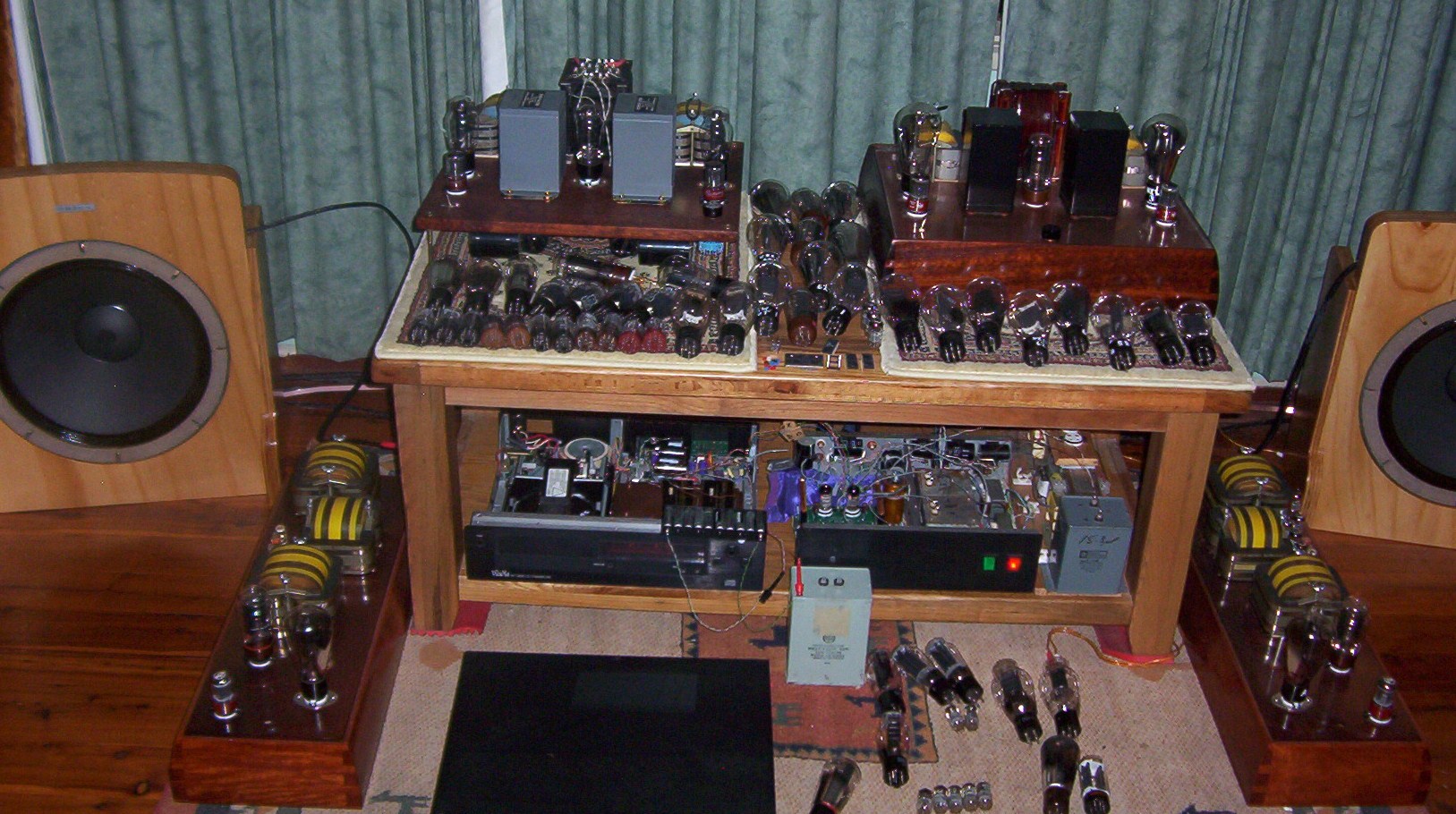

WOW those SE amps look insane..! Very Interesting DIY project for sure...! This is my system...

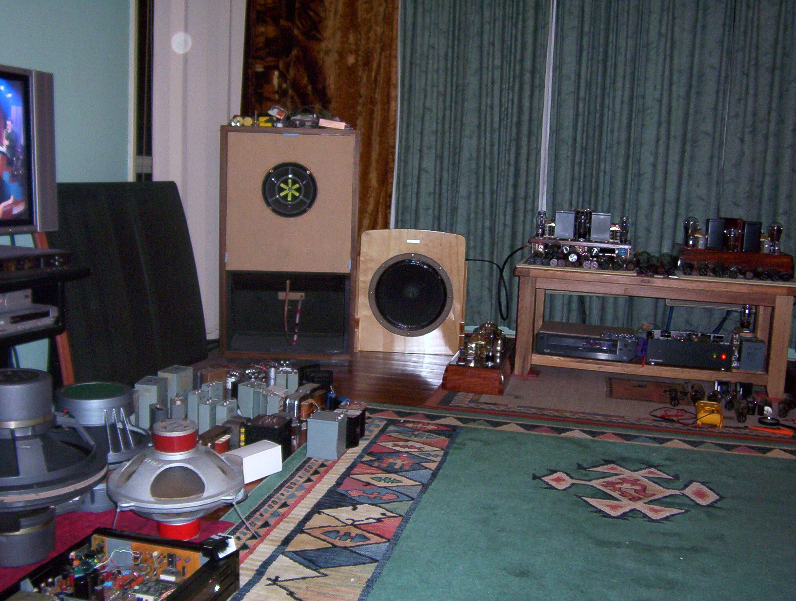

Morten, your speakers review on the net sound really good, I should say fantastic. They would not have been cheap to buy. What are the two white coloured components under the DIYHIFI Supply Tram2 and Vinyl Song Phono units. I see you are using a Plinius New Zealand Reference Amplifier. It must run hot.
The two white sculptures under his Tram are Densen components. Scandinavian minimalist design at its best ;-D.
Geir is right 🙂 The two silver boxes is my Densen B-475 cd player. The power supply is in one box, and the rest in the other box.
And yes, the amp is from your part of the world, it's a Plinius SA-Reference. It does run hot in the high bias mode where the first 100W of the 300W is Class A, but it also has a low bias mode and I use that a lot during the summer time. The amp does not run as hot as the Atma-Sphere MA-2 Mk III.1 monoblocks that I will soon get home for review 😉

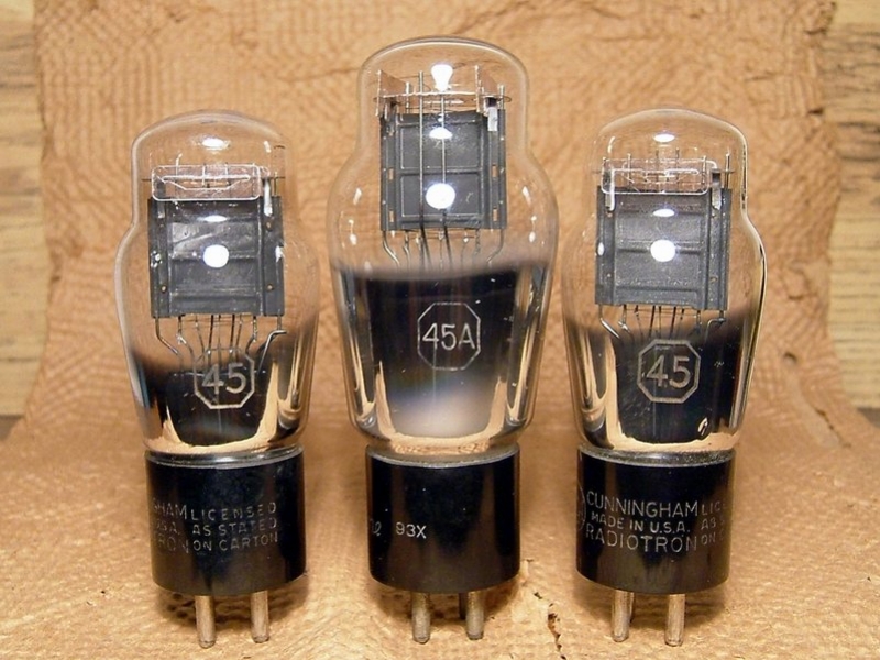

See attached picture.
45s are specified for use in the Tram 2... I'm unfamiliar with the 45A and haven't checked to see what might be possible.
Gym, have a look at this web site. 45A, Tube 45A; Röhre 45A ID20526, Triode, vacuum They indicate the 45A is an alternate/identical to the 45. Food for thought.
