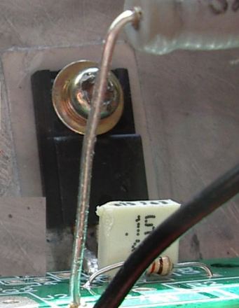

Ive been looking at installing the Rod Coleman Regulators so here's some ideas I hope might help you a little with your installation designing:
Rod Coleman recommends using the chassis side wall as the heat sink as per the photo below and writes:
"If the chassis is made from 3mm thick
Aluminium, or thicker, and exposed to he outside air, the performance will be excellent. To test this claim, a regulator was set up to supply ... filaments running 3.3A, mounted on some scrap 3mm Aluminium, 275mm x 100mm ..... The high power heater can operate with this heatsink indefinitely, and only reach about 45 deg C.....
Temperature Effect. You will notice that the current falls back a little after 5 - 20 minutes. This is because of the temperature coefficients in the transistor junctions, and the sense resistor. Use better heatsinking if you wish to minimise the difference between cold turn-ON current & steady-state level."
I think the design rationale in using the chassis side wall as the heat sink for the Regulators is brilliant as
a. its simple
b. it will tend to transmit heat out of the case compared to mounting heat sinks under the tubes
c. it might minimise any stray electrical fields from affecting the tubes/wires and thus aid in keeping the noise floor lower?
I wonder if this installation into the Tram2 chassis can be optimised via:
a. removing the epoxy paint on the chassis inner side wall to achieve a smooth raw aluminium exposed surface to maximise heat conduction transfer
Either mounting the transistors using heat conducting tape
OR better still: screwing the transistors into the side wall if you have a deft touch so as not drill though the chassis (perhaps wind tape around the drill to build up a 2mm wide collar allowing a safe drill depth 1mm shorter then the case thickness).
Use a copper shim for best heat transfer between the transistor and chassis and plenty of Thermal conducting CPU paste between all surfaces.
b. sticking heat insulation tape to the inner chassis wall adjacent to the transistor mounting; with the aim of minimising heat transmission back inside the case
c. optionally sticking heat sink fins on the outside of the case (if you don't like the look or they don't drop temperature appreciably just pull them off)
4. Put aluminium shielding on the inner side of the regulators to minimise stray electrical fields and further minimise radiant heat transfer - the fins of that linked heatsink will need to be flattened back with a hammer leaving just the top fins as a mounting base to the underside of the top plate. The inner vertical surface should have the thermal-electrical insulation tape glued to it.
Please let me know if any of this is mistaken? I haven't actually tried it and I am just a beginner. :eek:
