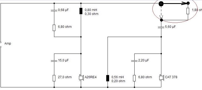

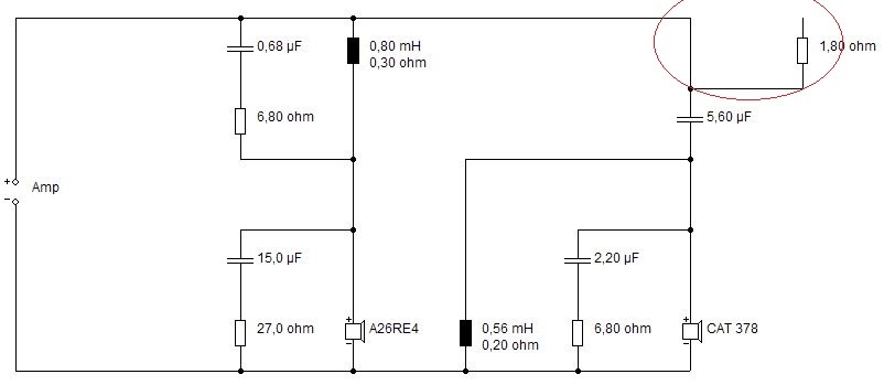

Yes, one's just tweeter 1st order and another more 'proper'
Two options to choose which one you like more

That resistor is an attenuator I think for the tweeter level and optional I think
It says at least optional in Italian in the bom

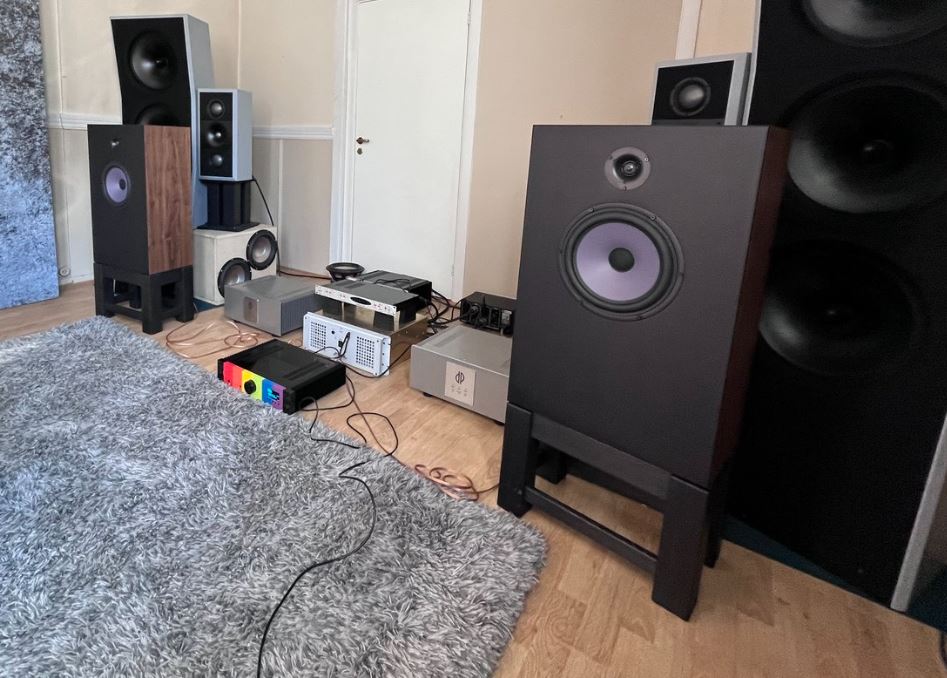

Our "Divorced" received many acclaims at the Horten 23 HiFi show DIY-apt. The XO is none of the above mentioned, my own spin-off.
An American couple where the wife is a musician stated that this was the system she thought sounded best on the show.
Others liked the big powerful system better, no surprise 🙂
The larger system are all Bliesma BE domes in MTM together with AE bass-tower and SEAS ROY x 4 subs. An awesome system indeed (not mine).
