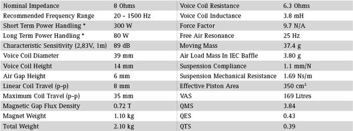

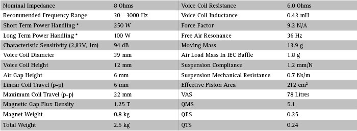

I have tested the A26 and found the Seas W26FX002 has similar performance but with a stronger magnet and is more damped so handles more bass without going all floppy...
W26 is not fantastic for bass, but sounds cleaner than most other subwoofer drivers and I can use it with 2nd order filters because it just sounds so nice. Doubling up soon.

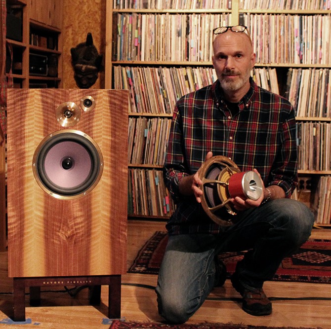

I have heard them, and met John DeVore at THE Show some years ago (when he still had hair). They sound...just...excellent. Excellently musical.I was interested in the orangutan design for a bit. The truth of the matter is that you will get better sound from a nice 8" crossed to a waveguided tweeter. Or two 6" in mtm.

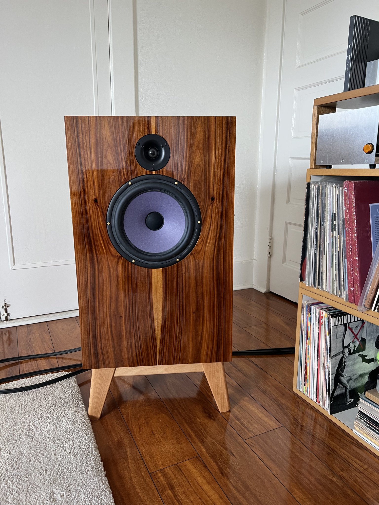

I posted in the other “Seas A26 Devore Style Build” thread, but thought I would cross post here because of the earlier cross-over discussion contained in this thread.
I finished a build using 24mm Baltic Birch. Cabinet measures 28.75” H X 18” W X 12” D (730 X 457 X 305mm) with two ports 2.375” (60mm) diameter by 5” long (127mm) for an FB of ~38Hz.
As per the Devore, there is no cabinet bracing, and I used minimal damping. I only used a single piece of 2” thick rigid fiberglass insulation 16” X 21” at the back of the cabinet. This seems roughly sufficient. I stuck my face in the woofer hole and spoke a few words into the empty cabinet, and heard no boxiness. I think think some amount of lively cabinet is part of the recipe.
As for crossover, I just tried Dualuxe’s earlier posted version with a 2.7R - 15R L-pad and 3.9uF cap on the tweeter. Woofer runs full range. (That is to say, there is no filter on the woofer.)
I will eventually try one of the other crossover suggestions, but even with this ultra simple crossover, I have just about what I was hoping to get. Very clear, good dynamics and ample bass.
A little rose-colored? Sure. But having heard the Devore’s, this is what I was hoping for. They make good recordings sound excellent, and bad recordings sound “interesting.”

Ha ha! Yes! That was unintentional, but does help to diminish their size in the room somewhat.
It was my very first attempt at veneering, despite doing lots of woodworking over the decades. I never wanted to invest in a vacuum set-up or build a veneer press.
It is a non-backed rosewood. I used the iron-on method, and it worked fairly okay. I got some cracking/splitting with the heat, but it seems securely attached.
