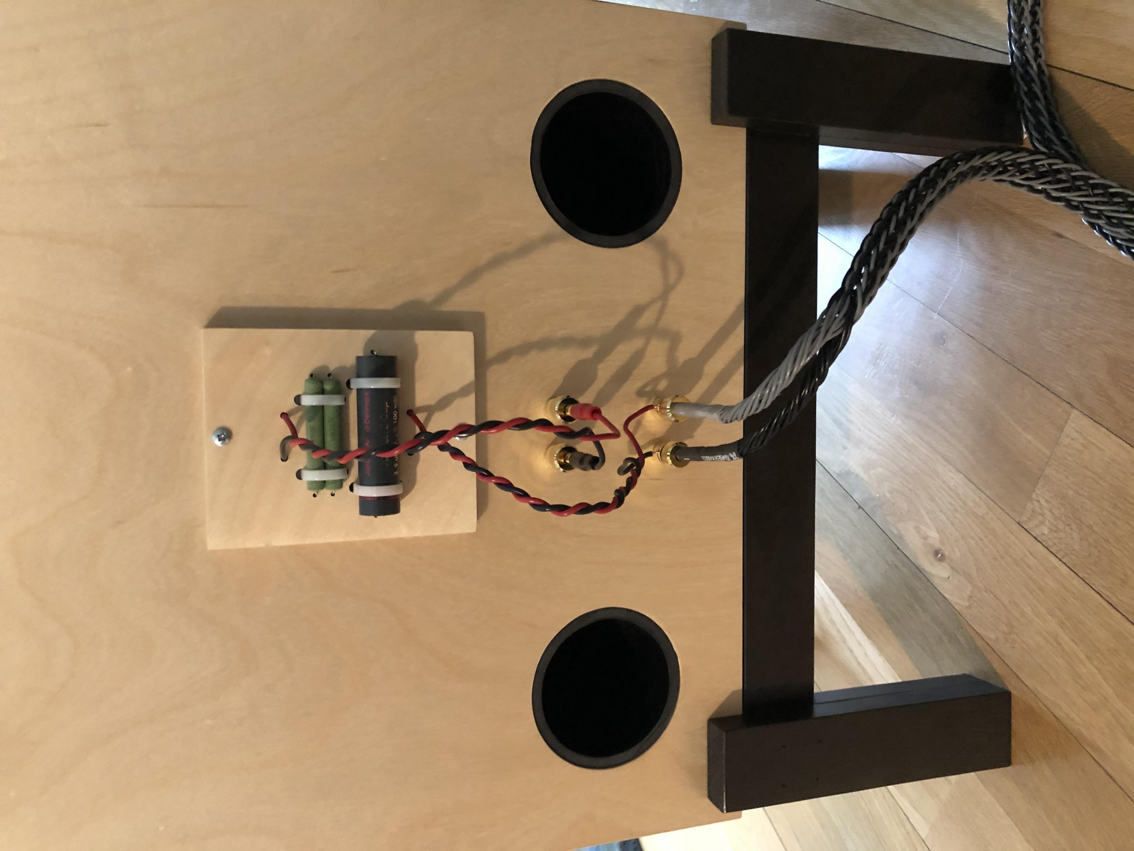

So I finally got around to prototyping this speaker and wanted to share my results with the DIY crowd here. A few photos are attached.
What I ended up with is the result of a lot of crossover and port length experimentation and listening. I am very pleased with the outcome and will eventually get around to building a new cabinet in a Devore style with some special veneer and a base made from hardwood.
Drivers are the Seas A26RE woofer and Morel CAT378 tweeter. They are individually wired to terminals on the back baffle so I could experiment with the crossover without opening the cabinet.
The crossover is a first order high pass on the tweeter with a 3.9 uF cap and an L-pad attenuation of R1 = 2.7 ohm and R2 = 15 ohm. I also experimented with a second order high pass but found the first order and a relatively higher crossover frequency sounded better.
The prototype cabinet is built from 19mm baltic birch plywood and measures 18"W x 29"H x 11.5"D. Since this is just a prototype, I finished the baltic birch with a few coats of satin lacquer.
I used a piece of 1x3 poplar as a brace between the front and back baffles about 3" beneath the woofer. On the back baffle directly behind the woofer is a 1" thick 6 pound fiberglass panel measuring about 14" square to reduce reflections back through the woofer. The remainder of the back baffle and the top, bottom and side walls are covered with 1.5 pound pink fiberglass. The dual ports are 3" ABS pipe 7.5" long.
The prototype base is made from poplar and measures about 7.5" high in the front. You will see in the photos that the front legs are arranged to tilt the cabinet back by about 3 degrees. This points the acoustic center of the woofer/tweeter directly at my listing position about 13' away.
do you have a lowpass on the woofer or you run the woofer without any xo?
Nothing on the woofer.

I hate to bump this older thread, but on post #83, what is that 1.8ohm resistor in the upper right all about?
