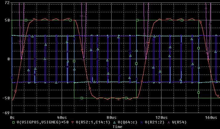

Couldn't Help it..
Just a few a bit of junk I thought I'd share..
Earlier today I saw Jan-Peter mention having seen a 10khz square wave put through a UCD and I thought.. Neat! I wonder..
Here we have it, 1 volt input 10khz square wave.
Spice impressed me today.

Jan-Peter, thanks for letting me know it's on par with the real deal.
