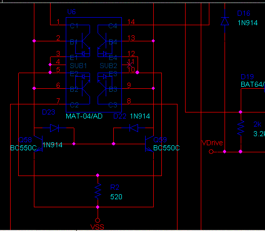

I must've been sleeping while posting! I actually *do* use emitter resistors in the bottom transistors (the ones with their bases tied together)
The reason why I forgot that is simply that their function was not related to balancing and their presence is not required for proper operation. The balancing problem you're seeing is related to the other two which are seeing vastly different power dissipation.
The emitter resistors were added to prevent the bottom transistors from becoming a contributing factor to noise.

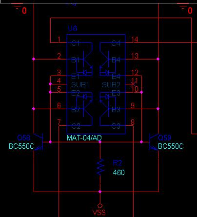

Well, now I completely lost – guess that’s what happens when you try to second-guess a problem – where exactly is the problem with “Balance / current hogging”?
John
John
I second that.
Balance problem? Perhaps the output pairs would differ in power dissipation but, from one side of the comparator to the other, that would be alternating would it not, therefor not much of a concern?
My current hogging concern is that of the quad outputs, having one transistor in each pair possibly hog the current from the other, resulting in one, or both, of the half bridges no longer being able to switch properly.
I think you're right John, it does only need two emitter resistors..
So with that in mind, why opt for a three part solution, which thus far has escaped me, and likely will continue to.
I thought before the monolithic IC would be enough to guard against such hogging, apparently it isn't, but with two resistors, it should be safe enough.
I'll likely never get to build this myself but hopefully some will and I would like it to work OK for them, otherwise just for a simulation I wouldn't worry about it at all.
I second that.
Well you've got the two trannies driving the current balance by their emitters and the mosfet drivers by their collectors. The one driving the high side is getting hot, upsetting the balance.JohnW said:where exactly is the problem with “Balance / current hogging”?
Point is to keep that from happening. Using a monolithic matched pair (or quad in the case of a FB) is one solution, but not the most elegant one.
The emitter resistors I have are in the bottom pair (the "balance"), and are not related to the current hogging problem.
Well, I have a feeling I'll catch some hell for this .... so be it.
This is a slight modification to my earlier idea that I mistakingly thought worked (ZZzzZzZzz...). This does work.
I trust it should completely solve any current hogging issues whatsoever. That's 2 parts.
For a third.. and maybe a fourth, I may consider some sort of mirror/level shifter, to unload the full swing and balance issue from the upper drivers, haven't really put much thought into that one yet though.
I trust doing so would allow the upper and lower drivers to operate at the same temperature, thereby also helping with any hogging related issues.
So, have I barked up the wrong tree here or what?
Chris
Chris
You could start from the idea of post #410 and give "the second output pair" their own common emitter resistor (ie not tie the emitters to the balance).
Yeah, that's likely where I'll finish with it too. I guess you don't like the outputs being removed from the mirror..
