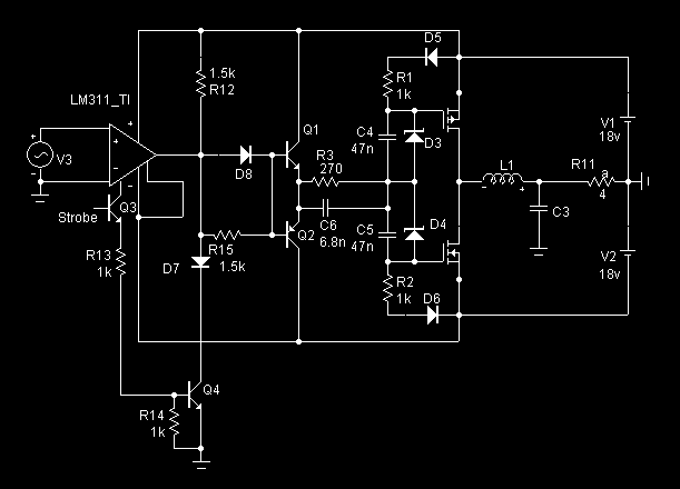

I made something like that as short circuit protection, if i understand your explanation good (but not with fets but npn and pnp).
I had between a power supply rail and a fet a sense resistor.
Over this resistor was a npn placed (base and emittor).
When this npn was activated (thanks to voltage drop over the resistor at overcurrent), it activated on his turn a pnp which pulled the voltage on the cap of the astable multivibrator to ground, so that the oscilation process was disturbed.
Then i tried to use the same principle (pulling down the voltage on the cap), to act as a mute but the result was a huge pop, even worse than the pop when i startup and shutdown the amp.
So instead of pulling to ground i tried pulling to 5V.
This gave a smaller pop but still unacceptable, or am i just very demanding?
Can you give a bit more information about how i can use your circuit to avoid "start and stop popping"?
You know, you all are probably very experienced engineers, i'm just a student who still has to learn muuuuuch 🙂
Maybe i'm wrong, but after all, the intention to avoid popping is to make sure that the comparator is "disabled" during startup and shutdown of the powersupply, isn't it?
IMHO, pulling down the strobe pin gives you maximal DC on output, of course, if am i correctly imagine your driver.
Anybody with the same opinion? I have no idea about that 🙁
Maybe i can test it when i make a little circuit with the lm311 and then activate the strobe pin, something like an astable multivibrator with 3 resistors and 1 cap, and then measure the output when the strobe is activated.

I may be off base here, but how about coming from somewhat the other direction and insure that the all the low voltage circuitry is up and running at 50% duty cycle before powering the output stage? Just a thought.
el burto said:Hello
Now you know, there is no discrete comparator in soda.
Thats why i wanna ask, can i use the "strobe" pin on the LM311 to solve the problem?
I thought so because the datasheet told me that u can disable the output with the strobe pin.
So can i avoid a squeak and a pop with using the strobe pin? And if someone maybe knows how, can you tell it?
What you people think about this?
A little picture of the "strobe configuration" in the next datasheet on the first page:
http://cache.national.com/ds/LM/LM111.pdf
That's a good thought to be certain, but in this circuit oscillation is caused from the feedback which is taken after the bridge so I don't think that would be possible. Seems Bruno wasn't kidding when he said it was "tricky". I'm not even sure if the "mute" idea would stop the mentioned squeek & pop, since the most that would do is provide the 50% duty cycle, I don't think you can actually disable the bridge though. Might have to live with the squeek /pop. I don't know.
It is interesting though. The only way I can think of is an output relay to disconnect the load.
Then again, this might be good cause to ditch that output stage and go with a dual N channel + good driver IC with it's own disable! Problem solved.
I wonder if it would be possible to add an N channel active pull down "mute" on the actual output, instead of a relay, could that work?
It may be possible to shunt the output to ground for a few milliseconds by connecting two mosfets back to back and then use an optocoupler to provide gate enhancement of both gates wrt sources for a short time. Hopefully the output choke would protect the switching MOSFETS from the current surge for long enough.
Or alternately, and maybe better, use the back to back MOSFETS as a solid state relay. Then the gates could be enhanced after the initial circuit start-up. They could then be enlisted in the double-duty of providing speaker protection in case of circuit malfunction. Also this way, the gate power supply would not have to be supplied to the MOSFETS prior to circuit start-up. I wonder if a standard solid state relay would work even better, though they respond slower, since they may not need an internal floating gate power supply given that they may be gate-enhanced by internal photocells. The solid state relay would maybe work better in the above case, too.

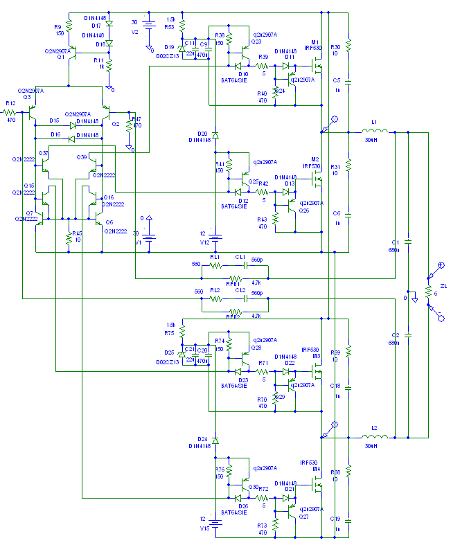

Chris and I have been doing some off-line collaboration to figure out how to do a full-bridge output with the UcD circuit.
One obvious alternative is to build two complete UcD single-ended circuits, and then connect them in a bridge configuration (invert the input on one of them if you don't have a balanced signal source), and add the small capacitor between the outputs to make them align their oscillation frequencies as Bruno suggested.
The other alternative, which could save some components and space, is the circuit I'm attaching here. Credit goes to Chris for figuring out how to make quadruple outputs from the comparator.
We have one question about this scheme though; it didn't work well in the simulation until we lowered the value of the common base resistor to Vss in the comparator to a very low value (R45=10 ohms in my schematic). There might be an issue with sharing the bias current through the comparator between two output transistors simultaneously? Do we run the risk of current-hogging in real life with this type of configuration?

Hi everyone!
Attached is a draft of a differential full-bridge UcD circuit with LAG-filters. Note that no component values are filled in yet, so you will have to compare this with the circuits we have been discussing here previously. You need Eagle 4.11 or later to review the files.
Of course, one doesn't have to build the full bridge; I could make a stripped down version later when the function of this full version has been verified.
There are only a few air-wires needed, for the comparator-to-driver signals, and for the feedback from the output-via-filters to the inputs.
Power supply voltages and ground are intended to be connected separately to the "modulator part" and the "driver+output" parts. Also, one can choose to have voltage-regulators on-board for the supply to the OP-amp, or one could have such regulation in the central power supply.
Please help me review this, in particular a sanity check of the schematic versus previously discussed simulated/prototyped circuits would be great. (No point in building something that can't work at all 🙂)
Don't hesitate to ask if anything is unclear.
Furthermore, I think I have come up with a tentative "home" for this project - on the diyaudio.com WIKI! Check out this UcD-clone-page 😎.
