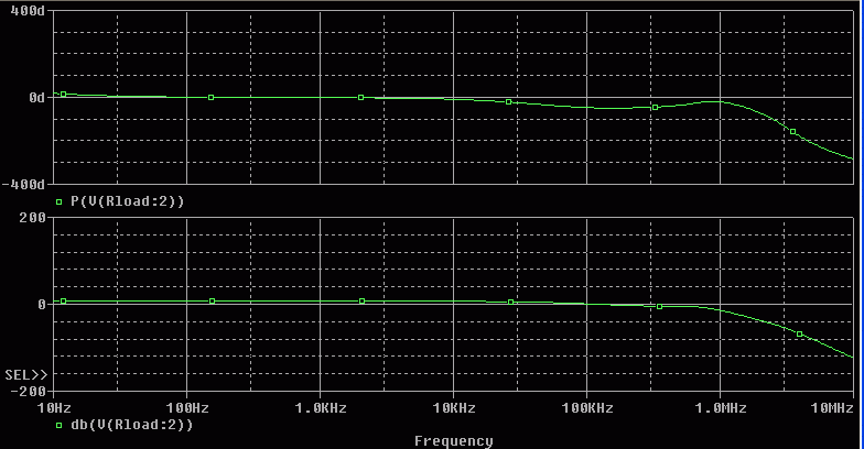

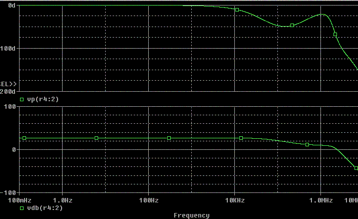

Honestly, right now I'm lost with Bode plots. It's not looking at all like I think it should, though I could be wrong.
In a non inverting type, to the patent design, phase is starting at 180 degrees, doesn't reverse until 800 or 900khz!, and gain is negative? Gain looks normal if divided by the input, but it should be doing that anyway. Can someone help me make sense of this please?
Chris
Can anyone comment on the above? Otherwise I'm giving up on it. Value changes in the feedback network do nothing to the gain/phase, gain is showing as negative yet isn't possible, when it produces +50W at 1 volt input, gain can't be negative, and why is the phase starting at 180 deg, when it isn't in an inverting configuration.
I've loaded one of my first schematics and did the same, its' an identical circuit with different parts. Gain showed up properly, but the rest is still the same, looks like it should be oscillating at 900Khz. I've tried every Bode graphing option I found for orcad and all results look the same, even with taking it from within the feedback loop, out of desperation.
Is it correct and I'm simply looking at it wrong? Seriously it's got me lost, which isn't good since that's the heart of this amplifier.
Hi Chris,
I can't help you much to make heads or tails of your strange bode plots. Attached is what I got out of an AC analysis on the ucd_js2 circuit which I posted a while ago. It should be equivalent to yours I believe. My plot looks "sane", but I wouldn't trust it too much since it deviates somewhat from the theoretical curve I got by analysing the filter equations with gnuplot eariler....
Regards / Johan.
Regards / Johan.
Hi Chris,
your schematic will not work for AC analysis. You might take a look at the Distortions in class D thread, or google for average switching stage model, state space averaging, Middlebrook and Cuk articles, Ray Ridley models and articles, Intusoft newsletters,
Unitrode design seminars, etc. You will find enough information about AC modelling of switch mode power supplies that can be directly applicable to class D amplifiers. When I will have some more time I will try to post some links or even some averaged spice models.
Best regards,
Jaka Racman
Best regards,
Jaka Racman

This isn't the circuit, just a bode plot of my first working sim of a UCD. You can see it looks nothing at all like the last I posted, it looks exactly like what Johan posted, and makes alot more sense, even though it's wrong also. Sometimes it's good to question the old software but I still have a tendency to question myself first, always will.
The curious thing is simulating your Js2 Johan, the results dont' look like these, but like the previous ones I posted. I can't even pretend to understand what's going on with it
Suffit it to say Jaka Racman was more than right, it can't be done, not with this kind of a setup anyway. What a shame, but I'm happy to know the fault isn't my own, whatever it is.

Hi Chris,
to get meaningful Bode plots from shematic that is suitable for transient analysis must be purely coincidental. Spice normaly determines DC operating point of the circut and then applies small signal AC analysis around this point. In shematic like yours this would almost inevitably be with one mosfet fully on and another one off.
I was looking for Unitrode app note that actually shows how to derive averaged spice models, but I could not find it. But this link and this link might show you what was I thinking about. If you find model for synchronous buck converer, you will be fine. (synchronous buck converter is SMPS talk for class D halfbridge output stage.)
Best regards,
Jaka Racman
Best regards,
Jaka Racman
