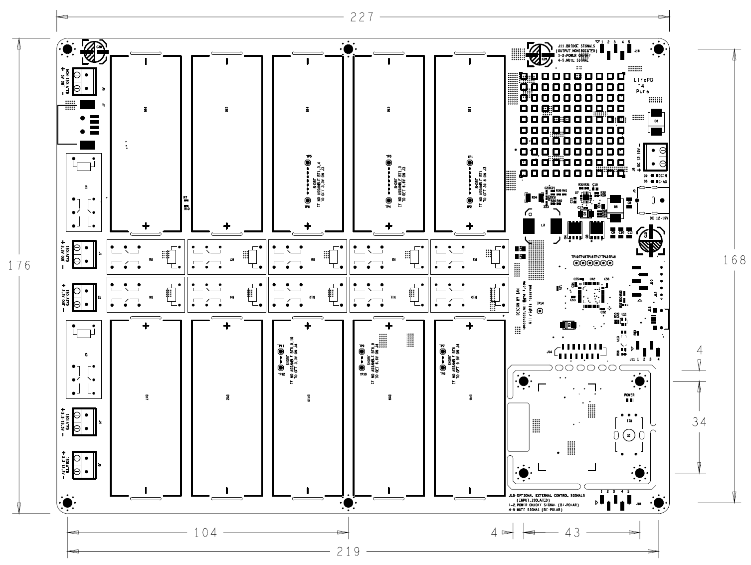

LifePO4 power supply PCB layout and dimensions
LifePO4PowerSupplyDimensions by Ian, on Flickr
Ian
