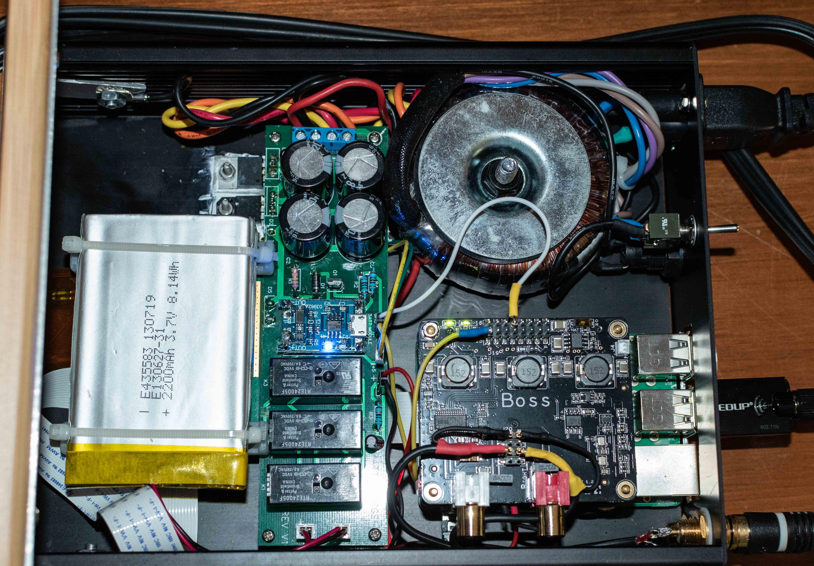

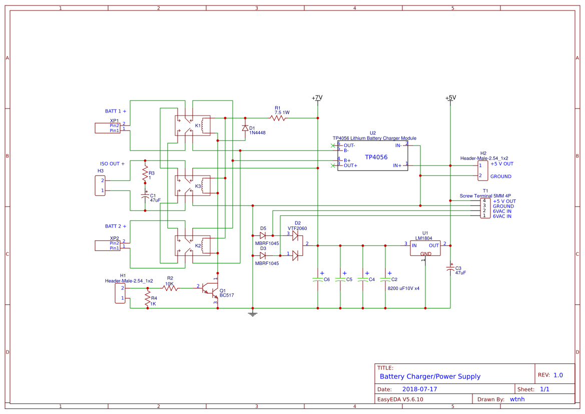

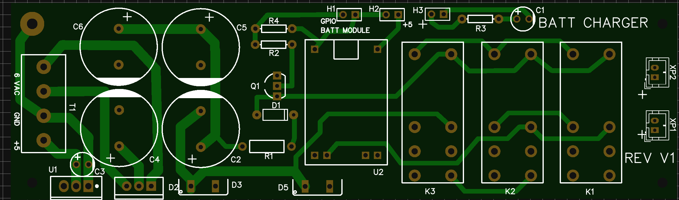

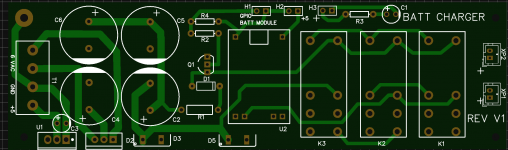

Hi Ian - I am looking forward to your progress on this. Just as a reference, I built a quick and dirty LiPO supply for my Allo isolator and Boss DAC. The Raspberry Pi is powered by a 5 volt linear supply (which also powers the battery charging module). 2 relays are used to switch the LiPOs between parallel for charging and series for powering the isolator. A third relay switches the power out to the isolator between battery and unregulated power, so that the isolator and DAC are totally galvanically isolated from the Pi.
The relays are controlled by a GPIO pin which goes high when the player is active (it is running PiCorePlayer). When the player is quiescent, the batteries are switched into charge mode. This works well enough so that the batteries always have enough charge for extended listening.
This is pretty simplistic, so for my next project, I would like to implement your idea.
Pictures (one is the custom PCB I made for this) and schematic attached for anyone who wants to duplicate.
Regards
Whit

Using batteries as a capacitor replacement is easy and gives excellent results. But unlike Ian's project it does not provide a galvanic or noise isolation. Combining batteries with supercaps, otoh...not sure what that achieves.
Galvanic isolation can still be had. I'm currently using 7.2v Nicad batteries to power the 5V regulator circuits.
I'm just curious as to what LifePO4 batteries or super caps add to the equation that regulators don't.
If you slap relays in between them you are going to add a lot of HF inductance between the supply and ground. Plus what little information I could find about LifePO4 and super cap impedance at RF was not very useful.
Nicads have pretty low power density and limited charge/discharge life cycles. Not sure what the noise factor is, but you should consider lithium chemistry.
Cheers
Whit
Yeah I know, couldn't find any lithium battery packs in the right voltage so I went for some Nicad RC batteries on ebay. They are post regulated twice so noise is irrelevant.
