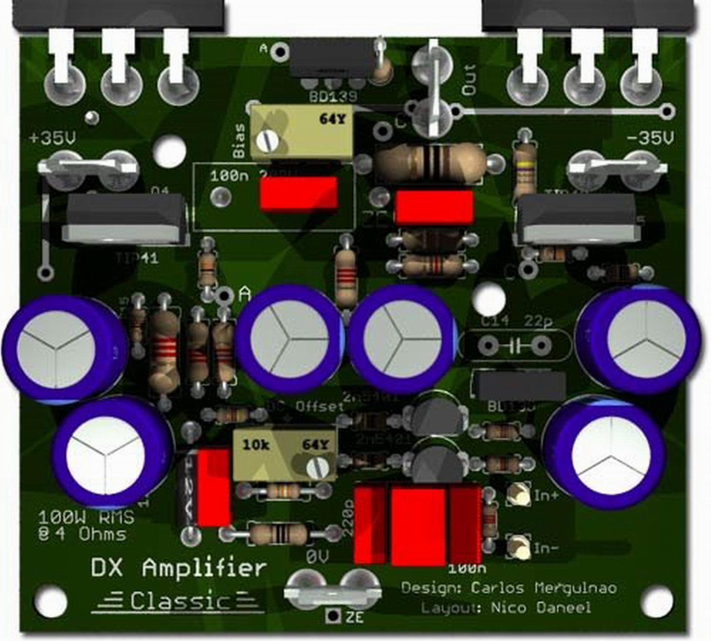

Any power transistor able to face 100 volts or more from colector to emitter will fit
Also you need power transistors that can hold 5 amperes of current or more.
If not fake ones you will not face any trouble with output transistors, unless misuse, small heatsink, shorts in the output, reactive loads, too much low impedance or injecting full power square waves that generates harmonics and also drive transistor to full conduction of the supply current.
Only errors will damage your amplifier.... if operate correctly with the suggested supply voltage and suggested speaker impedance you will not experience failures as this unit was deeply tested and tortured along several years...and i could not destroy output transistors...so, the amplifier is very safe and reliable... doing correct things you can select any power transistor you find, modern or or old ones...metalic or plastic case..... naturally your choice cannot be fake units... or shorted parts or components with leakage or something wrong.
Also, i have to say, no one reported failure or damage....you are the only one that has faced problems..... reason why i figure out you made mistakes or your transistor was fake.

This was a variation of the Dx Amplifier we were preparing to release
*Post edited by Moderator at OP's request.*
See the pcboard size comparing to the power transistors.
regards,
Carlos
