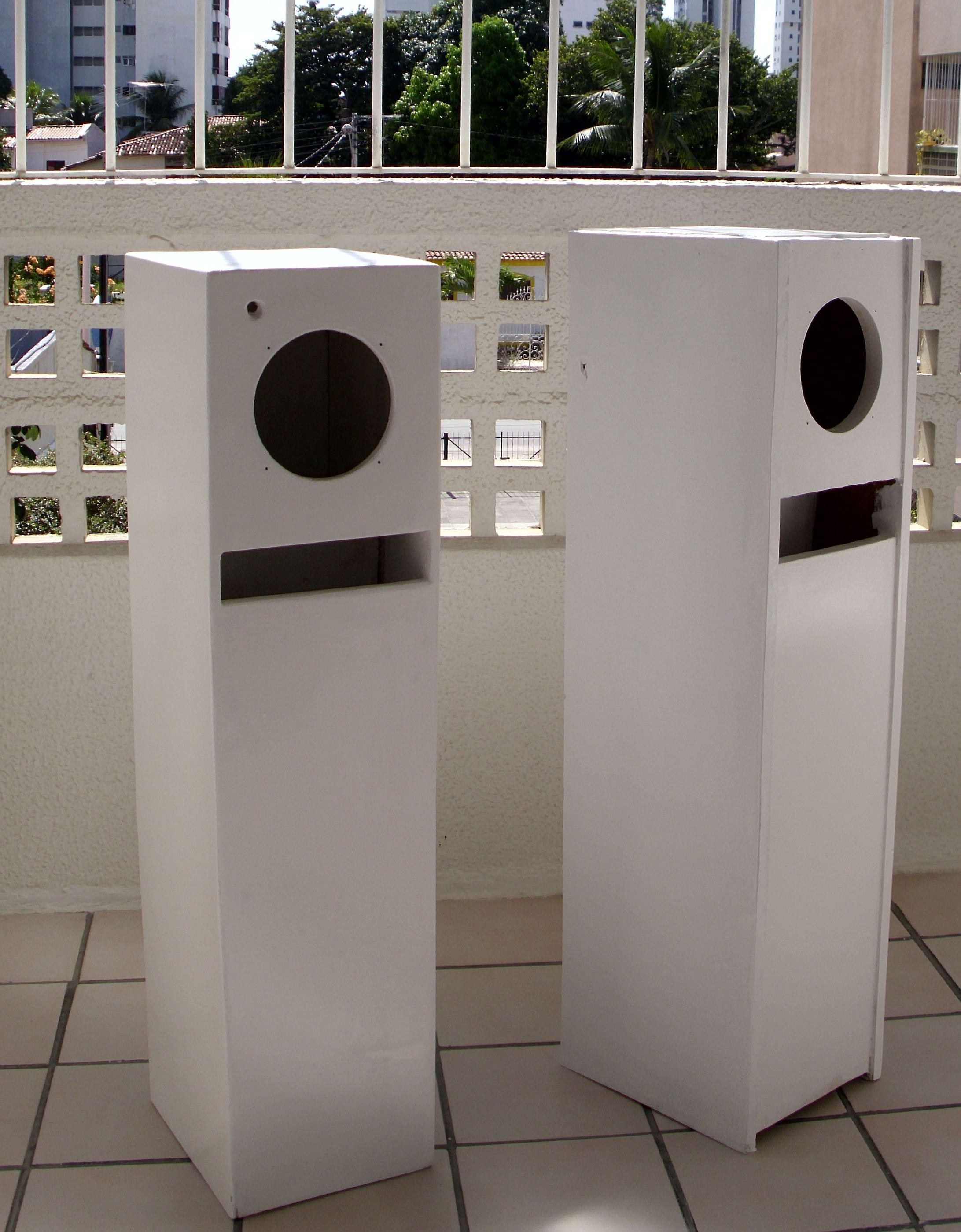

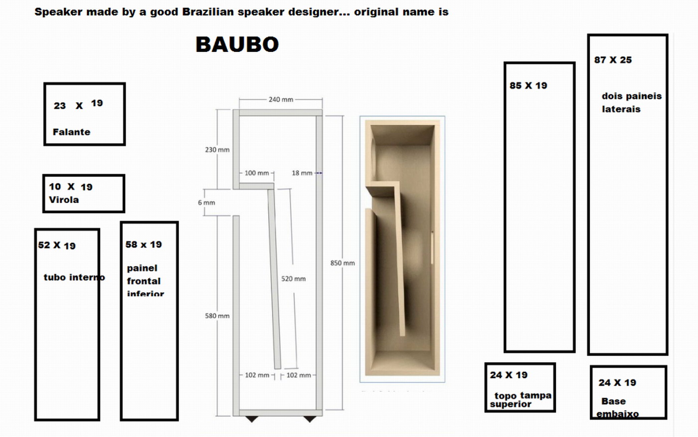

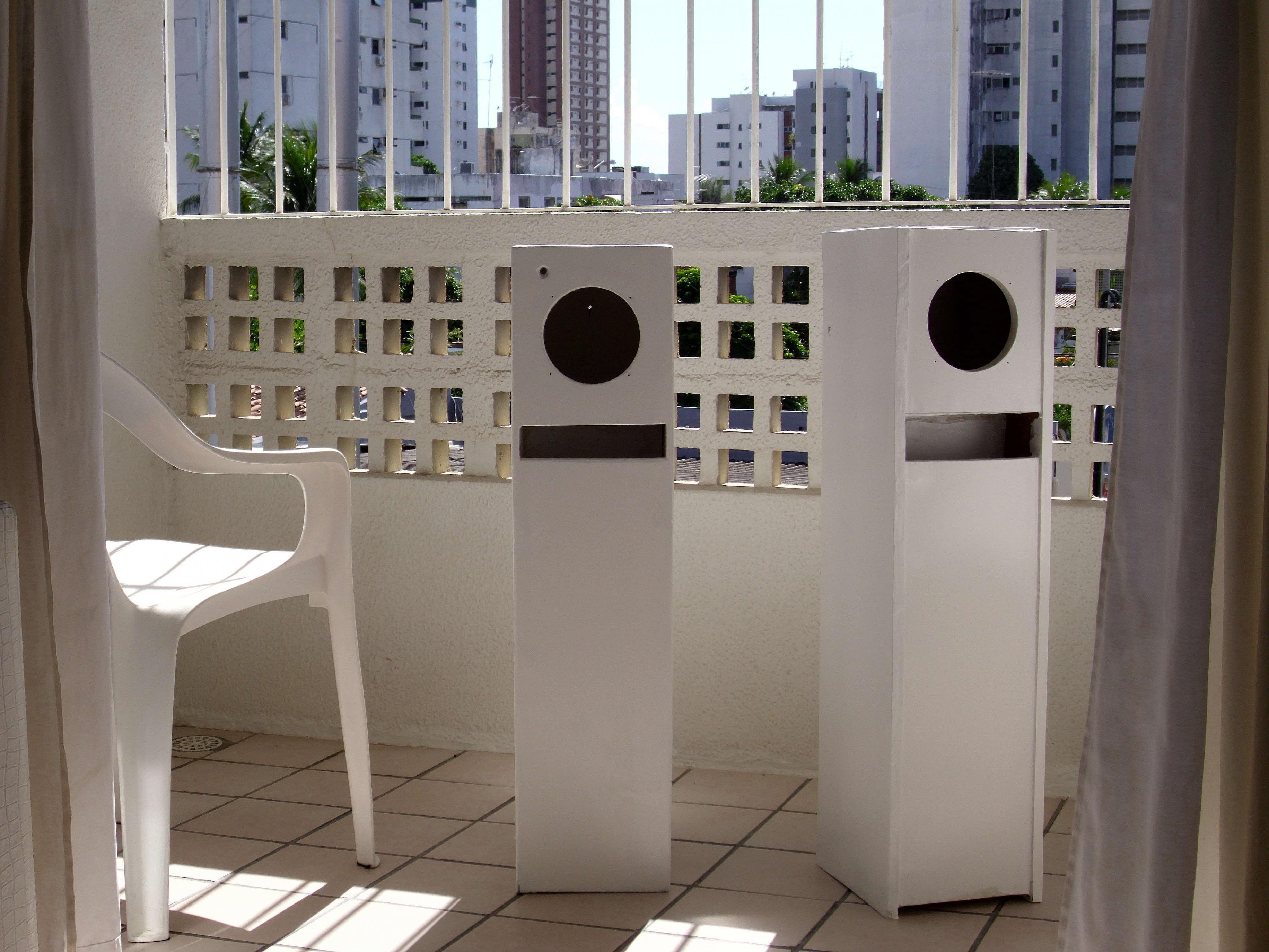

I suggest you to cut some pieces of wood, or plywood, or MDF
and to produce, at your home, with your hands, these nice speakers.
They are standard speakers, this kind of design is popular and found in many magazines and books...something good, small and cheap to produce.
In Brasil, a guy called Silva is producing and distributing in small ammounts to local guys...but you can make it with your hands....they sound great and match Dx Amplifiers....in the reality they match any amplifier as these speakers are very good.
They can go very low, with any speakers...i have tried 4 models...with awesome results with anyone of them
The tweeter you have to tune, and this is dependable the full range unit you will be using as main driver....i am using 33 ohms in series with 2.2 uf to a 6 ohms tweeter driver...you can try other values of resistances and capacitance... this depends your need/taste/environment/ears.
These speakers use foam inside, or cotton, or fiberglass...half inch is enough, in special in the corners and back panels...one panel absorbing is enough as reflection will "die" there in the first bounce.
I have tried with MDF and plywood...and no difference...the same...also dimensions are not critical as one speaker i made is different related the other...one was made by a good friend and other was made by me....we have used a lot of glue and hundreds of screws (bolts)
Highly suggested...put your hands in work....i guarantee you gonna be happy as a morning bird.
Not to be considered of topic..i gonna call it Dx Speaker...it is a Dx choice of speakers..but for sure i have not created/designed this speaker...it was selected only...in Brazil, Mr. Silva is the master of speakers.
Name of it in Brasil is BAUBO.
regards,
Carlos

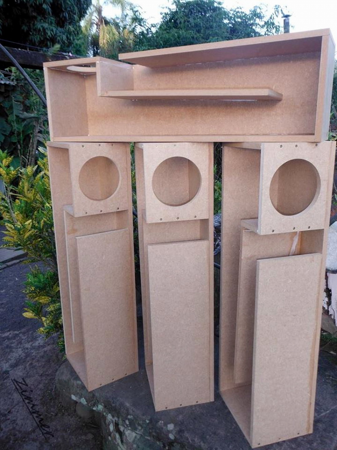

More pictures of the Dx Amplifier choice of speakers
Here you have it.....build it....you will be 100% satisfied...happy as a morning bird...and dancing..for sure you will.
regards,
Carlos

This speaker is like a "suggested kit"... a DIY by appointment
So, please fellows, do not move to speaker forum....this is a Dx Speaker to go together a Dx amplifier.
They are not real speakers, they are molecular compressors or air, able to expand too, a part of Dx Corporation suggested accessories.... a subproduct of this "machine" is that produces sound.
regards,
Carlos
