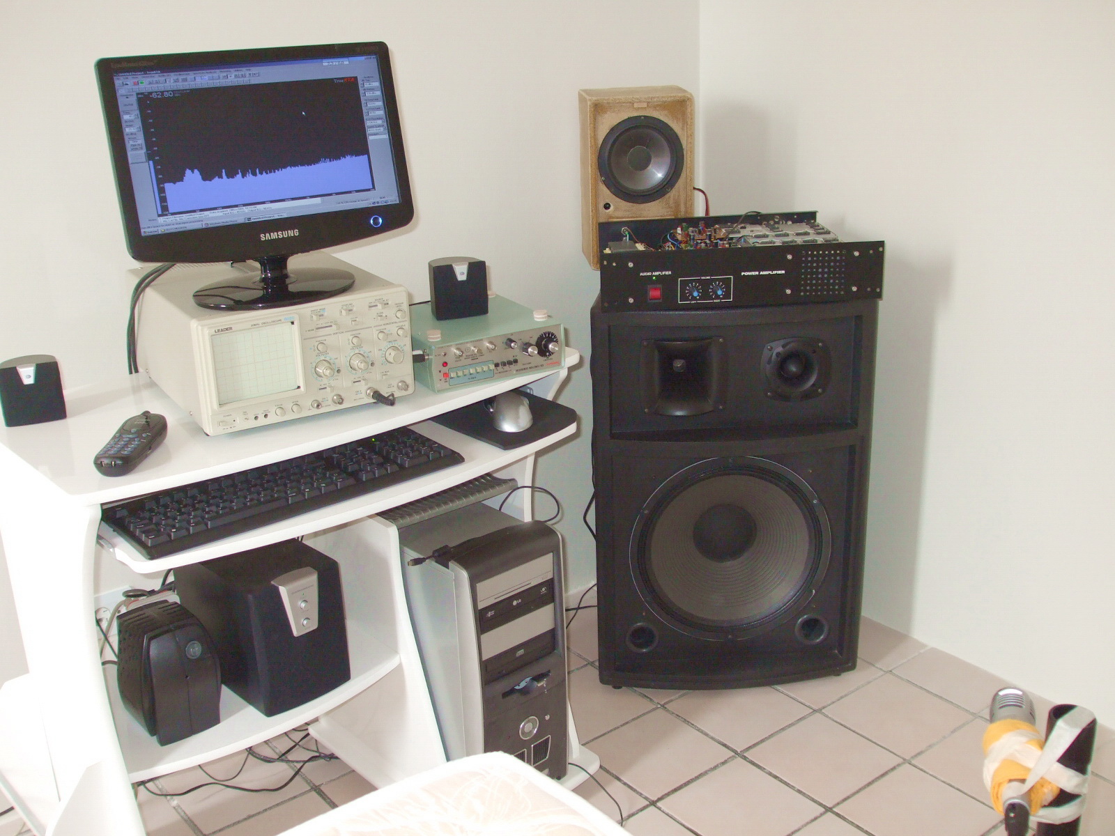

Listen the Dx amplifier, this time three amplifiers inside same case, the Dx TriAmp
playing and recording was made using Panasonic electret condenser microphone cartridge WM-61.
There are some noises, vibrations, bad room acoustics, hum from microphone cable, but even this way you gonna feel the "spirit" of the triple amplification.

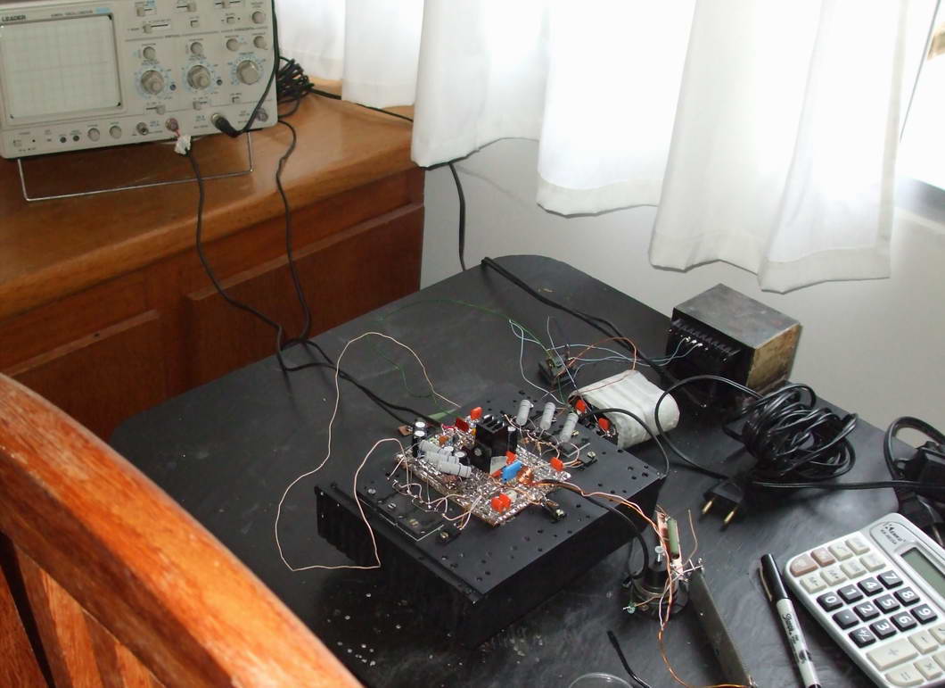

No pcb for this amplifier, basically it is the Dx amplifier with more output
transistors, so the Dx Amplifier board will fit to place the first output pair, the other must be done using home made board or point ot point wiring.
Some values may change, but is a matter of substitute those ones, to cut a trace to include the extra diode (positive rail), or not to include the one, also the ouput emitter is a matter to cut a trace under the board and the output coils is placed hidden under the board too.
A real Do it youself, nothing as kit form to this project, because it is a variation of the old and good Dx amplifier that you have into Greg pages.

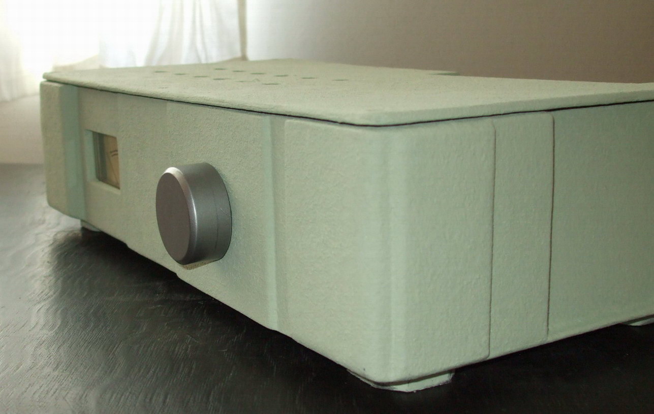

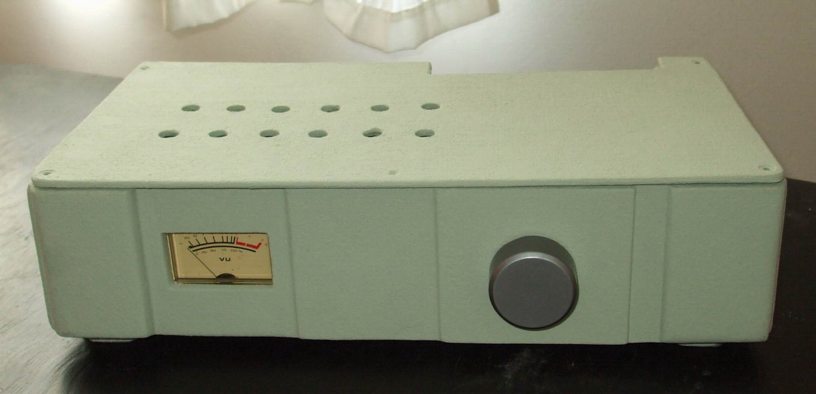

DIY Dx enclosure, made using MDF cutted in rectangular pieces and glues one over the other, in layers, was used nails and white glue (school glue, student latex glue), have receive sealant to make the mdf waterproof, and them painted using a mix of plaster, latex wall paint (ink) and colour pigments... the paint material looks alike tooth paste, high density material, and them while painting and waiting the material to dry, use a brush, hit with a brush to produce that finishment you see...looks organic, this way you may keep small errors, misalignment, hidden to the eyes..brigh finishment shows all imperfections.
