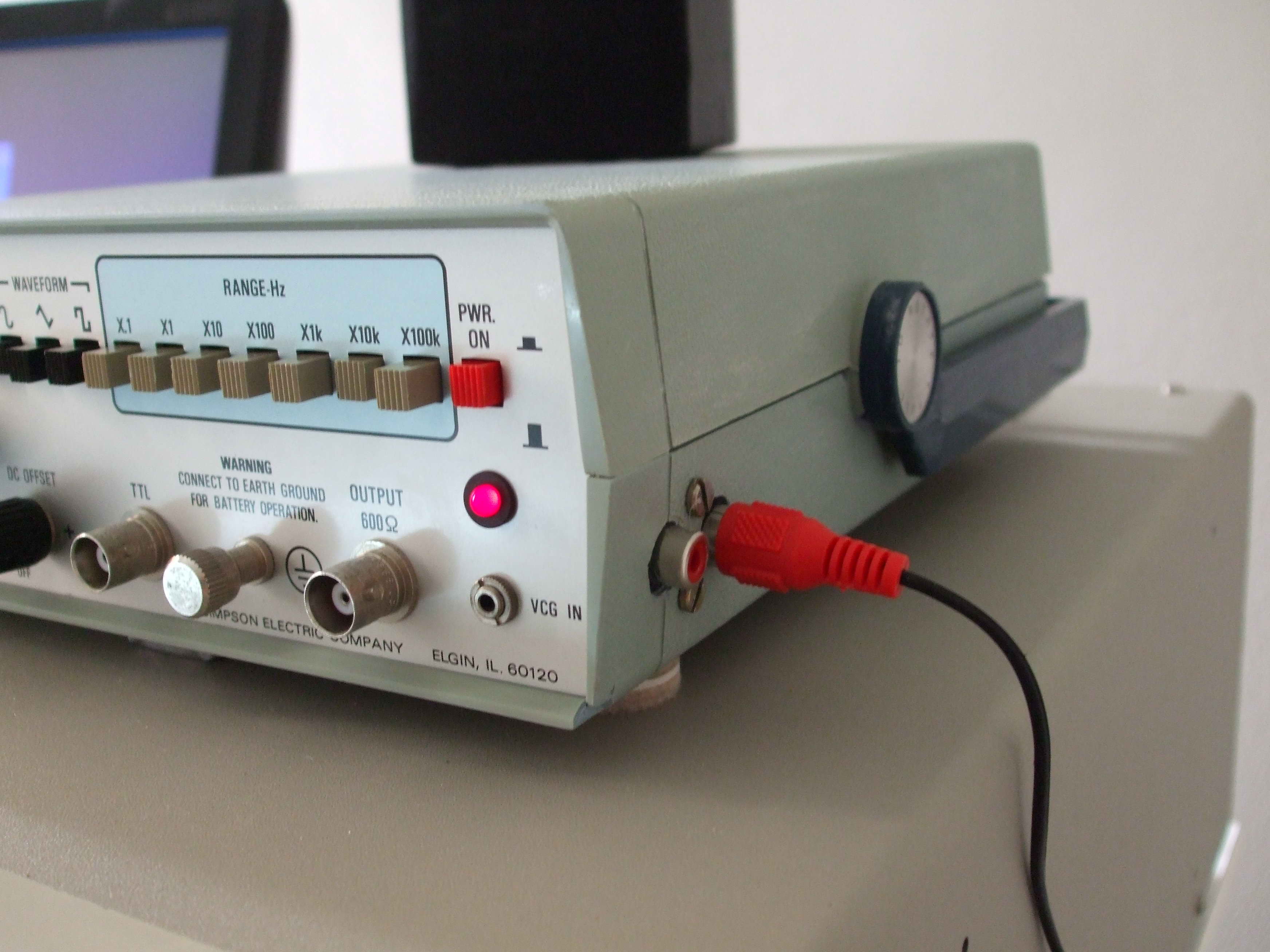

The function generator is an old passion....i told him i wanted something that way and he fast found into E Bay (USA) and bougth it dedicated to me..this happened one year ago.... and i am waiting till that moment to hold the beautifull old style generator...lovely to change frequencies turning the knob...wonderfull!

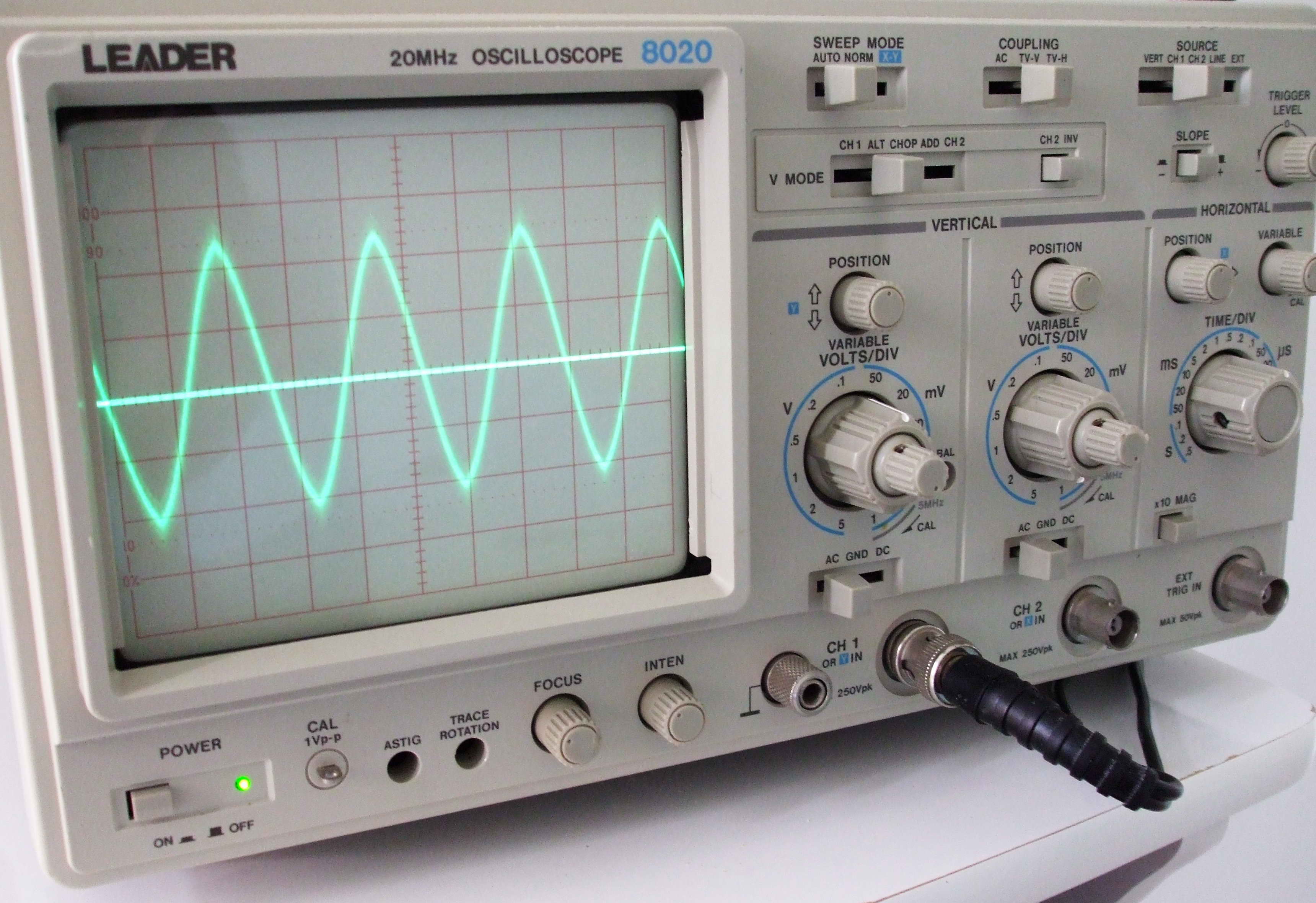

Carlos, that is a nice looking scope picture; seems like the functinon generator is working. Its hard to photo a scope due to its intensity and the surrounding light. I look foward to seeing the amplifiers that are about to be issued by the DX corp. Are you going to sing through that microphone?

Well, related the images, you see that my scope image is not fine.... cables are the trouble, also the generator needs some trimming into frequencies and waveform, the sinusoidal has a sharp point, alike a military rifle bullet...this is adjusted internally...maybe a trimmer.
