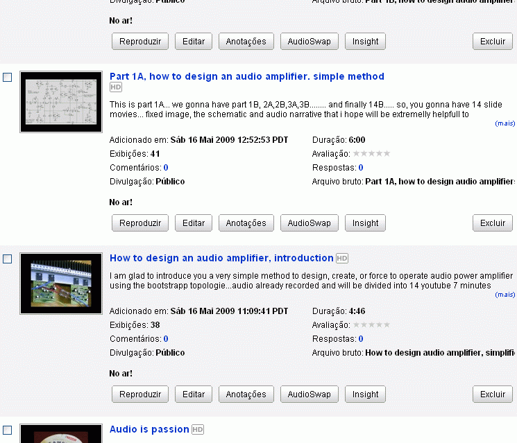

http://www.youtube.com/watch?v=hjcbdDTU5_Y
above link is the introductory slide movie about the series of 14 slide movies i am uploading to youtube.
They gonna be:
- "How to design audio amplifiers using simplified method"
Ohms law only...using the Dx Amplifier as the basic schematic.
I will be uploading those slide movies during those next three days.... two movies already there...in the sequence you gonna have Part 1A, Part 1B, Part 2A, Part 2B......... till you gonna have part 7B (the fourtenth part)
It is basic, to beginners, not to engineers, i supose they will not enjoy the non precise informations posted there...but gonna be very helpfull to the ones needs such kind of basic things.
regards,
Carlos

How to create, or design, or force to operate an audio amplifier alike the Dx one
Do it by yourself...create and build your own..it is for free..absolutelly for free!
The simple know how used, common send and ohms law is all you need....2 or three neuroniuns full operating will be enougth.
ahahahahah!
Type in youtube:
"how to design an audio amplifier"...and introductory slide movie is there and already 8 from 14 parts uploaded.... fixed schematic as image and narrative explaing all details.
Be happy, the way i am..build, share, enjoy, be friendly and figth against selfish folks.
regards,
Carlos
