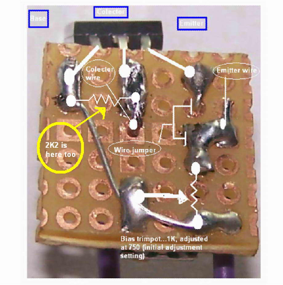

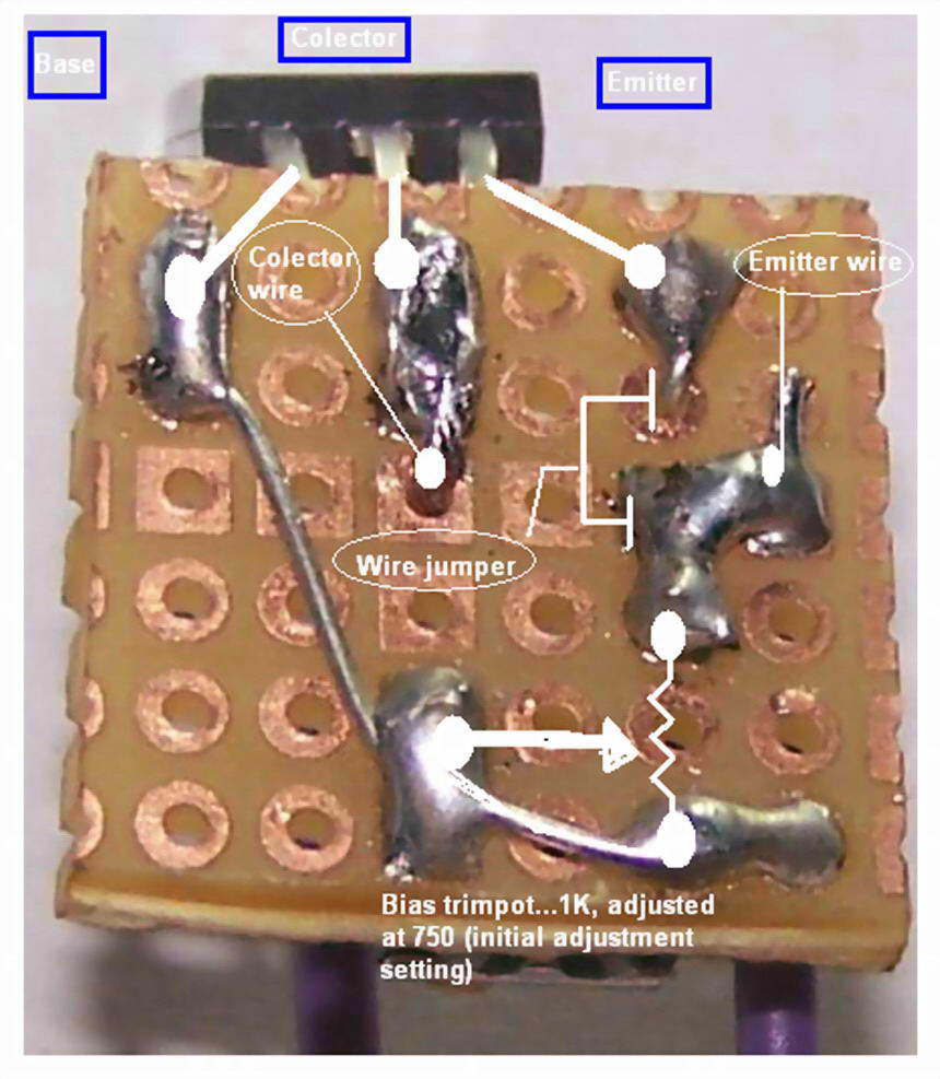

Re: Is this a resistance?... are you sure..have measured?
Yes, its read 0.817Kohm...
destroyer X said:
Check this please.
regards,
Carlos
Re: I would be happy to see the bias circuit by the copper side
Its BD139 i`ll check it again the connection.... Thanks alot DX...

destroyer X said:
or wire side, to check.
regards,
Carlos
Re: Only you will be able to see thougth all that resine..solder flux
Clean it up, not short.
Here is bottom view of the bias.
http://60.48.69.81:90/~azmi/bias2.JPG
destroyer X said:
Clean it to see shorts..otherwise will be difficult.
regards,
Carlos
Seems fine your bias board.
Continue working ....because something is wrong.
BUT..install ouput transistors..heatsinks..insulate the ones to the heatsink..install protective resistances in series with plus and minus and check once again.
If not perfect..then continue, because for sure there are errors or defective parts.

Re: Yessssss!...the 2K2 resistance..from colector to base
Hi DX,
Yes its installed 😀, now i`m checking parts one by one, i want to make sure i can have dx amp it very sure its great amp.
Check tip 41c ... ok
42c ... ok
bd139 ... ok
2n5401 both ... ok
now i`m checking all resistor to make sure it has right value and also my board if got any short 😀
Thanks a lot DX being help me all day 😀 i`m happy with it.

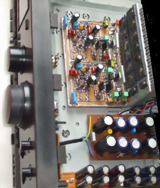

Here is a DX corporation amplifier.
DX likes to recycle, so we started with a Sansui 2000 receiver from the 1970s.
The Sansui looked very nice- separate bass and treble for each channel, but for $5.00 its getting taken home and taken apart to hold the DX.
The back panel was redone for an amplifier and to fit the large heatsinks that luckily will just fit exactly into the case.
All connectors are new except for fuse holders.
Fuse holders have not changed in 30 years.
The DX is working, biased for each emitter resistor to have about 65 mA across it.
Just gets a little bit warm, I will probably increase bias.
Charlie does not care- he wants to go for a walk and chase lizards.
I have replaced gain resistors with higher values to reduce the gain which Carlos says was too high
Power supply is 4x15,000 uF capacitors with no CRC filtering. Xfo is 25-0-25 and 500 VA "rescued" from another project (trash bin).
There is no hum.
DC offset is < 20 mV.
And it turns out everything just fits into the Sansui. I am going to get a fancy new front panel and this will look very nice.
How does it sound- not sure, just got it working and will try with 'real' speakers after I am sure it will not blow up on me.
