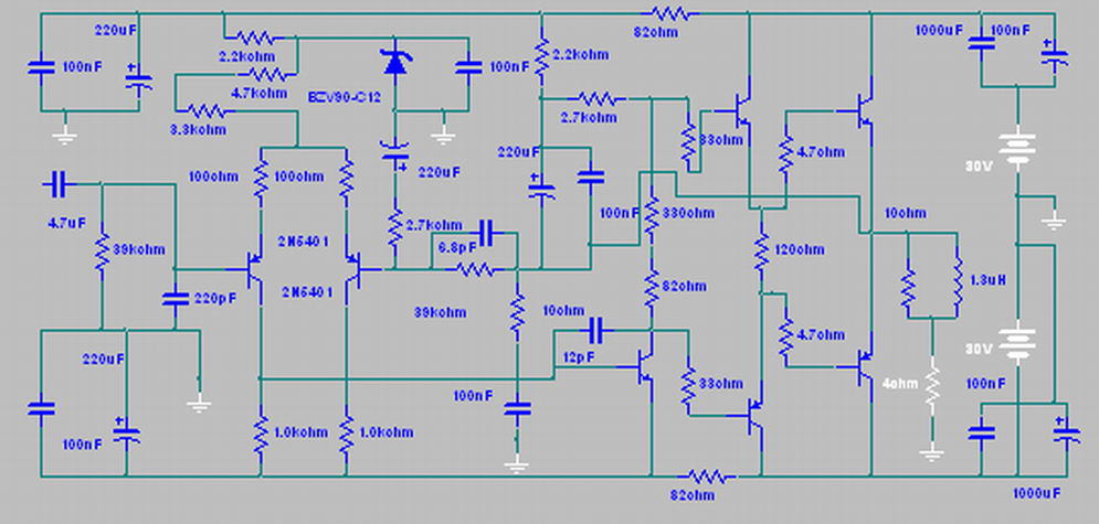

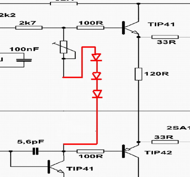

Ilyzm, thanks by your link...pretty work..congratulation..let us know your schematic
please....the one related your constructions posted in the Croatian forum....well..i would love to to understand your language....a big frustration i have... i cannot understand.
Sparkle said you are a very nice guy in the Croatian forum...so.... i have misunderstood you...i took your words from a bad point of view.
I continue to think that you may be those ones loves to search for snake legs...and those guys use to produce a lot of work in foruns...as they block the rithm, forcing us to explain our reasons to decide this and that...this is something that makes me tired to tell you the true.
The Vbe multiplier, as you know represents only a variable resistance to set 2.5 volts (or other voltage) from colector to emitter...off course that voltage is with zero volt centered to allow bias for the output unit....and i hate to say those very basic things that may annoy a lot of people.
In my point of view, it is a resistance..working as resistance...as voltage is developed over it's extremes.....a variable one, thermically tracked resistance...sensitive to heat, that will reduce that voltage depending to the heat...reason why those VBE multiplier transistors are attached to heatsink....you see..i am talking...and you know those things.
I have no problem against VBE multiplier...my problem is related people that can imagine that others do not know that need, how they work and how to calculate them...people that may imagine (not you case, as explained by dear Sparkle) that others had not studied and are publishing things with errors...not because decisions were taken before about that subject....my case is more than 40 years of experience (practice, constructing daily, at a rate of 2 amplifier a week average) to decide those things.
I have posted one option related those VBE multipliers...having not the transistor working there....but having the diodes working...was three junctions that will produce a good result too...alike the famous Doctor Leach suggested.
My option, even living in a hot environment....as here 29 degrées is a very constant temperature, is to use bigger than needed heatsinks...well...i just have them and i think they are good and i can avoid some circuit...removing a transistor.... making it simple and cheap.
But people have their own brains and they can go to different decisions...and produce their own amplifier...with their good Vbes...even using complementary VBEs and other sophisticated circuits the one can imagine or create....but this is not my beach..this is not my intention.... the opposite...Dx is simple, to be simple, to continue simple, and the intention is to turn it more simple.
I hope this can finish that last "exciting chapter" and that we can march into the future as good friends.
I suggest you to publish, if you have not made it already, some amplifier to us...hehe...i will be there to ask the reasons you have to use VBE multiplier instead of diodes or resistances...hehe...i am bad....hehe....very bad!
regards,

Re: ilimzn - my question
Just spotted it, and the answer is, I don't know that you can calculate it. You probably could knowing what the filament temp is (close to light temp), but i think some of the filaments tempcos are not linear.

Re: Ilyzm, thanks by your link...pretty work..congratulation..let us know your schematic
I know what you mean, but it is exactly reading about these decisions that alowes me to learn. It is very difficult to use the fact that something works better if i add or remove a component, unless i can, at least slightly, explain to myself why. Without the 'why' I have to 'fly blind'. i guess i am very insecure that way 🙂
Oh, I know you know what the Vbe multiplier is for, no problem there. The reason why I commented was not your choice but something Lineup said regarding the use of other transistors instead of 2SC5200/2SA1943.
In any case, using 3 diodes and a resistor will do just fine. The only reason I prefer Vbe multipliers is because it's generally easyer to mount a transistor like BD139/140 onto the heatsink, but I have used other methods as well. Like you have your choices, i have some of mine, so the Vbe multiplier is one fo them - I am not trying to say my choice is better - besides, whoever builds the amp can try it for themselves.
So do I!
Why bad? I would be glad to explain my choice. Besides my last amp uses a Vgs multiplier hehehe 🙂
The Vbe multiplier...
I have no problem against VBE multiplier...my problem is related people that can imagine that others do not know that need, how they work and how to calculate them... I have posted one option related those VBE multipliers...having the diodes working...was three junctions that will produce a good result too...alike the famous Doctor Leach suggested.
So do I!

Because of transformer power the amplifier will be very strange
Constant sinus power will not be possible to sustain above ...say 15 watts (or something so small this way)
But having good electrolitic condensers to hold some energy...you may have interesting peaks..
The amplifier will distort in the reality, but as Sparkle said...keeping volume low you will be happy.
If you decide to use both transformers, join them together after rectification and filtering...this way you will have full power.
70 watts RMS over 4 ohms
35 watts RMS over 8 ohms
I was watching it in the simulator....not so bad as i was imagining...it may turn a 10 watts amplifier with incredible short time peak power...hehe...interesting behavior.
regards,
Carlos

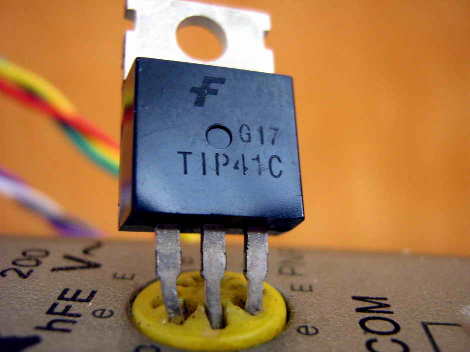

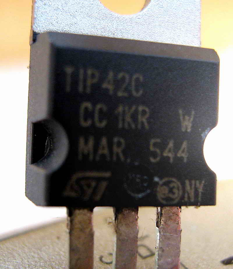

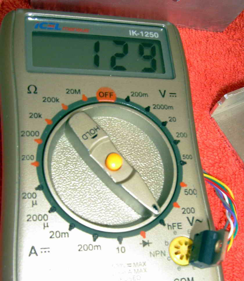

I was using, because decide to do this way, a very cheap, common, standard and not
so good transistors.... when i did that i was thinking about many sittuations i could testimony....people not constructing things because they did not have "that" transistor.
Many guys believe that if you change the transistor, let's imagine, for instance, transistor 12345 by another one..12346, that everything will not work fine anymore...that the amplifier will turn unballanced...that may not sound the same...well...people will feel insecure...not safe.
In the reality, things are not so hard this way...and the enormous quantity of transistors happened because during early days, the factories had not sure about what will be ready related the things beeing "cooked" in the owen..... the waffer, when ready was tested and "good" and "junk" was separated...and them the 2N3055 they wish to produce, in the reality, after measurement was another one...with small variation related the one they intended to construct....now a days things are different, but you still have some variations that explains the enormous quantity of audio transistors...all them work fine.
Respect maximum voltage swing...maximum current... attention with the gain, observe the maximum workable frequency, the power dissipation is adequated or not...and if all those things match your needs the new unit you were searching will fit...guaranteed.
Then i have used those low frequency transistors...i am not sure, but they may not oscilate over 10 Megaherts...not sure about...have to observe data sheet....TIP41 and TIP42 are for audio purposes.... 30 to 60 watts dissipation...30 real and 60 fake... 6 amperes and i think much more than 60 volts...well...my imagination only...i am experienced with them, using them, and they fit plus 35 and negative 35 volts...the standard voltage i use normally to everything i do here.
Observe the TIP42.... beeing PNP, as usual, it has more gain than the NPN...reason why people prefer to use PNP in the first stages.
regards,
Carlos

Well...i decided to use them..even this way...and nothing happened,
The transistors sounded great(TIP41 and TIP42 as drivers)..sonics were excelent, the amplifier was not unballanced...VBE voltages very good and almost the same related NPN and PNP....i had not off set problems to adjust...i have also not Bias problems to compensate.
They sound beautifull...even beeing low frequency units.... their cut off higher than audio frequencies.... many times higher.

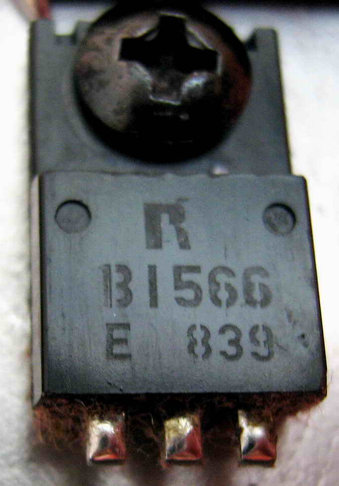

Then, i decided to stop a little to install better ones...not so good related maximum voltage swing...so...i had some fear that problems could burn one of them...as they cannot hold the peak to peak voltage from my supply...but i accept the risk to test, once more, those things that i have strong belief.
I decided to install 100 Megahertz, modern units...better...much better than TIP41 and TIP42..
This is one of them.
regards,
Carlos
