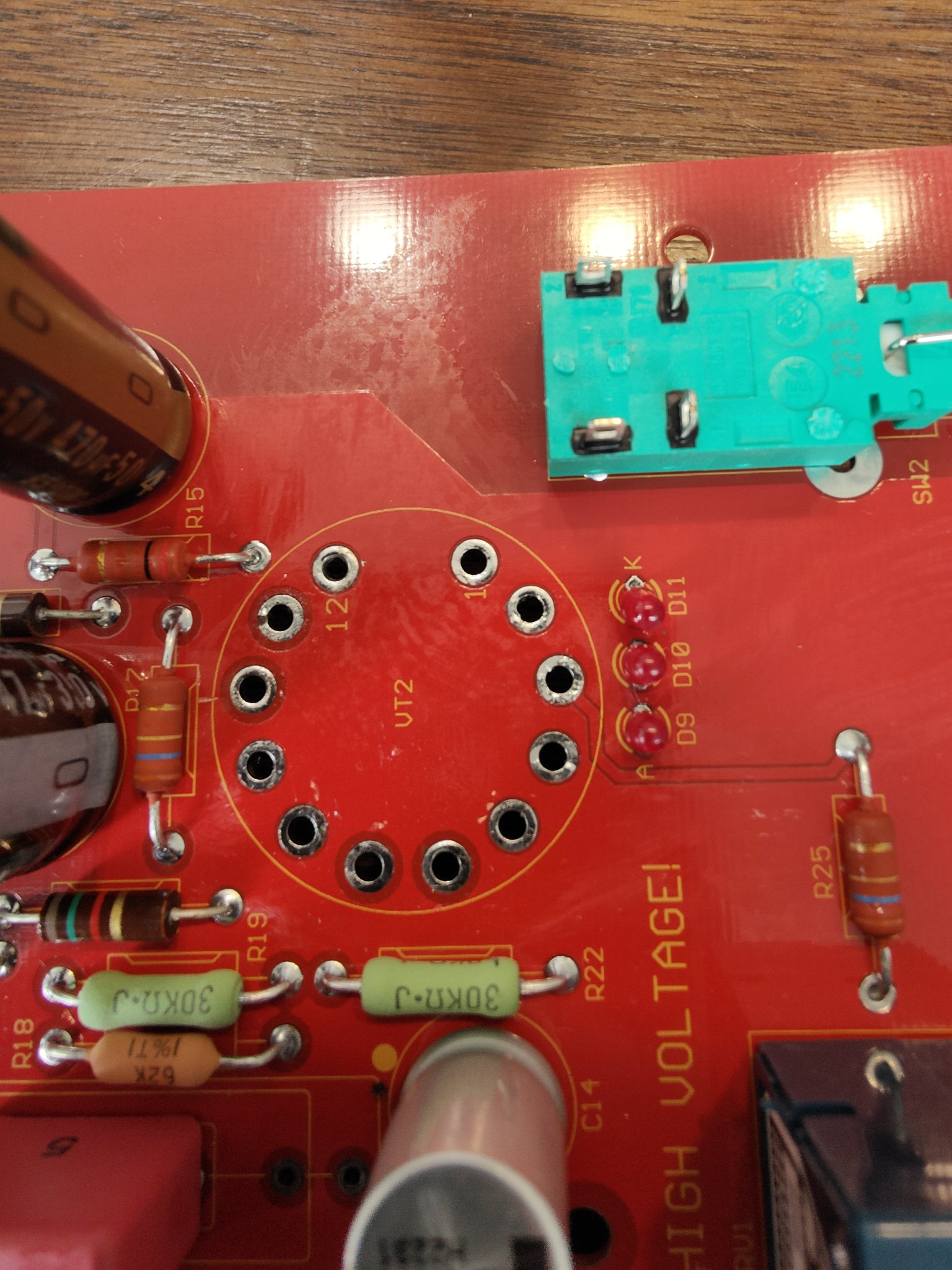

Getting there with the 'tooth extraction'!

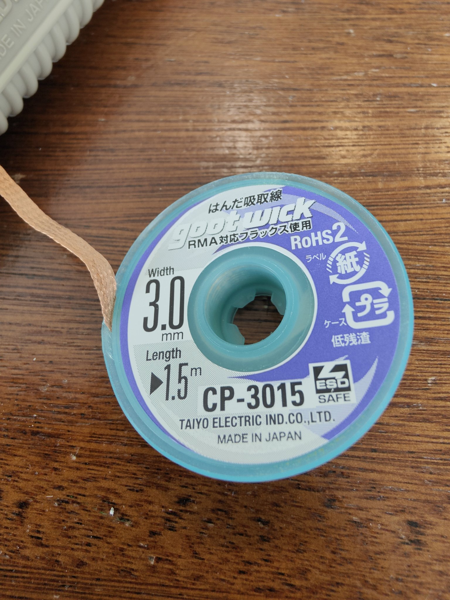

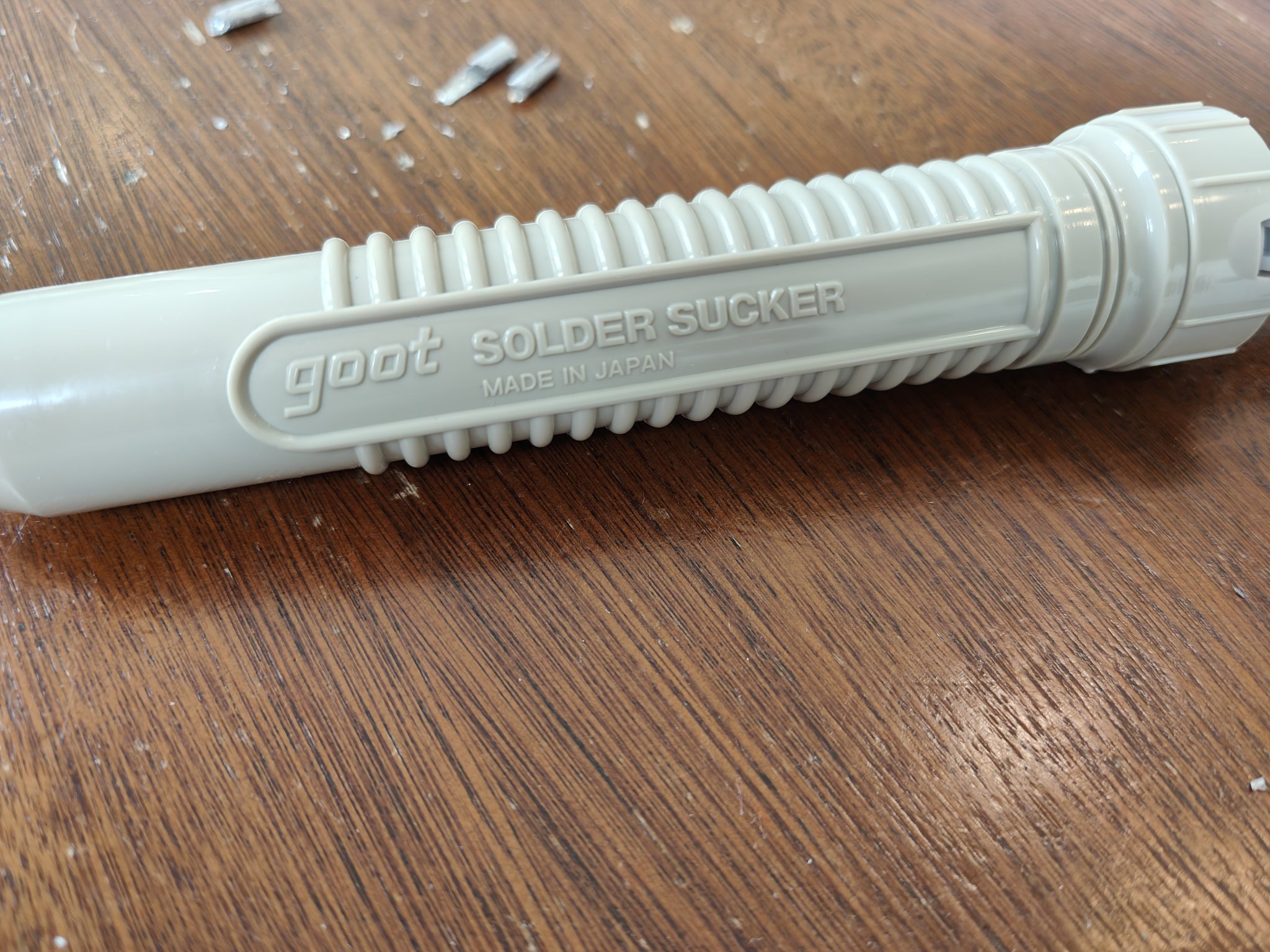

I tried a few solder pumps but the GOOT brand is by far the best so far. Plus using nice thick desolder wick 3.0mm helps clean out the PCB holes.

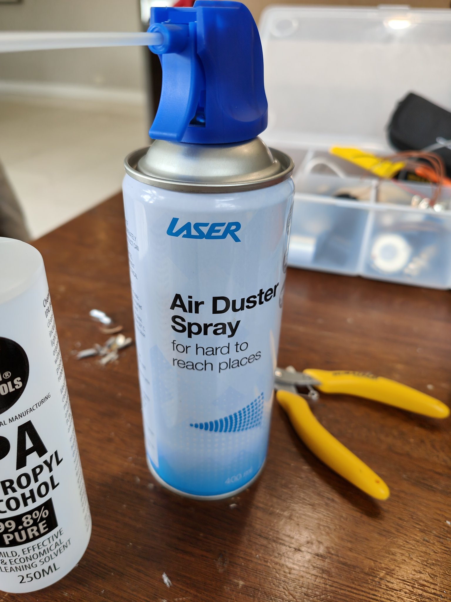

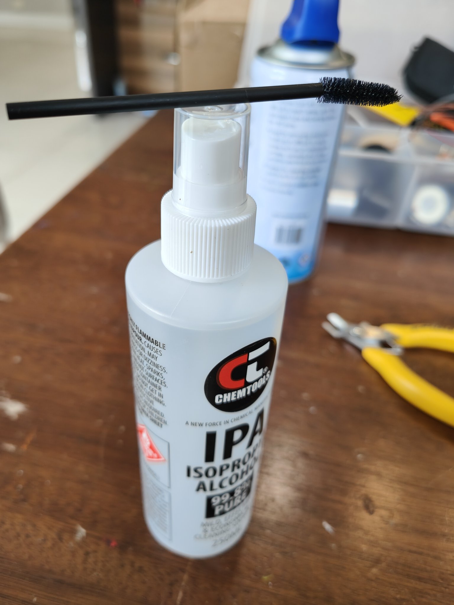

Then, isopropyl alcohol with a soft brush and a blow out out of any residue/dust and we are ready for soldering of the replacement sockets.
Hope this helps anyone with a similar problem!

You should be proud of yourself. Desoldering can be really crappy work! I say that because even today, I struggled with the tiny holes that are so popular these days. Desoldering gun didn't work. Different solder wicks, even with a little extra fux didn't work. The cheapie manual solder sucker did best. And for what it's worth, the ChipQuik didn't do as well as usual. When the holes are small, all you can count on is damage. Next time, I will try to remember to use the pointed tip on the soldering iron.
Your work looks like new.

Thanks mate - I forgot to mention for any newbies, practice on an old board first!
I grabbed an old preamp PCB (failed experiment) and desoldered that - which led to the discovery that thin braid and inferior pumps just didn't work as well.

I forgot to mention something IMPORTANT in my last post. There are several "no cleanup" or "water cleanup" solders available today that use a water soluble flux. The residue left behind from the use and imperfect cleanup of this kind of solder IS hydroscopic and WILL absorb moisture from the air. This may be OK a typical "maker" board that runs on 5 or 12 volts. It is NOT OK on a vacuum tube amp or other PC board that operates at a high voltage level.
There have been two instances of residue from some Chip Quik water cleanup solder conducting enough current to fire up and burn a Tubelab PC board. There was a customer with a burnt TSE-II board who had used Chip Quick solder and then left the board in his garage for several days. After finishing the amp all worked well for a few days before the fireworks began. I sent the customer a new board and got his burnt one back. There was a spot where the board had carbonized and burned and a few other places where some stray current had obviously flowed. Application of 500 volts to other traces with flux residue did not produce fireworks, so I left the board in the garage for two weeks. Reapplication of voltage produced fireworks which usually just popped and died. In two instances the fireball grew until the board was burnt.
I purchased the exact same solder he had used and was able to duplicate the fireworks on a new board. If you use any solder that is no-clean, or water clean, use IPA to remove all residue from the board before applying power.
I made a "really sloppy solder job" board with the same solder, let it sit outside and in the garage for several days, then tested it for conductivity and got some fireworks. I then scrubbed the board down with some 91% IPA from Walmart, let it dry in the sun for about an hour then brought it inside. After a day or two I tested it to 550 volts (the limit of my old Fluke 407D) with no fireworks.
Walmart has 3 grades of IPA, 50%, 70% and 91%. The non alcohol component is water, so get the 91% stuff or but 100% from Amazon.
