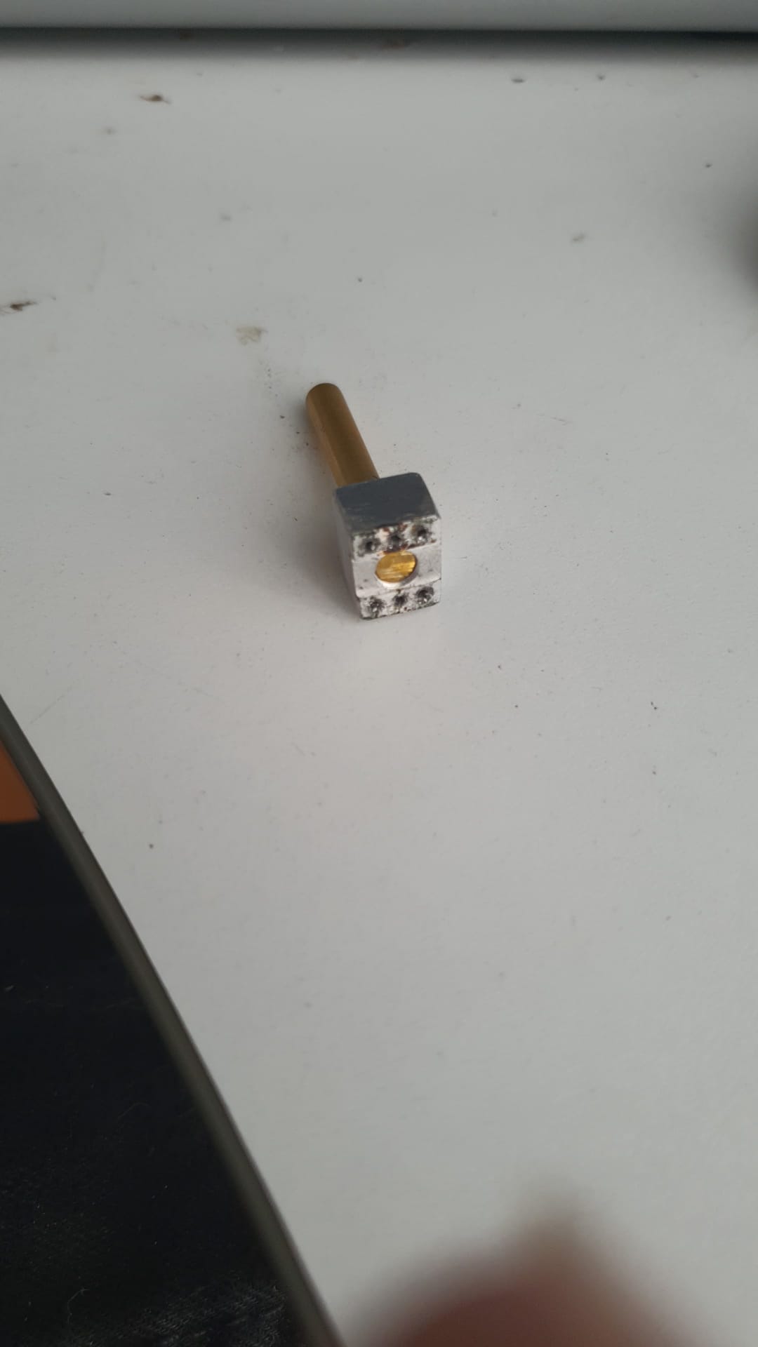

I did this on a smaller scale to desolder 6 pin IC's, made an adapter for the pattern, i guess if you use a plumber's iron you could make a big adapter. But I have metal working machines.

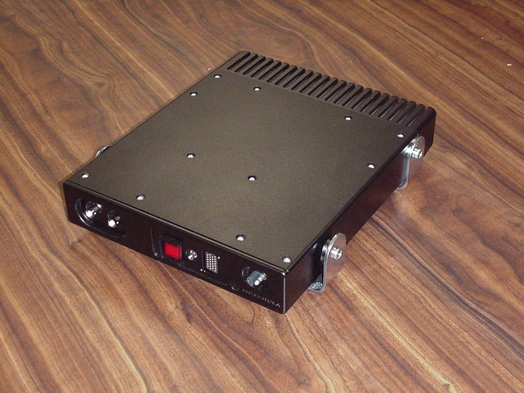

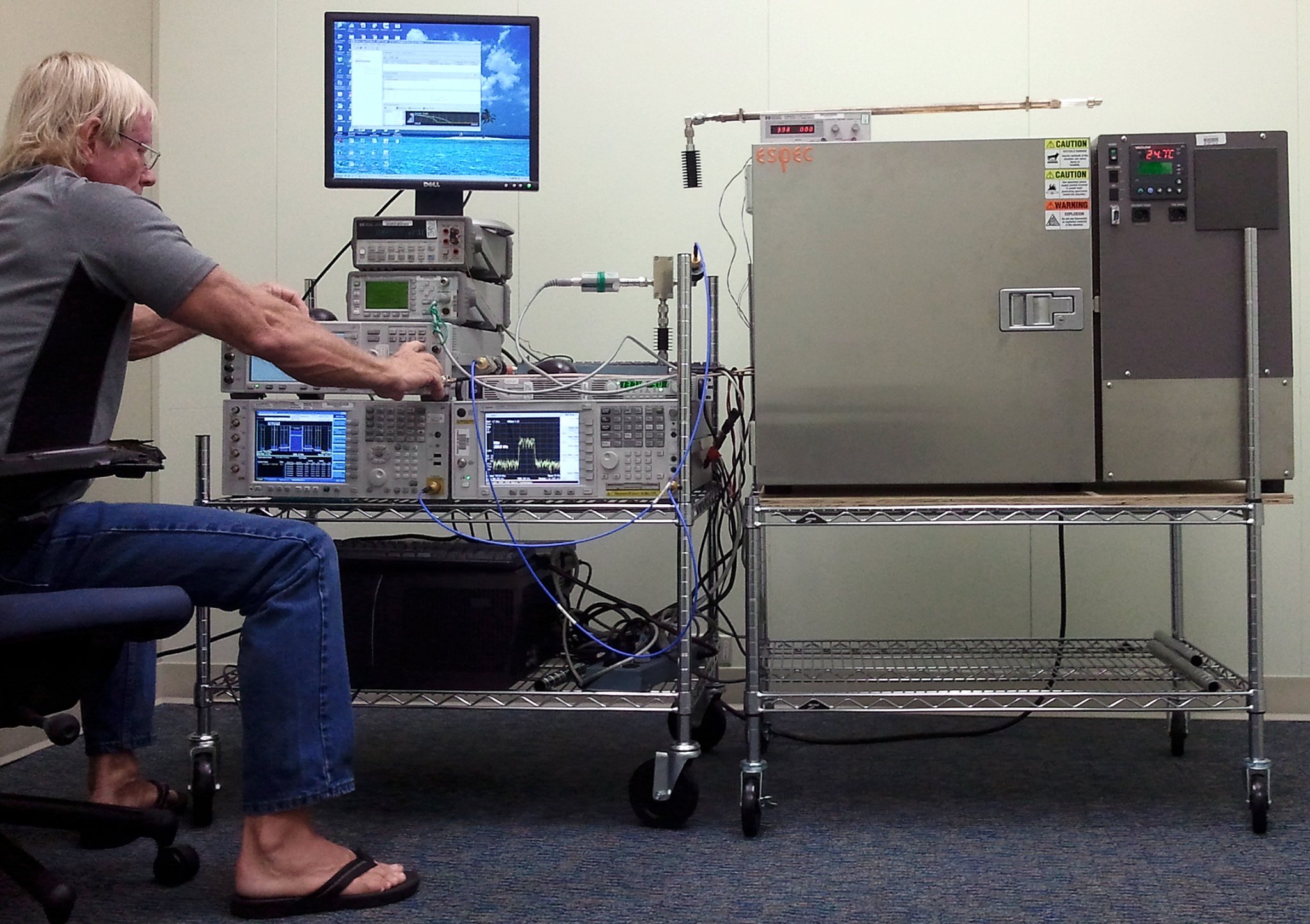

For the last 12 years of my career, I worked in the research lab where I made prototypes to showcase our technology. Most used an existing radio housing and PCB form factor to eliminate the mechanical design process. Sometimes we needed to make something that would not fit into an existing case.
One of the last prototypes I made was this data transceiver. It could put out about 20 watts of average LTE power in the 700 MHz band with 100 watt peaks. Everything from the CNC carved chassis to the PCB's were made in house. I left in 2014 as I saw my in house "toy shop" being shut down one piece at a time and was offered a convenient buyout.
