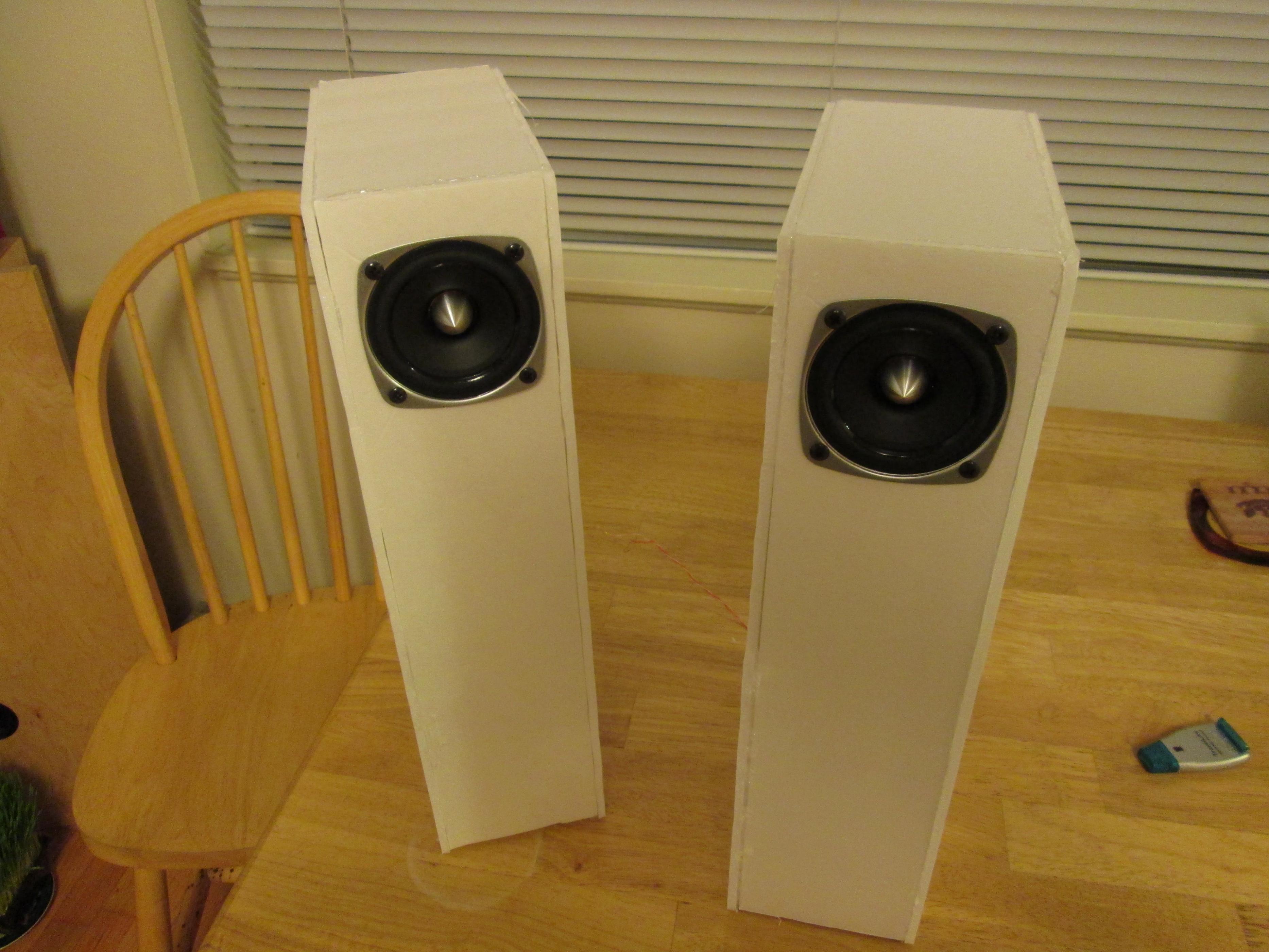

Dear Henkjan, I made a quick pair of your upright desktop TL's out of paper board using the Tangband W3-926SDF. They're fantastic! I used my digital EQ to approximate 3db of baffle step and they sound great. I will definitely be making a pair out of real wood as soon as I can. Thanks so much for the awesome design!

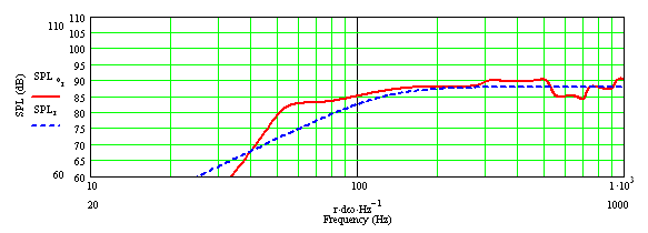

im surprised the A5 doesnt go as low as others, due to its Qts and despite the higher Fs. I trust the sims, just a little surprised. In nearly 9 litres WinISD shows extension to ~60hz, although ive not tried a box of that large a volume. Is there a clear reason why this so in the desktop TL?
maybe one could make a TL design that enables it to go lower, but 60Hz is already pushing the limits of the A5 far beyond what Mark designed it for. The sim I showed for the A5 is in another enclosure as this one hereim surprised the A5 doesnt go as low as others, due to its Qts and despite the higher Fs. I trust the sims, just a little surprised. In nearly 9 litres WinISD shows extension to ~60hz, although ive not tried a box of that large a volume. Is there a clear reason why this so in the desktop TL?

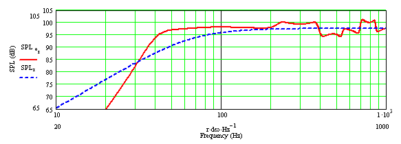

Henkjan, I am fairly amazed at how good the bass is on this speaker, especially given that you have extended the bass to 1/2 the Fs of the driver. Do you think that a scaled-up version of the same design would work for larger drivers? I am trying to imagine how big this cabinet would have to be to be tuned to 35hz or even 30hz.

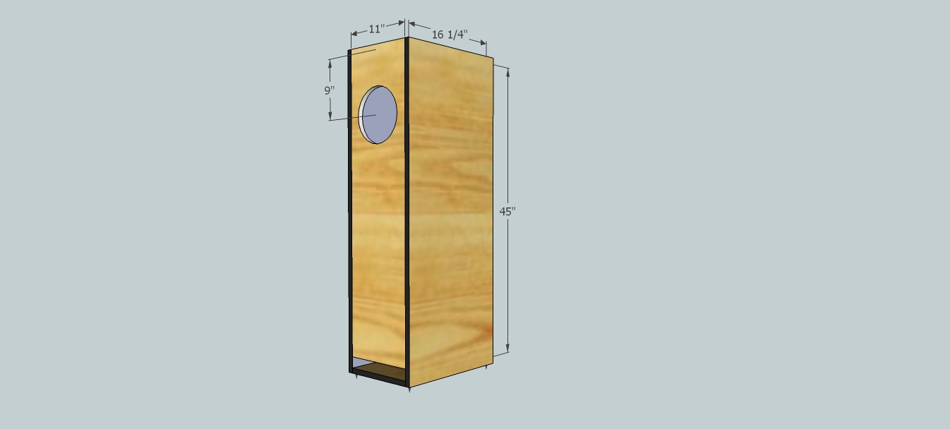

You can get the lower tuning way past the Fs for drivers with a moderate to high Qts. A similar, but simpler cabinet is the well-regarded TABAQ which is able to get 55 hz out of a 3 in driver and has a flatter response on the sim in MJK. The TABAQ has been scaled to 4 in 5 in and now 8 in drivers with success (8 in is on paper only as the builds have not been done yet - see the WIBAQ thread). The design is here: http://www.diyaudio.com/forums/atta...aq-design-betsy-k-wibaq-driver-9-inch-top.pdf
The Betsy K in the TABAQ is supposed to go to 35 Hz and is 45in full length - that can be folded for an approximate 2 ft tall cabinet.
http://www.diyaudio.com/forums/atta...513416-wibaq-tabaq-design-betsy-k-wibaqv2.jpg
yep, I dis a scaled up version for the CSS EL70, tuned at 45Hz:Henkjan, I am fairly amazed at how good the bass is on this speaker, especially given that you have extended the bass to 1/2 the Fs of the driver. Do you think that a scaled-up version of the same design would work for larger drivers? I am trying to imagine how big this cabinet would have to be to be tuned to 35hz or even 30hz.

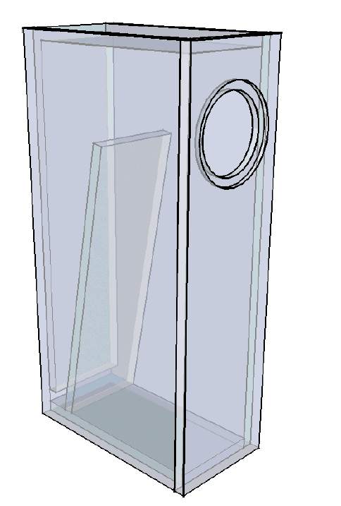

Folded TABAQ - 3" Desktop with bass
Hi
The folded version of TABAQ has very good bass performance with the 3" TB.
http://www.coolcat.dk/bjoern/TABAQ BOX Cabinet build.pdf
PS: You can mount the driver in the middle of the baffle it you like.

Hey guys, I did a quick test of my foam board desktop TLs using a frequency sweep. There was clean, clear bass down to 40HZ, maybe even lower, before there was significant rolloff. This is an awesome design!! I cannot wait to make a proper pair. The results could only get better and better.
I'll try to, but it won't be coming anytime soon. I'm heading out of the country in a couple of weeks and it won't happen until I get back. However, in the meantime I could run a sweep and record it, just to provide evidence of the bass extension. Obviously it will sound like crap. 🙂
Yikes, sorry for the faulty info guys. I THOUGHT that was too good to be true, especially since it contradicted the simulation. I didn't realize my subwoofer was hooked up last night. 😱 The actual bass extension is a more moderate ~55hz.

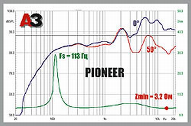

Help with 4" coaxial car driver
Can someone rework the project for these speakers?
TS-E1076 (Archived) - Pioneer UK
Here are some measured parameters from this Russian website:
avtozvuk.com
Nominal power: 25W
Frequency response at level -3dB: 110 - 22000Hz
Sensitivity dB/W/m: 88dB (150 - 15000Hz)
THD at level 90dB at 1m(160 - 4000Hz): 2,03%
THD at level 90dB at 1m(100 - 125Hz): 9,15%
Midbass resonance frequency: 113Hz
Qts: 0,657
Vas: 1,94l
Force factor(BL): 3,4 T-m
Mms: 3,9g
Zmin for the midbass: 3,5ohms
