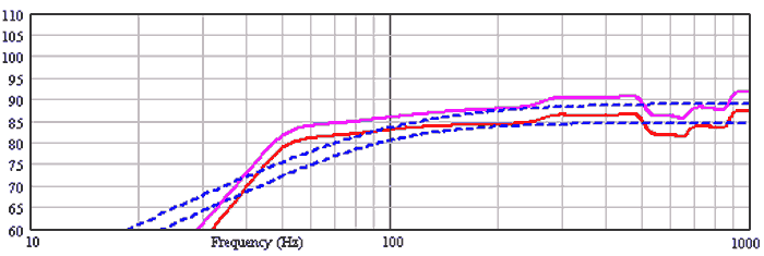

Wondering how this enclosure would work for the CHR70? Any thoughts? I like the profile of this box and want to do something similar with the CHR70.

Uncle Meat- Thanks for the link to your thread, though I wish I could read German! Seems you didn't use a port? I gather you increased tube height to compensate for the smaller tube cross-sectional area?
-Kent
-Kent

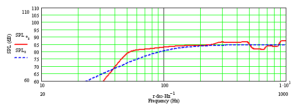

Without port, it would be a CB.. The lower part is only there, so I have some space for a notch filter.. There are some holes in the rear side below the "base disk", total around 2 times the end area of the line..
The cross section is only 6% smaller than Henkjans box, I guess that makes no audible difference.
I used cardboard templates to find the proper shape for the "divider board".
Reviving an old thread to ask if Fountek FR88ex will work in this enclosure.
I already have some 18mm plywood and the Fountek drivers of course and i would like to try a desktop tl sort in height as the first picture.

Check these out, specifically designed for this FOuntek, 3 or the 5 designs are desktop, have been built and proven good.
http://www.diyaudio.com/forums/full-range/210106-fountek-five-fr88ex.html
dave
Thanks Dave,
i ve been following the Fountek Five thread, but at the moment i need a short enclosure.
Yes, you have wright, Ken Lite has the same height 27 cm as Henkjan's design but i guess not the same bass extension.

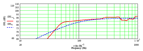

there is minor difference on spl only.
Do you think that Ken Lite, will have more bass extension than that?
All i can say is that, subjectively, the TML with A5 does not go as low as any of the Fountek Five and does not go as low as the sim would indicate (low end to not much below 100 Hz)
