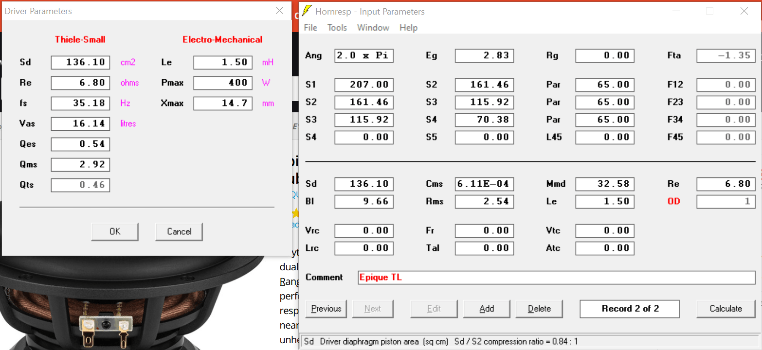

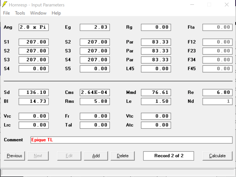

This is the driver and pipe segments entered into HR
I'll enter the reduction next. I'll start with 34% and also sim any other recommendations
Something that I need help with. Is my understanding correct that a one third offset can be used to cut the odd harmonic peaks. Am I understanding correctly that it will leave the 2nd harmonic untouched by much?

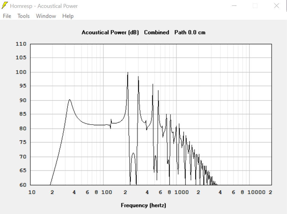

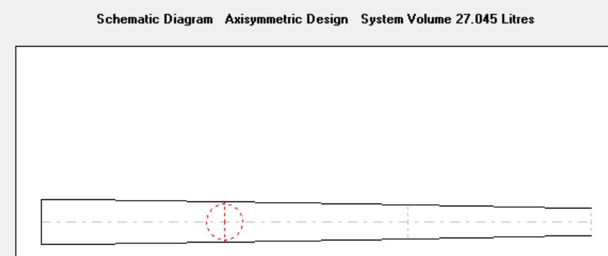

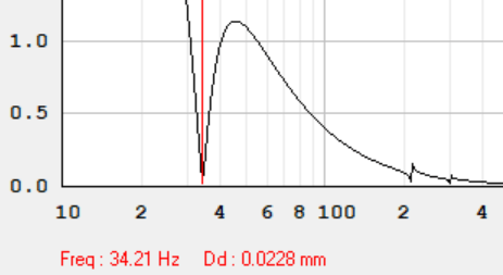

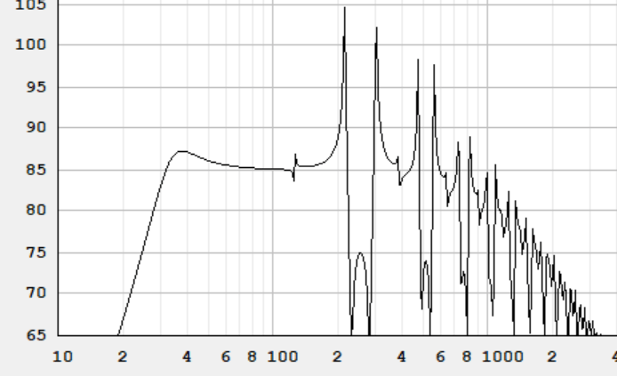

Please disregard the previous, post. I have the 34Hz results with 65 cm segment lengths. System Volume 27L
Epique E180HE

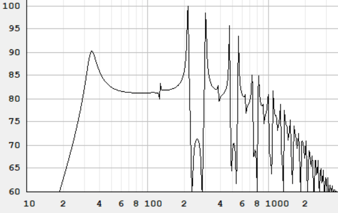

How does this response look?
Opinions on this result please as this could form the basis of the build to test the Pioneer coaxials in this cab
Epique E180HE
GMHmm, why are your specs so far off from mine?
edit: You forgot to convert 0.57 ft^3 Vas to 16.14 L
PS: Please Export any HR file you want us to review.

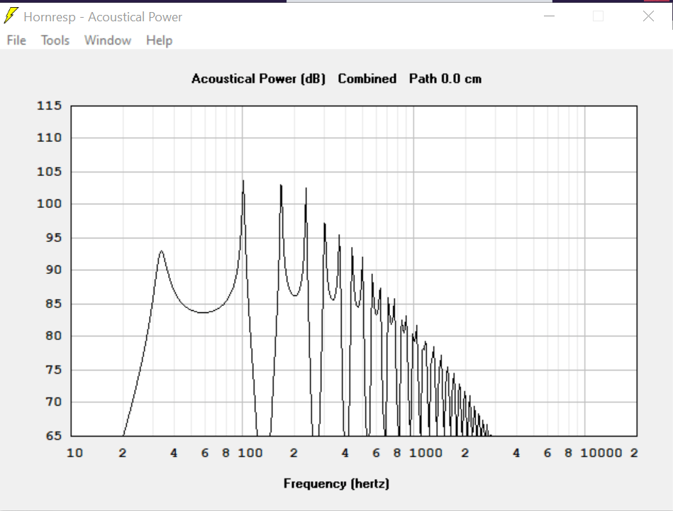

Were you able to run this again. I somehow ended up getting even better results for the cab size, but do not know how to really read the audio graphs to interpret the results. Do you have any opinions on the last graph that I posted?
