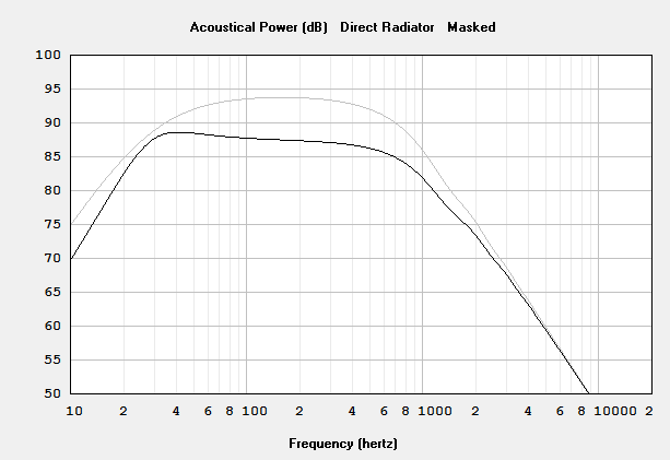

Right, we can have 'x' BW @ 'y' SPL or 'trade'/'exchange' less/more BW for less/more 'y' SPL, but not both at the same time, i.e. 'can't have your cake and eat it too', and as we 'slide' this 'X' BW backwards in time/going lower in frequency, so goes efficiency in lockstep if we don't increasingly narrow up its BW to compensate.
Well, with the closed box we can trade efficiency for gain BW by increasing the driver's Qts with 8 ohms of added resistance (attached) with the downside of it being a lot (- 6+ dB/200 Hz mid band) just to gain the modest hump down low, i.e. not many 'free lunches' in audio reproduction design. :headbash: :cuss:
