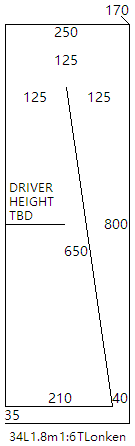

I think you'll want/need a higher taper ratio than 0.34, at least classical 1:5, possibly 1:7. As you say the dimensions 17x46x57 WxHxD don't really work for desktop; taller & much shallower? Start with your ideal dimensions including driver-center-height (and angle of tilt if any).

I think you once mentioned height is not a problem. Here's a simple idealized 34L 1.8m 1:6 TLonken (width 170mm; can adjust line-volume by widening). Driver near middle, ear-height.

Sorry, those numbers are not right. That's in error, as I did not account for the taper in the 2nd and 3rd segments. I'll have new corrected numbers soon. I would really appreciate getting my numbers checked
Following Patricks tutorial, the "easy way", I am getting 66%. I am trying to get the pulse of the forum, it seems that there must be a problem with the 34% reduction method and tutorial as everyone including yourself is suggesting something other than thatBob Brines' ppt slides give somewhat different dimensions that yield these line-volumes: Straight-TL 100%, TQWT 70%, ML-TQWT 62%, ML-TL 57%, down-tapered-TL 51%.
I did mention. I can fit taller than a metre easily on the desk. I don't know if I can live with it, though. It's a very tall box for the desk. There must be something wrong with my calculations. I am getting 54 cm as segment length after calculating 34% reductionI think you once mentioned height is not a problem. Here's a simple idealized 34L 1.8m 1:6 TLonken (width 170mm; can adjust line-volume by widening). Driver near middle, ear-height.
Combined internal dimensions of width 14.4 cm x height 38.2 cm x depth 54 cm (not accounting for 9 mm MDF). The 34% reduction method is resulting in a box that is goes from 54 cm deep and 38 cm tall to 54 cm tall and 38 cm deep if stood on its end (if that is ok to do)
Is this a discrepancy in the reduction method, my calculations? If stood on its end, the result is a shorter box then other suggestions
Btw, I am not discounting your suggestion. I am trying to see if I can drop that height from 80 cm to under 60 cm without changing segment lengths. I can do it with if I change the bends around a bit
