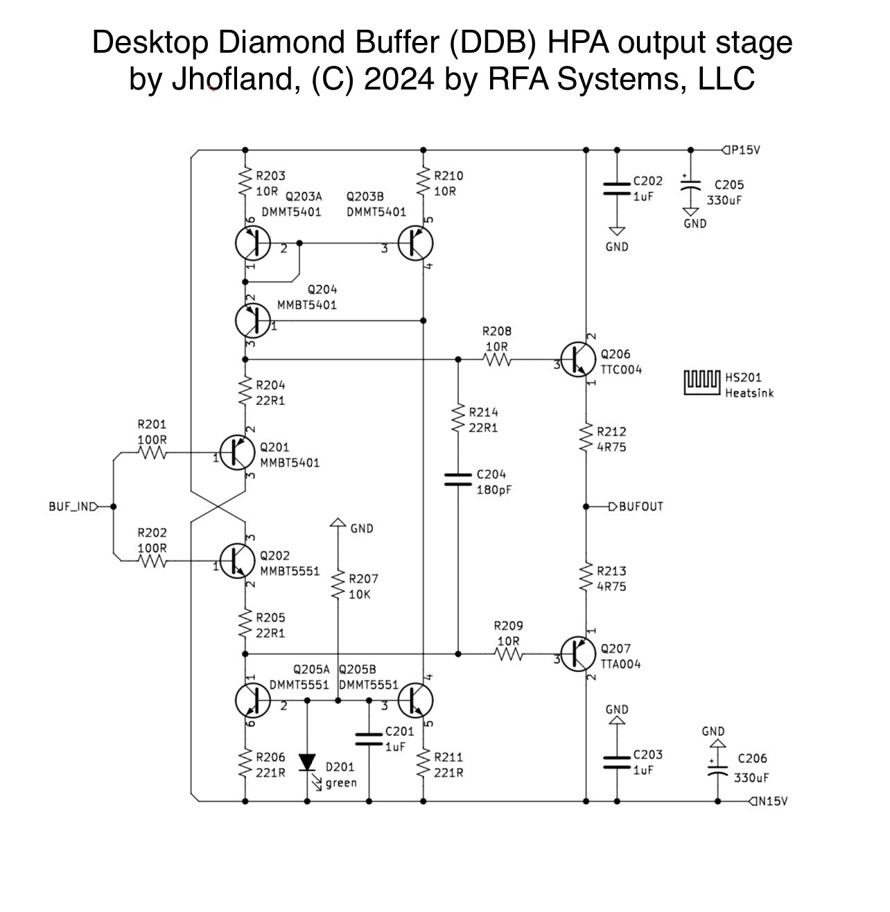

It might be that your transistors HFe’s are different.
you can cut the value of the large emitter resistors R212 and 213 to half the value (2.2R) to double the current. Or change the resistors on the front end to increase the bias current (preferred way).
Perhaps @jhofland can chime in as to how to fix this.
It might be that R204, 205, 206, 211 could be cut in half to double the current in the front end?

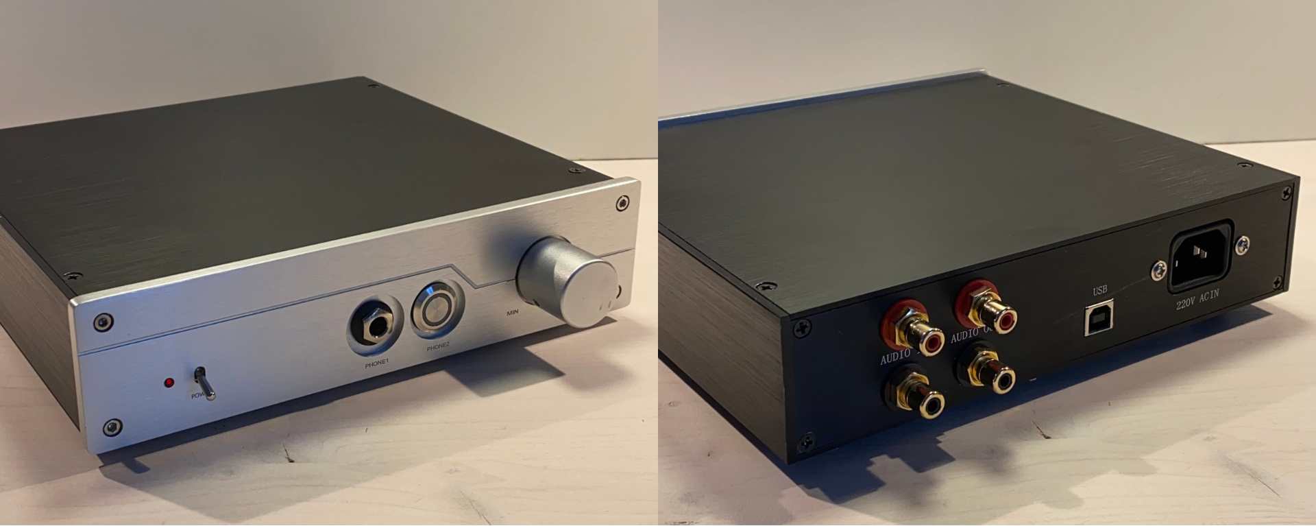

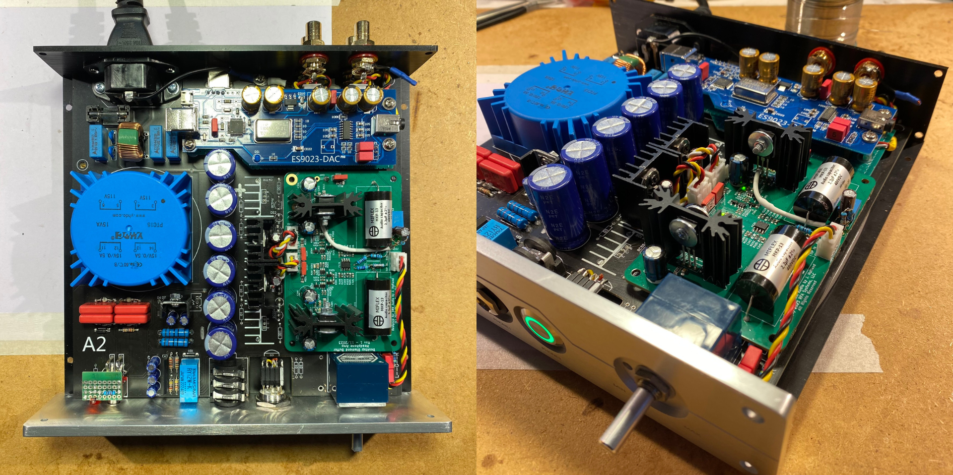

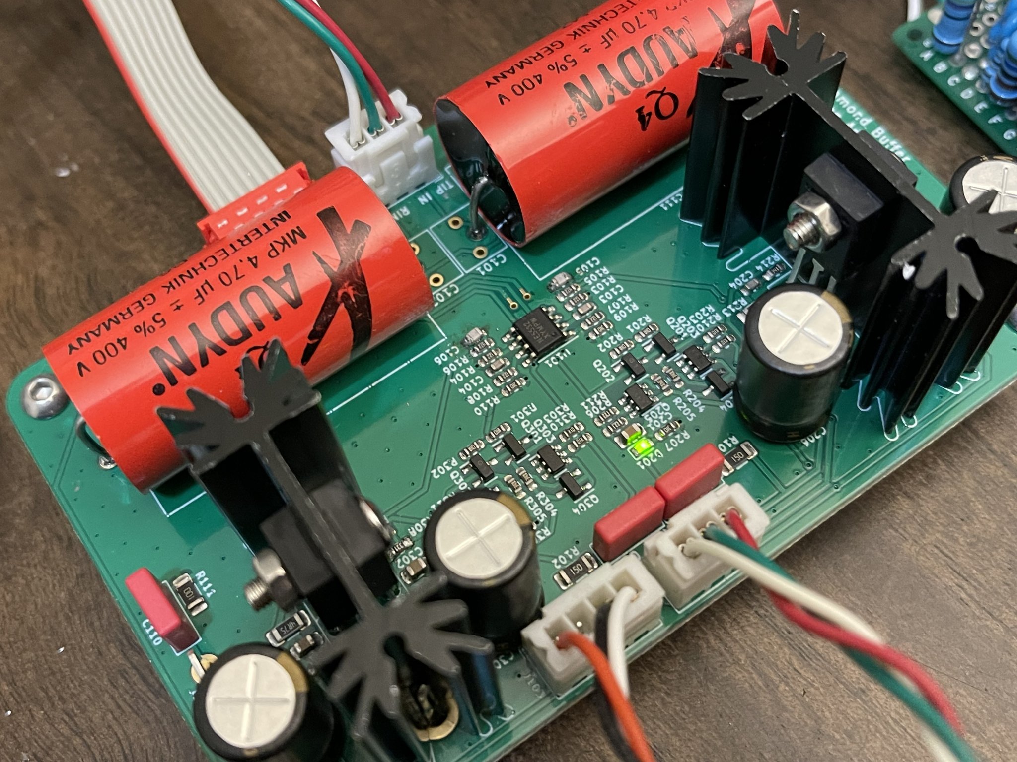

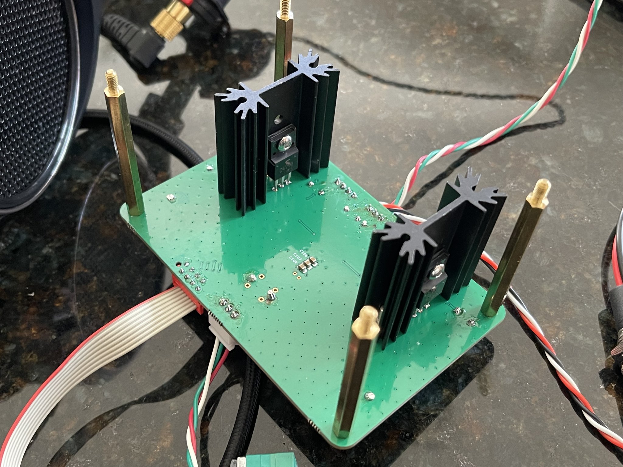

The DDB board found its place inside an inferior project from a kit I picked up at Ali/Bay. I was about to take out all reusable components and ditch the rest when I came across the DDB thread. The DDB board dimensions were fitting the space for the amplifier section so perfectly that it looked like being designed just for this case. Miracle! I kept the PSU (modified to CRCRC), the protection, DAC and self-designed input switcher in their places and added the DDB board instead of the former amplifier section. Works now perfectly both as headphone amp and pre-amp.
The photo also shows some odd point-to-point additions on top of the DDB board. Those were necessary for removal of DC offset on the output. Since my DDB board came pre-populated with NE5532, the volume pot could not be connected to the board in the same way as in case of the FET input OPA1642. Rewiring the pot wiper connection to before the input DC blocking capacitor expectedly resulted in higher DC offset. I had negative ca 60 mV, which was in agreement with what simulator had told me. The added positive voltage injection network now keeps the offset within 2 mV.

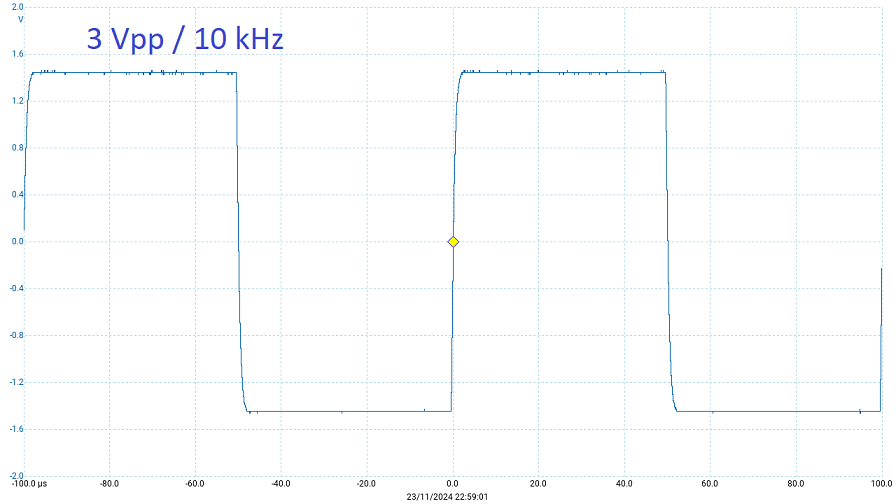

I also had to retain zobel on the output even though simulator indicated no need for it. I tried the board without the zobel but got small scale local HF oscillation (~80 mVpp) somewhere in the circuit with nothing connected to the output. I did not dig further to find out.
Step response is perfect in my view and the waveform remained undisturbed with any capacitive loads (I tested up to 220 nF). Note however that I am also using 2.7 Ω output resistor which does improve load immunity as well.

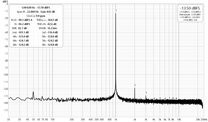

The THD measurement was in full alignment with your results - the 2nd harmonic dominates, there is a little bit of the 3rd but the rest stays in "grass". Below is 1 VRMS into 33 Ω:

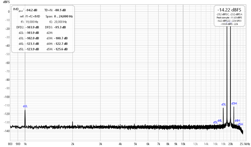

Since my gear cannot reliably measure HD for higher frequencies, I resort to CCIF IMD. Same 1 VRMS into 33 Ω. Looks good to me:
Overall, very happy result! Lots of new learning and experience. DDB created the best thing possible out of otherwise miserable project.

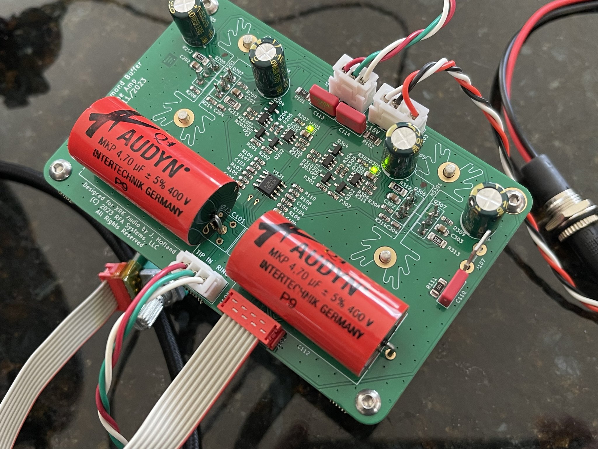

This amazing little amp has been discussed as part of the DB thread but I think it deserves its own thread given how it has quite different objectives from the Pocket Diamond Buffer (PDB) HPA.
This desktop variant uses TO-126 output BJTs with dedicated heatsinks and does not have the separate MOSFET rail switching needed for the pocket one. The setpoints have been optimized for a moderate 40mA nominal bias current that will let you run in full Class A operation for most headphone uses. It will leave Class A around 250mW into 32 ohms. Of course, you can adjust the emitter resistors to run higher bias currents. I have used it with +/-9v, +/-12v, +/-15v and +/-18v supplies and they all work great. It was designed for 15v rails but I don’t think performance suffers much from using lower voltage. For your particular use case you may want more voltage. High impedance 300ohm cans like more voltage, for example. There is lots of room for input cap rolling and I have used huge 4.7uF 400v MKPs and also smaller 0.47uF film to bypass 10uF Elna Silmic electrolytic caps.

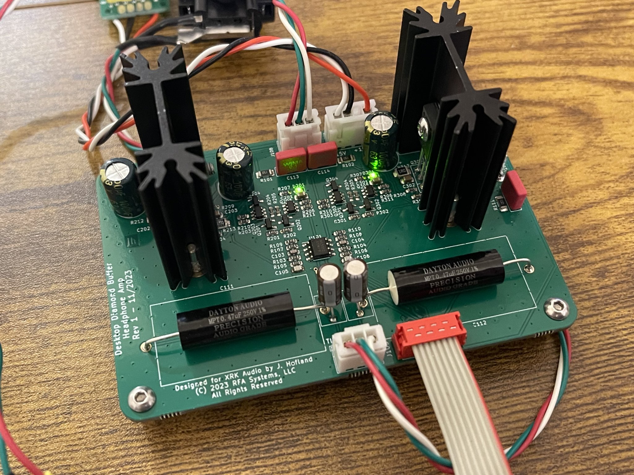

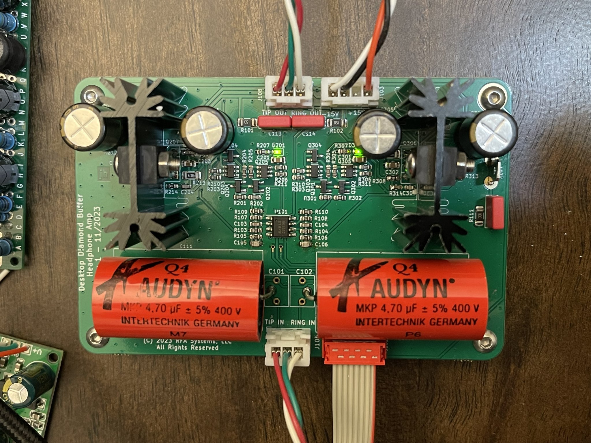

Here’s a photo of a built up amp board in operation:
With larger MKP caps only:

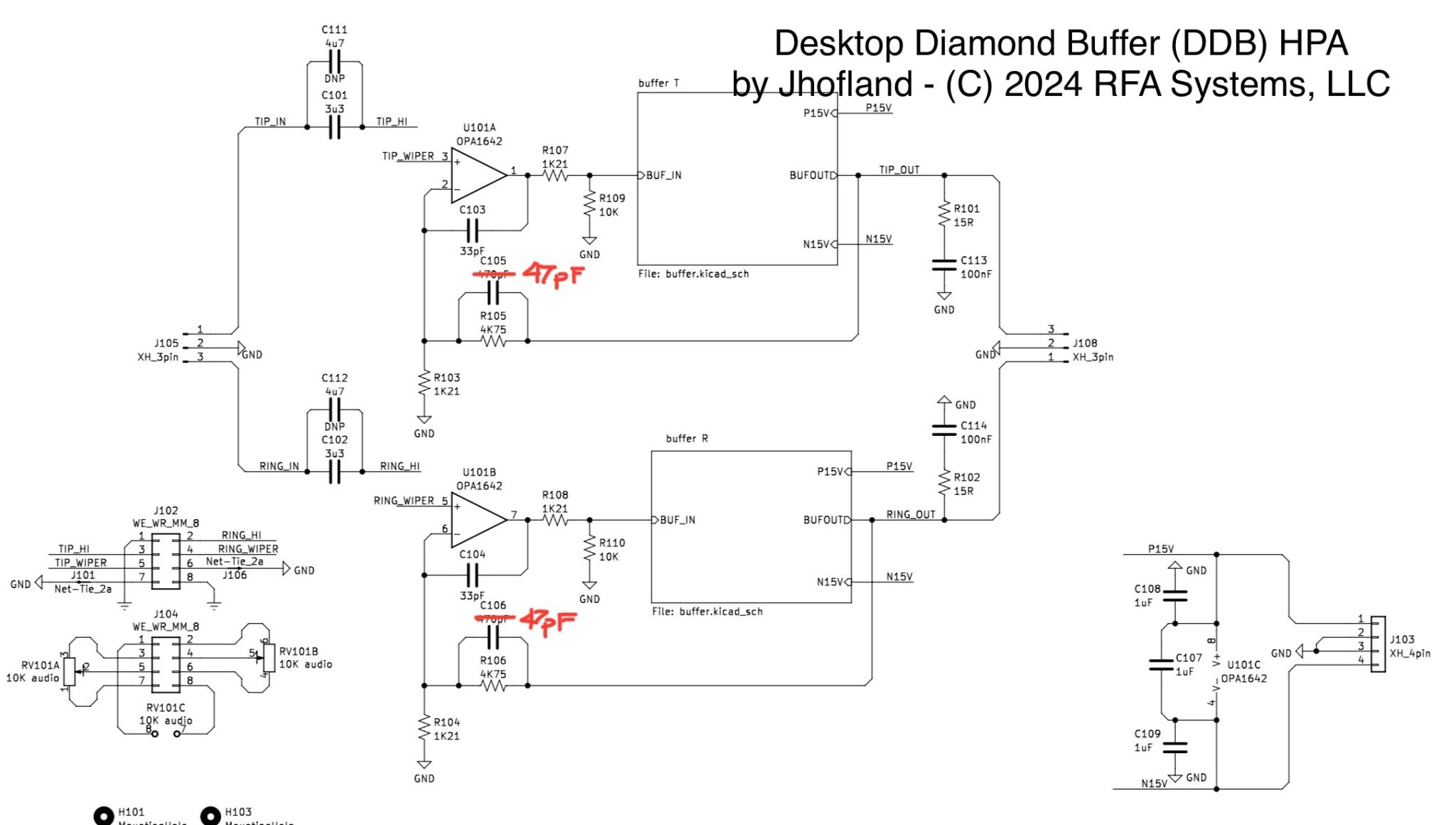

I initially struggled with an oscillation but chased it down to a feedback compensation cap that was too large. That’s all fixed now rock solid. A stability analysis on LtSpice pointed me in the right direction. So the schematic shows a 470pF cap needing to be replaced with 47pF. It’s an easy swap and I’ll do this on the SMT pre populated boards that I will be offering in my shop. I will also have bare PCBs for those wanting to assemble it themselves.

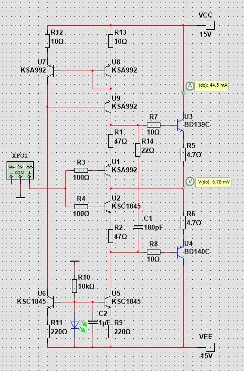

Here is schematic for the overall amp, very simple. Power supply in, audio in, audio out and volume pot with MicroMatch IDC cable to an RK09 pot helper PCB (included).
Here is schematic of the Diamond output stage:

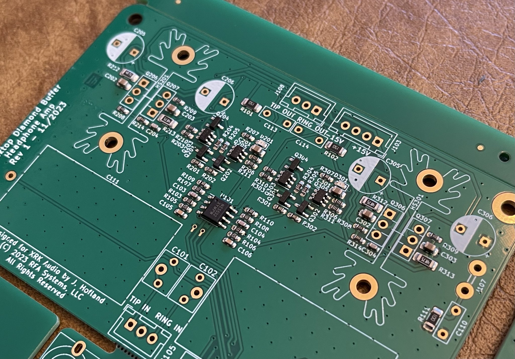

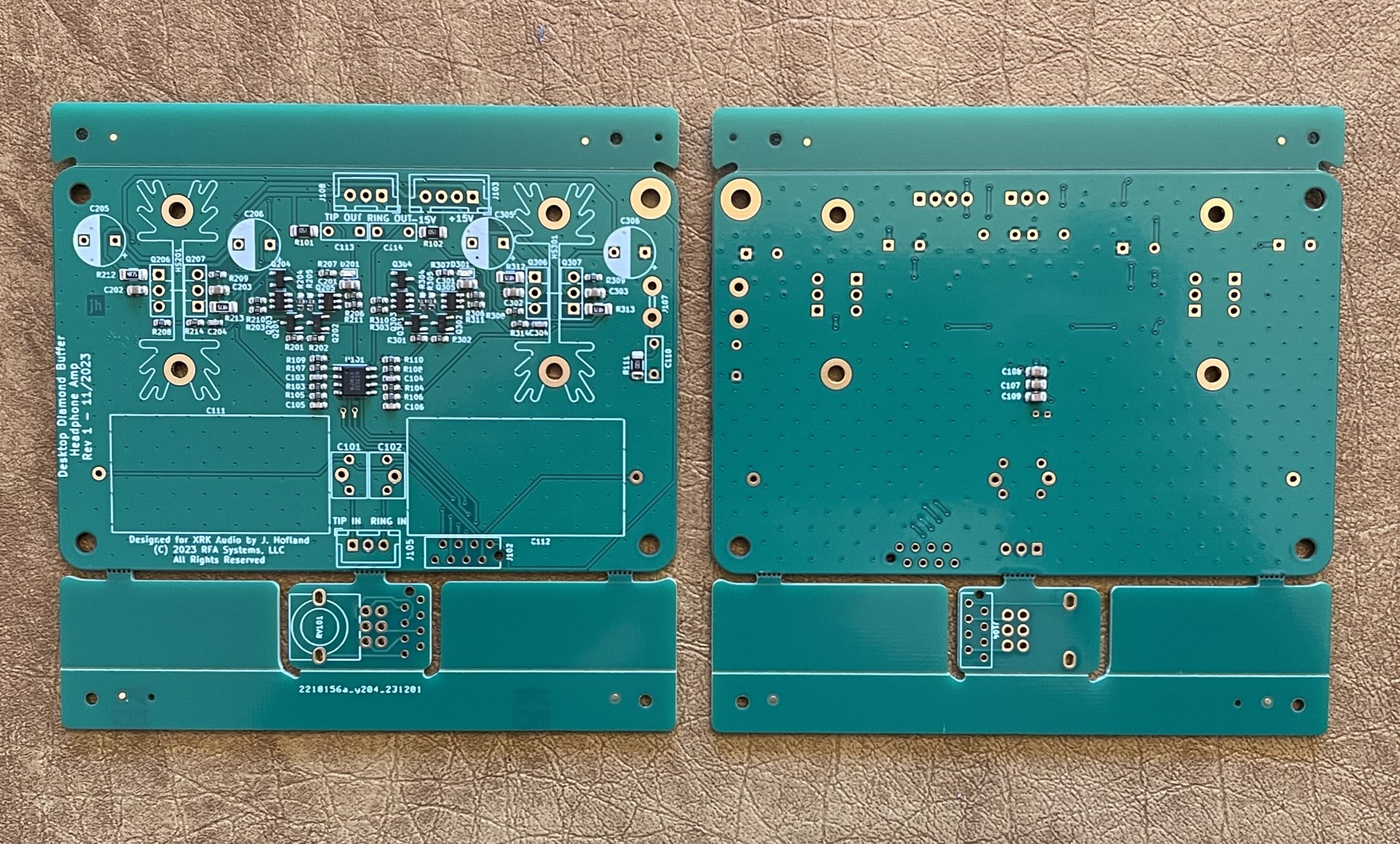

Here is a SMT prepopulated PCB so all you need to do is to install all the through hole parts:
Both sides:
Here is the board assembled with big 4.7uF MKP caps:

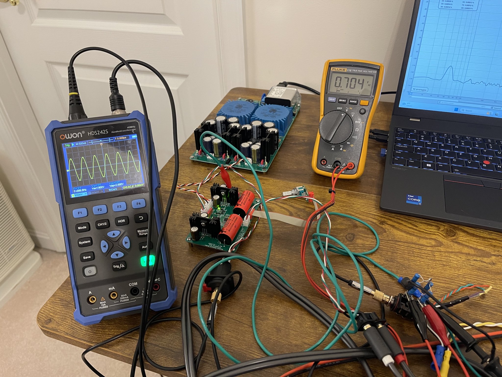

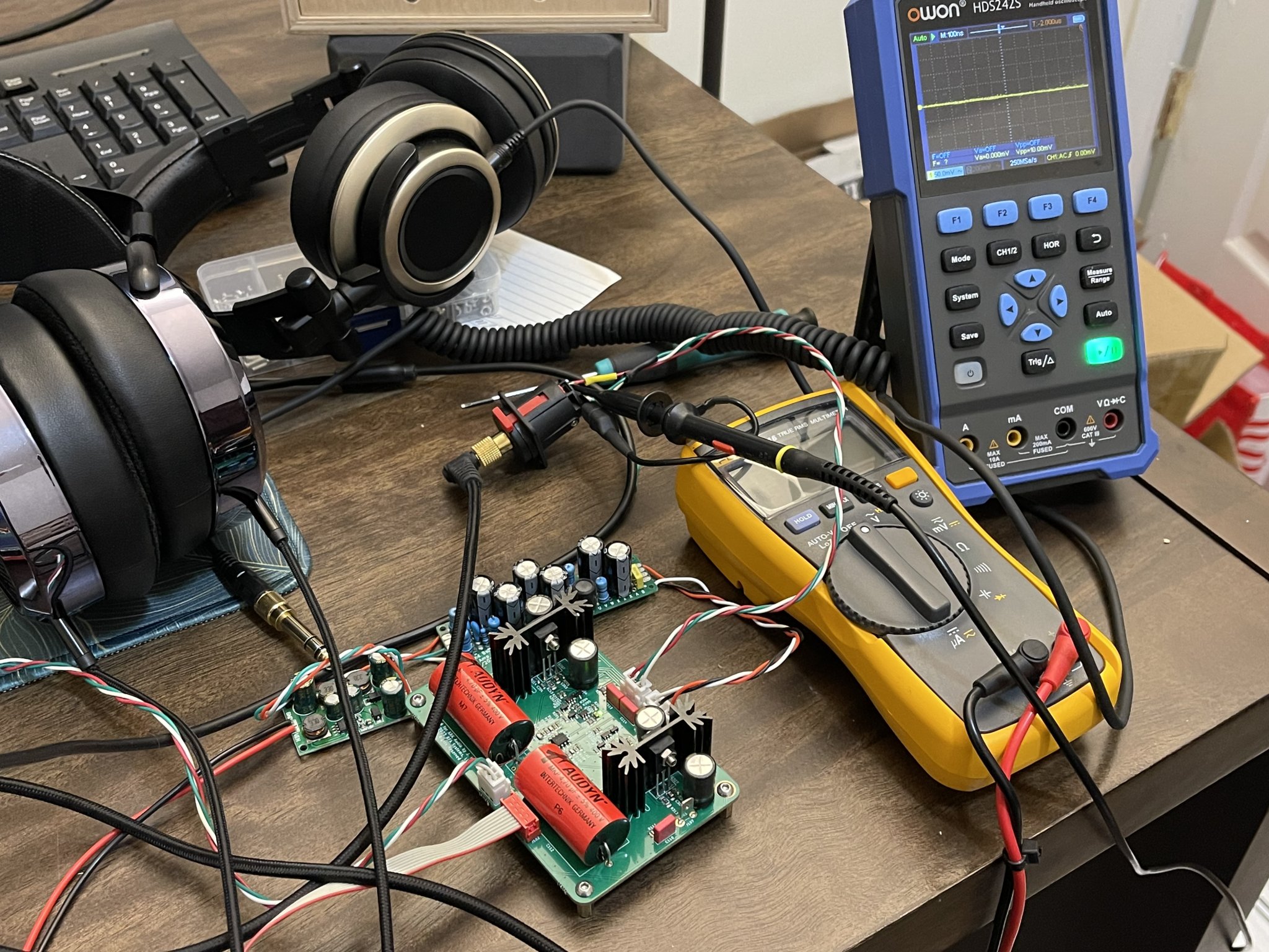

Testing on the bench:View attachment 1260872

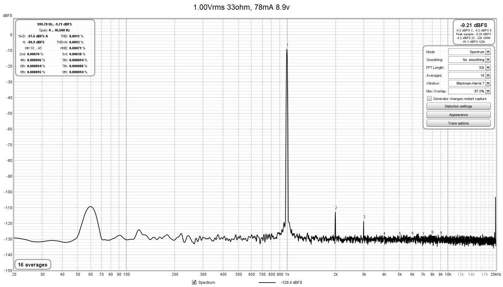

Nice low distortion but second harmonic dominant distortion profile for 1Vrms into 33ohms:
You will find that this headphone amp sounds very natural and clean, but has an incredible power reserve to deliver bass slam while maintaining great control authority of the driver transducer cone. It’s a wonderful headphone amp to listen to for hours. For normal headphone use (under 500mW power) basic AC/DC modules designed for delivering circa 350mA into 15v can be used with a 7812/7913 voltage regulator and it will work fine. You can also make really fancy PSU with linear trafos, cap multipliers, CLC, and low noise LDO’s etc. with a proper PSU capable of 750mA and +/-15v you can drive up to 1.5W into 32 ohms (for those fans of the HiFiMan HE-6).

https://www.mouser.com/ProductDetail/Vishay-Dale/TNPW12062R20DEEA?qs=vHuUswq2%2BswIE18TmZVkaQ==
Note that the heatsinks will get significantly hotter and the PSU also needs to provide more quiescent power.

When increasing the Bias current to 80mA, will this increase the THD a bit, but raise the H2 and lower the higher order harmonics ?
If you can find some new old stock of 2SA1837 and 2SC4795, they are better. But the TTA004 and TTC004 are modern BJTs that will perform better than you need. As can be seen in the recent measurements by nonills, it doesn’t get much better.
Pardon but another newbie question.
Yeah, that’s a great performance. And nice succession of harmonics.
The THD doesn’t matter too much to me, the above is perfect, but could adding a supercapacitor bank lower the noise floor more and get rid of the small ‘ humps’ below 1khz in the power section ?
