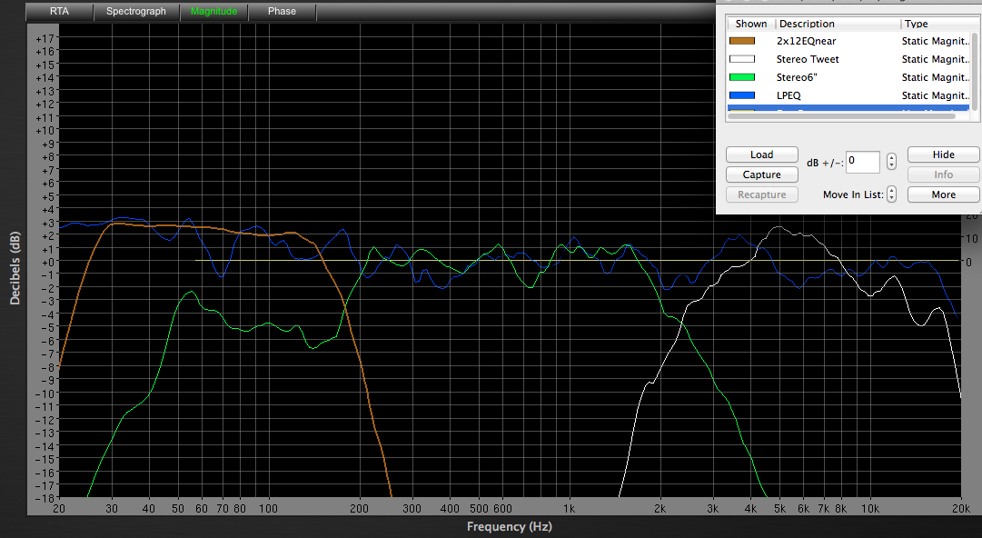

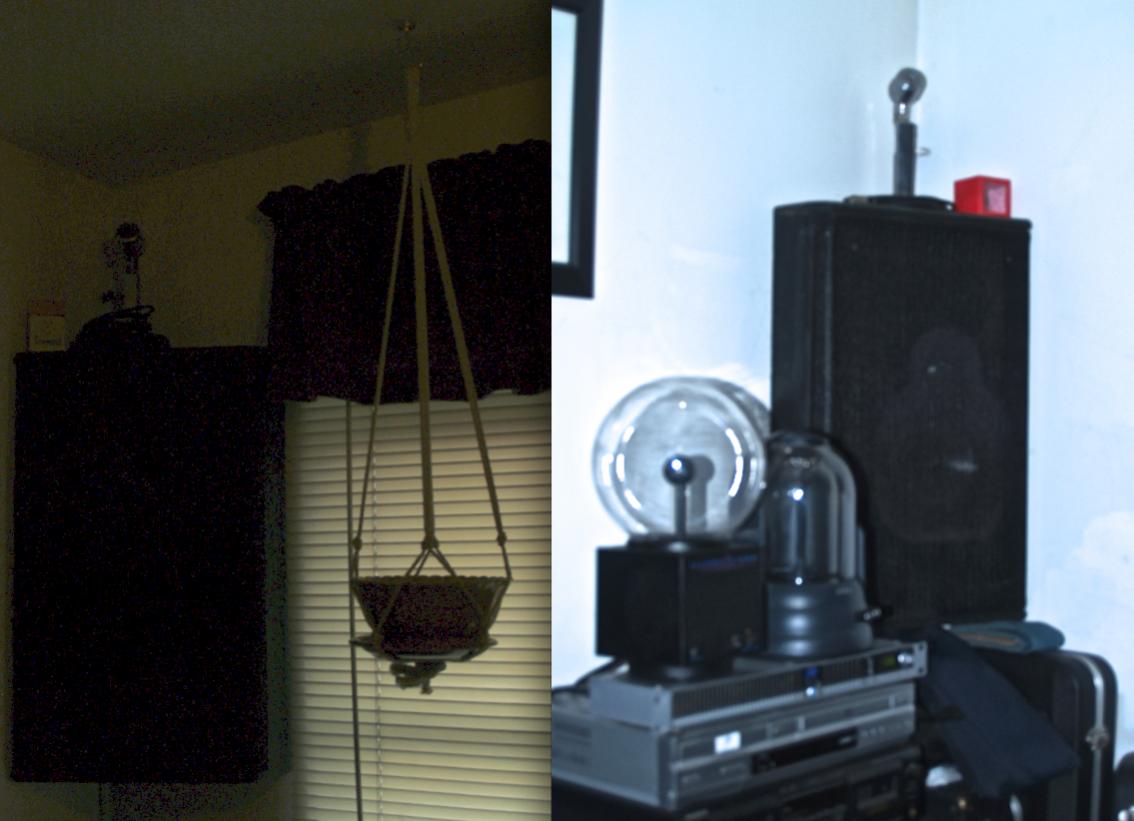

My home stereo speakers are sealed using an 8" and a dome tweeter in boxes mounted in the room corners. The boxes are 9.5" deep on the outside corners, 4.5" deep on the inner side, 14" wide by 27" tall. The corners and baffles are rounded to eliminate diffraction.
The measurements below show the raw response of the 8" (green) at about 6" distance and the tweeter (white) at the same distance with their respective passive crossover filters in place, and the sub output (orange) also measured very close to the exit.
The blue trace shows the combined response with EQ at the center listening position near the room center.
The EQ used in the area of interest concerning this thread is -12 dB at 63 Hz, +1 at 80 Hz, -4.5 Hz at 125 Hz, and -6.5 Hz at 160 Hz. The response only varies a few dB over the width of the couch.
At any rate, the "suckout" due to the distance off the wall still seems to be apparent even though I had hoped the "pseudo soffit" speaker baffle would have mitigated the problem, but the end result in the room comes out pretty flat when the L/R and (center) sub are all integrated.
I also found that the hanging pot (normally containing a Jade plant that has been placed behind the drawn window screen for the summer) and the globular plasma discharge units had no measurable effect whatsoever on the response at the listening position, the traces matched almost identically when they were removed.
Aesthetic features without negative acoustical consequence was a welcome test surprise, since Bonnie would not be happy with the potholder anywhere else, and the Illuma Storm and Lightning Fury were positioned for acoustical symmetry ;^) .
