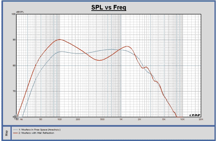

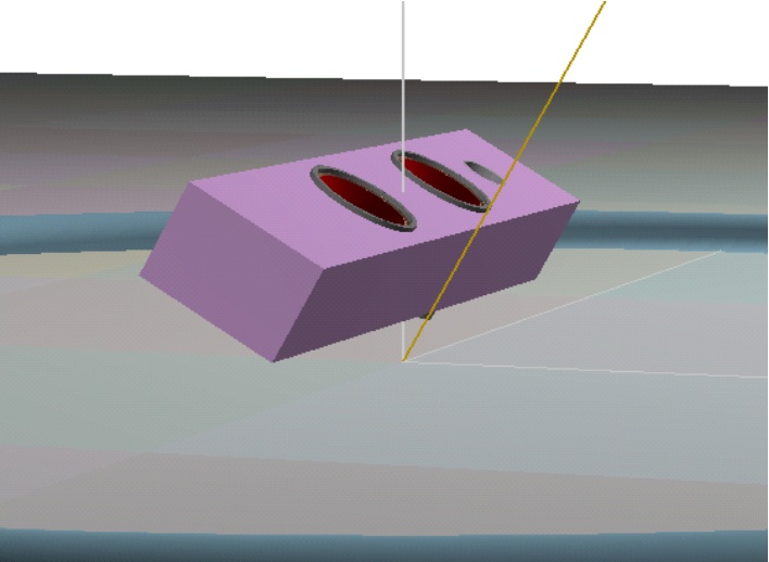

For those that are interested, I started the VS design with a model in the the excelent program Leap, Cabinet Shop. It lets you define a cabinet's dimensions and it does a full diffraction based model. It also lets you apply boundary conditions so I placed the unit in front of an infinite wall and it would then simulate the reflected image unit and the interference between the two.
The image shows a simple square box with two appropriately sized woofers. The system is angled inwards and all simulations and later measurements are taken on a 30 degree inwards axis.
The two curves are of the simulated woofer box combination in free space (the dark curve) and the same system simulated against the boundary. You can compare these to the real measurements in the previous post. Correlation is quite good.
Note that this is the woofer response only (a low pass network is part of the model). You can see a hint of the upper frequency nulls but they are very minor and are in the stop band so the tweeter would hide them. The first dip is the primary concern.
This was an onwall "plasma TV" speaker, but a bookshelf system near the wall would give identical performance but with the dip at a proportionally lower frequency. Different cabinet tuning could help slightly but, really, EQ is required to effectively deal with the wall bounce.

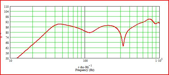

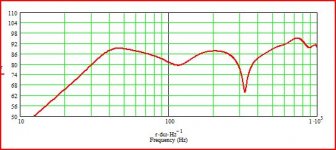

This is a question bothering me too.(to remove back wall dip).
Here is too picture. One pure simulation without wall and foor.
And the other is with boundaries.
That 300Hz dip is from the floor and that wide one in 120hz is backwall, and it is WERY audible
VP

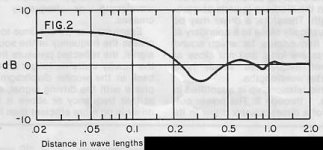

According to Roy F. Allison's 0.3x wavelength rule for suckout, that would be around 180mm - 200mm for that dip.
Very good. It is simply related to the distance between the source and its reflected image source.
At a frequency where the source and its reflection are half wavelength delayed they cancel and give the null in the curve. With a 1/4 wave spacing off the back wall the reflected speaker image is exactly 1/2 wave behind the source at the frequency of the null. (1/2 wavelength delay = maximum cancelation.
Allison was calculating the power response of a woofer against a boundary so he was integrating around a sphere. That is why he shows a dip at 0.3 wavelengths off the surface rather than the usual 0.25. 1/4 wave at 500 Hz is about 168mm.
Finally, since my simulations and measurements were done at a 30 degree inward angle you should divide the computed distance by cos(30) so I would calculate about 190 mm from woofer to wall to give the 500 Hz dip.
