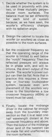

Allison was calculating the power response of a woofer against a boundary so he was integrating around a sphere. That is why he shows a dip at 0.3 wavelengths off the surface rather than the usual 0.25. 1/4 wave at 500 Hz is about 168mm.
Allison's article was "Influence of Listening Rooms on Loudspeaker Systems" from the late 70s or early 80s.
In a nutshell, the location of the drivers in relation to the boundaries, selection of crossover points were important to overcome the suckout. In addition it highlighted the need to keep all boundary dimension very different and not a direct multiple of each other as was shown in Fig1-3 where all dimensions are the same.
I've added these parts of the article for reference as it is useful in design and placement.
Thanks for the clips they are indeed relevant.
Let me explain a little bit about my comment on the 0.3 wavelength and clarify Allisons three curves.
The key phrase is that he refers to "power output". Power is different than pressure or SPL, in that it seldom means at a point in space but is usually an integrated quantity around a system. The three curves of Allison are calculated by considering the response in all directions for a driver a given distance off of a surface.
Now if you come straight out from a surface the reflected image behind the surface is the maximum distance from behind the real speaker that it can be. It will be twice the distance the actual speaker is from the reflecting surface. If the real speaker is 1/4 wavelength above the boundary then the image is another 1/4 wave back, the units are 1/2 wave apart and complete cancelation will occur (and yes, bbggg is correct that you would have to factor in a little distance for bending around the baffle width itself).
Now if, rather than perpendicular to the wall, we go off at an angle from the wall we will see the distance between the source and its image diminish. We will go off on a diagonal and the diagonal distance between source and image will be diminished by the cosine of the angle. For the 30 degrees I mentioned it will be .866 of the true distanace to the boundary (times 2). As we increase the angle, and at the limit, we will be moving down the surface of the wall and the distance from the listener to source and listener to image will be exactly the same. The cancelation null will have moved up to infinite frequency, i.e.a little out of band. (Ground plane measurements, anyone?)
The reason this matters is that Allison is calculating power response, so he has to integrate all of these curves for his one power curve. He would be integrating the straight out curve with a null at .25 wavelength all the way to the plane-to-the-wall curve with no null at all.
In fact he shows three integrations with 3 different sets of limits. The single boundary case has the most washed out features and just a vestigal dip considerably above the .25 wavelength frequency. That is because he has to include the wide range of curves from 0 to 90 degrees in all directions and as he adds the curves near the single boundary the cancelation nulls are so much higher they wash out the original .25 wave null.
In the case of 2 boundaries he has to now consider the source and 3 images (the side wall image speaker, the back wall and the between-the-two reflected image speakers) and he is more constrained in how he can move around them for his integration, since he eventually runs into the side wall or back wall. For two boundaries you see more LF level since at lowest frequencies you have the in-phase summing of 4 elements, one real and three reflected. Additionally, the null is stronger and a little lower in frequency because of the angular constraint.
The final case is of a woofer in a trihedral corner, i.e. near 3 walls (okay, 2 walls and a floor). There are now 8 sources to consider and only 1/8th space to move around to solve the integration so again we see an increase in ultimate bass level and more dramatic wiggles in the curve with the null getting much closer to the .25 wavelength frequency.
The philosphical question is: which pertains to us or do we care about the power response at all? Considering the power response is a bit like asking "if I have an audience full of people, what is the average effect on all of them?" In truth we will sit at a particular position and will only care about the frequency response at that particular spot, so the SPL based on the diagonal distance is the relevant curve. Based on that the null at the frequency where the source is 1/4 wave off the surface, divided by cosine of the observation angle, is what we need to deal with.

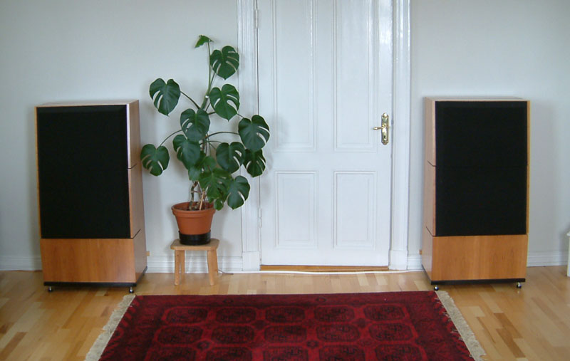

In the past, practically all living room loudspeakers were placed near the wall. Many speakers had back side so ugly it was never meant to be seen.
Then something somewhere went terribly wrong and suddenly near wall placement was no longer allowed in domestic use but speakers had to be placed far from walls blocking the walking pathways, complicating placement of other furnitures and otherwise breaking harmonious home decoration.
That was the era when high-fidelity had entered.

There are plenty of examples from the UK. I'll refrain from comment on their "goodness", but virtually all speakers from Linn and Naim were designed for placement against the rear wall.
But none of these were designed for near wall mounting in the way we are discussing: able to remove the effects of the back wall bounce.
All will have the large dip from dual path lengths.
