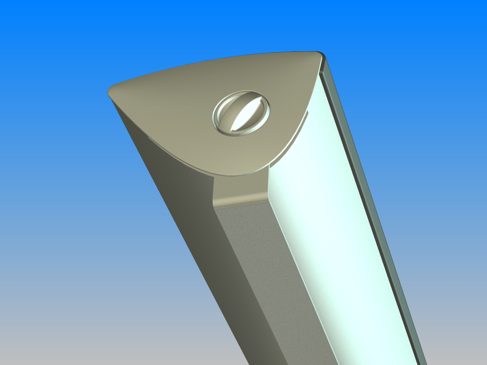

I designed an onwall system at PSB (the VS300) that had a switchable EQ for the rear wall bounce. Relative to the free field performance the on wall measurement was up considerably at LF with a strong dip at 200Hz or so. The rear wall dip was easily audible, as was the bass rise.
The trick was creating the EQ with a passive network. I ended up taking advantage of the 2 1/2way design and gave the lower woofer 2 very different rolloffs.
For this to work you need to have a fixed distance to the back wall. That would be the case for an onwall with its own bracket. (Not necessarily for a bookshelf speaker and stand "kind of" near the wall.)
The VS300 worked very well and was elegantly finished, yet never a big seller. 🙁

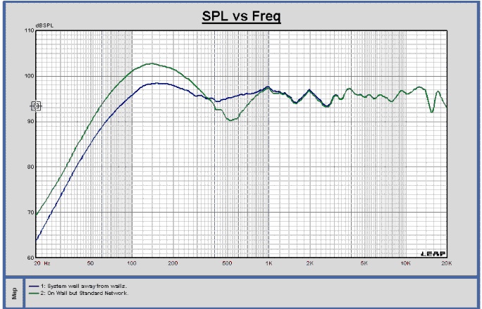

I found some curves for the VS300 with wall bounce correction.
The first curve shows the response of the system in free space and against the wall. Blue is free space and green is on-wall. Lots of LF lift from the boundary but at 500Hz the reflected source is 1/2 wave behind and heavy cancelation occurs. The curve is fairly wide as well as deep and was clearly audible as sucking the midrange out of voices. Note that there should be higher harmonics of cancelation but they are fairly minimal since the system directivity is rising.

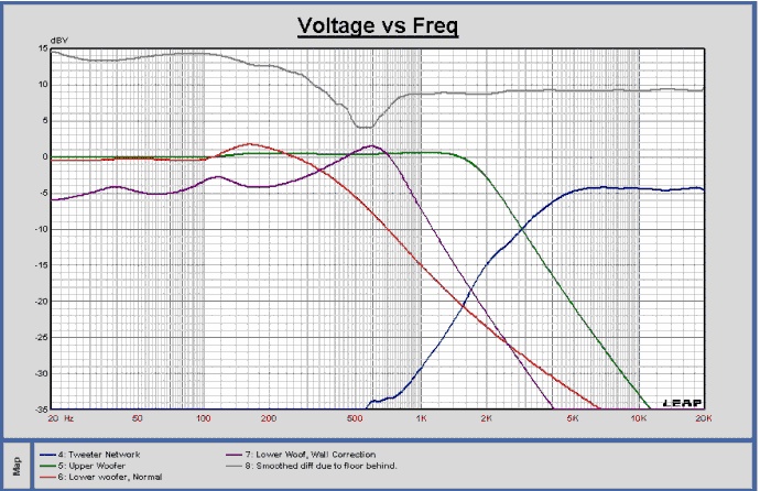

The second curve shows a few different EQ curves. At the top is a gray difference curve between the 4 pi and 2 pi responses. The EQ needs to be the inverse of this curve to fix the on-wall response. The fix I used was via the 2 1/2 way woofer networks. Green shows the upper woofer response that never changes. Red and Purple are the "lower" woofer responses, achieved by network switching. Red is the normal free space or 4 pi response. Boundary correction comes from the Purple curve.

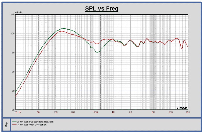

The final set of curve shows the on wall response without correction (green curve) and the boundary corrected curve in red. I didn't fully drop the bass response to flat (nobody complains about too much bass😉.)
So there, it can be done. But remember that it only makes sense if you can guarantee that the boundary location is fairly consistent, as it would be with a wall bracket mounted system.

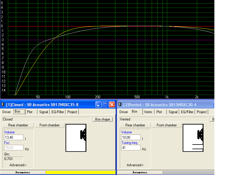

Here is picture of two different bass alignments. Another is fairly simple closed box Q 0,7, might integrate for room gain if gain begins quite low. Another is low tuned BR with low Qts driver. It has "bass tilt" which can be good if wall boosts higher than just natural room gain.
What do you think?
