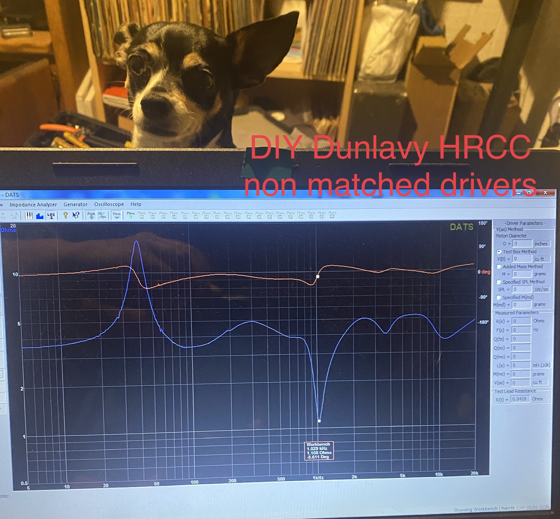

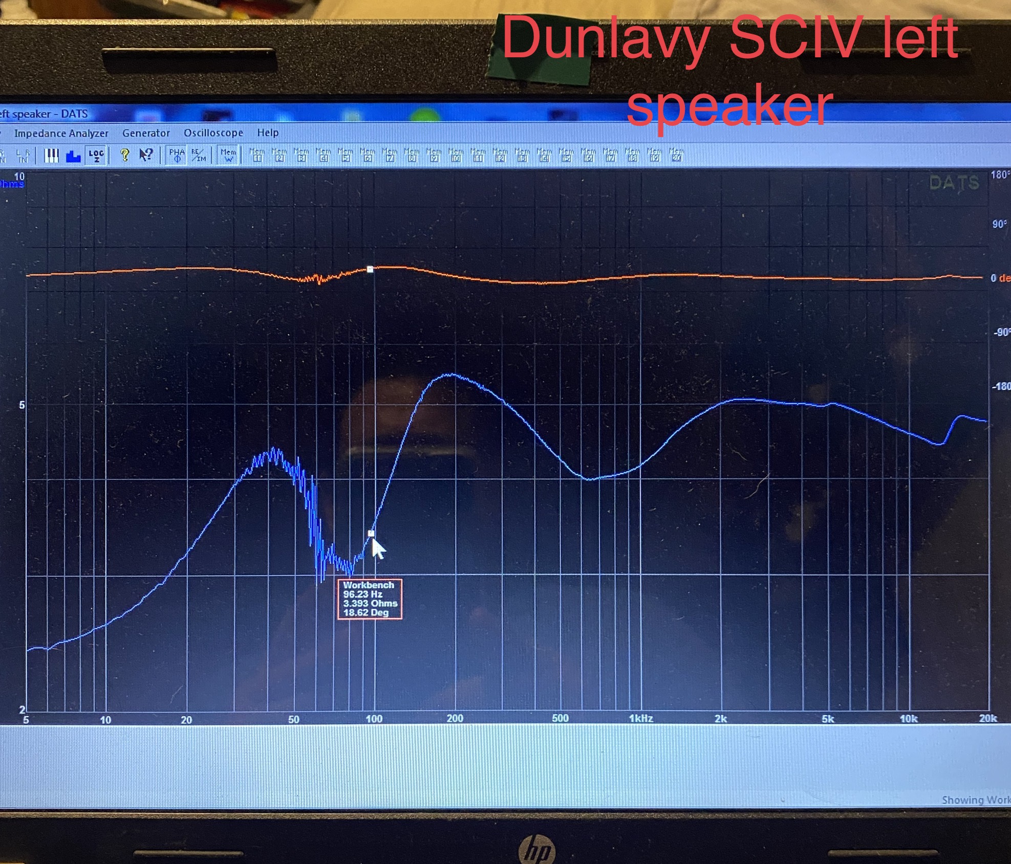

Top image is one of my SC-IV run on the dat 3.
Bottom image is of my home built HRCC.

Phase is not nearly as good as DAL built speakers..
I understand this is just electrical phase but it shows detail to design.
