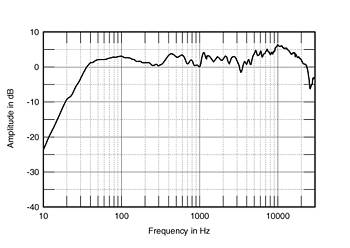

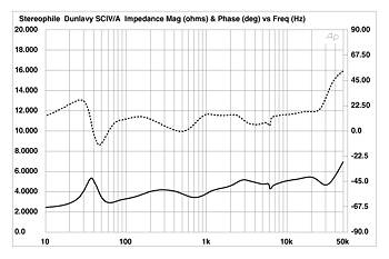

Measurements here:
Dunlavy Audio Labs SC-IV/A loudspeaker Measurements | Stereophile.com
Impedance:
Frequency:
Impedance:
Frequency:

@xrk971 Did you notice that large CTC distance for the mids in this design? Any idea what
might have been the reason? Seems like they could have been 2-3" closer.
I saw JA's measurements but it would have been nice to compare to some done at the NRC.
