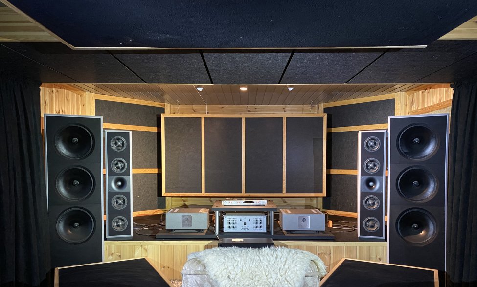

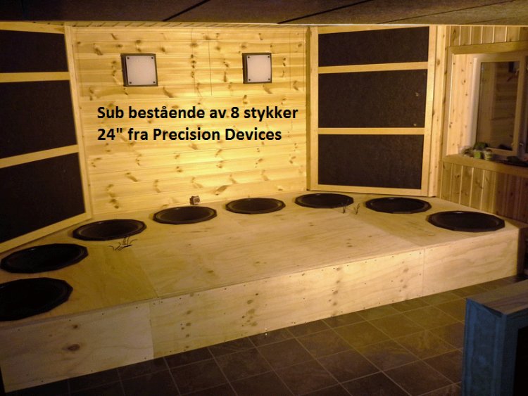

Yup... it's wild. I went with a friend of mine - last in August - to visit him, and I can assure you.... it's an experience for sure. The stereo image is spot on and everything is super clear, where it all just works! Great voices and enormous weight to the soundYeah... take a look at this one, all DIY, the subs are 8 driver 24" subs in what I think is 2400 liter total cabinet volume, for midbass there is 6 15" drivers .... pretty way over the top
Heard some classical music with cannons.... and simply put - protect your ears .... but still sounded great.
He liked a bit more bass than I normally prefer. But he had several filters ready, which when changed, quickly made me give him a thumbs up
The system had that sweet clean hifi stereo image, that I like. Going for horns, to play this loud, is for me a bit too "in your face". I simply prefer the higher coverage of sound - wider dispersion. Compression or loaded drivers surely has a great and effective coupling to the air, but to me, it becomes somehow too much. So this system is definitely some of the best I have heard
The first system I've ever heard, where a FIR based filter was used, and I did not think about it in any way
Also, rather impressed with the way that the 4x Morel midranges and Bliesma tweeter integrated
The Duntech Sovereign PCL-2001 used the Dynaudio 30W100 I believe? Not sure if there is a modern equivalent?
