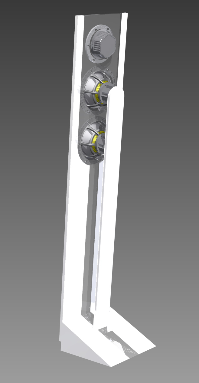

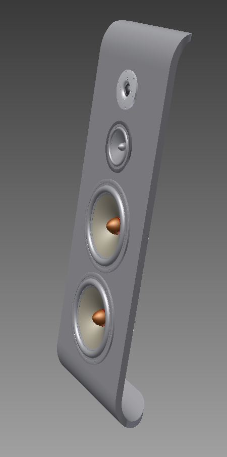

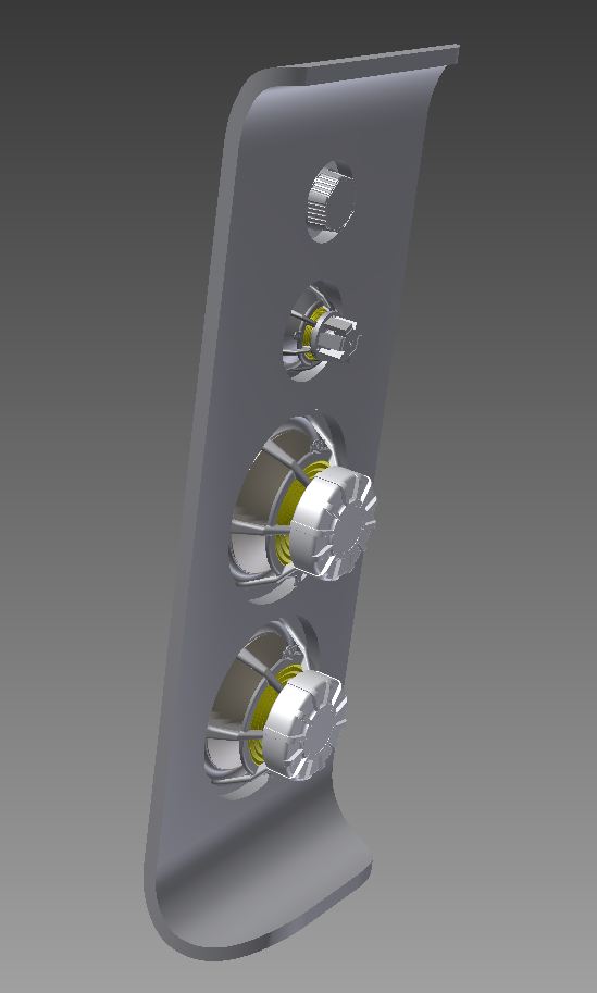

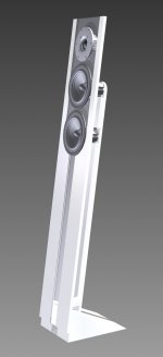

Here is how stuff looks now!

Baffle diameter issues
Intended to comment on the baffle width issue earlier. Panomaniac makes a good point. It is well documented that as the baffle narrows, the effective low freqency cut off rises and low end bass radiating efficiency diminish. S. Linkwitz describes the physics in great detail at his site Linkwitz Lab - Loudspeaker Design.
My guess is that the baffle prototype - example is around 15" wide and would yield an F equal of around 180 Hz and a -6 db point of around 90 Hz assuming no crossover correction. Some sort of sub would definitely be required. As Pano points out, wings can help, lowering the potential F equal to around 110 - 120 Hz or so before we get into distructive cavity resonance issues.
Jamo gets around this with a baffle width that is deceptively wide and trades woofer efficiency away to achieve bass extension. With a pair of 15" drivers on approximately 20" of baffle width, you can make it work. Part illusion, part driver-crossover manipulation.

That's a nice looking baffle, but I doubt you'll get much low end out of it.
Put a pair of clear wings on the back and you'll get better bass and stay very close to the original look.
Agree - no serious bass ever will happen with such a "sled design".
Okay, so if we have that settled, i can just drop the woofers and go with double midtones instead, leaving the lower range to a dedicated sub?
Doing this would make it possible to go for a thiner more elegant shape, and also keep the "speaker" look.
Everything is very "open" right now, and i feel that it can go anywhere i want it to, depending on where the driver setup and sound needs it to go.
