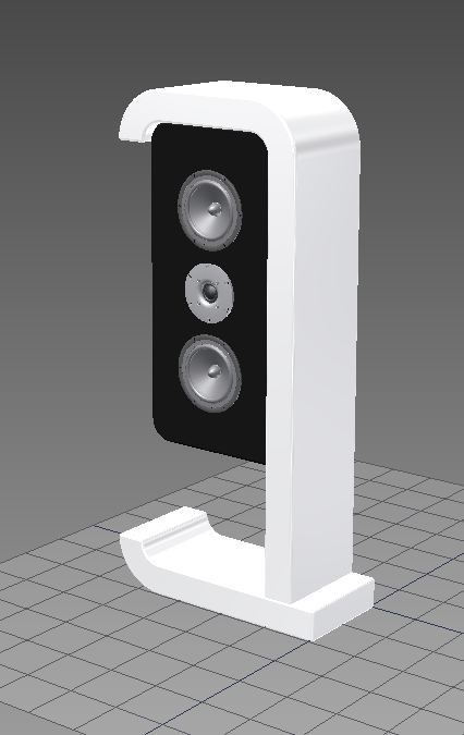

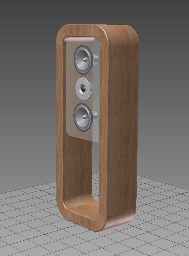

Whats not good etc? i need something to work onwards withimo not beatiful. looks like first year..
And i kinda agree with you also, its to much a normal speaker and that was not my goal in the first place.
I wrote "imo"
previous shape was good enough\beautiful. this isn't.
this is like first (not 5th)year work. unconvinced mix of triangle\semiround\strips..
your teachers 5years told you that I can not write in English for 5 minutes..
+ relatively thin plexy driver's board may vibrate..
Yeah but you opinion mattersI wrote "imo"

I get your point with the shapes and stuff and i agree! Back to the drawingboard
good luck!
you'll can draw less if you decide what drivers will be used
interesting game with shapes\materials for boxes(or ob). I would have played..
but my system is flushwallmounted and will (when be finished) be like wall (either simply white or m.b. wooden panels) . exept drivers, of course.

Plywood is widely accepted - so no problem.
Fiberglass, Kevlar depends on shape (thickness !) - IMO no good for flat panels like here (better with deep curved shapes like horns)
Corian I have no experience with. After a short research on the web it seems to be a blend of Acryl and mineral filler. So I think the good / sonic neutral dampening properties of Acryl are preserved and from that it will be a pretty good material to work with. Bang for the buck (including workmanship and finish) you have to check yourself.

... but it is purely ornamental. In no way is the form following the function. This happens all the time, when designers don`t really understand the working principles of the products they are "designing". They degenerate to pure stylists.it's not first year design
I wish Zepticon would first put more effort into better understanding "what" he is designing than "how" to design it.

By this, you mean that i should focus more on getting a good speaker, than getting a good looking speaker? Thus an OB speaker, needs to be with a large baffle to accommodate the lower wavelengths?
Unfortunatley, i dont have the time, and resources to experiment with this, like i feel i should to do it the best way. As i have read, alot of the design process is going on in the workshop, both with the speaker placement, size and with the crossovers.
But, i appreciate your feedback. It gives me a new perspective to look from.

If someone is going to design a car, he/she should know why a car has four wheels. There are a lot of aspiring automotive design students who actually can`t explain why 3 or 5 wheels (usually) are worse than 4. They only know that 4 wheels is what they should aim for.
Same for OB speakers. If you don't know what makes the difference between a closed box, a closed box without a back and a clean open baffle, you don't have the freedom to really find new solutions. You can only "design" "old clothes with new garments". That's what I would call styling.
Surely you don't actually have to design an acoustically perfect speaker - you are not the engineer. But you should be able to avoid design propositions that prevent good engineering.
