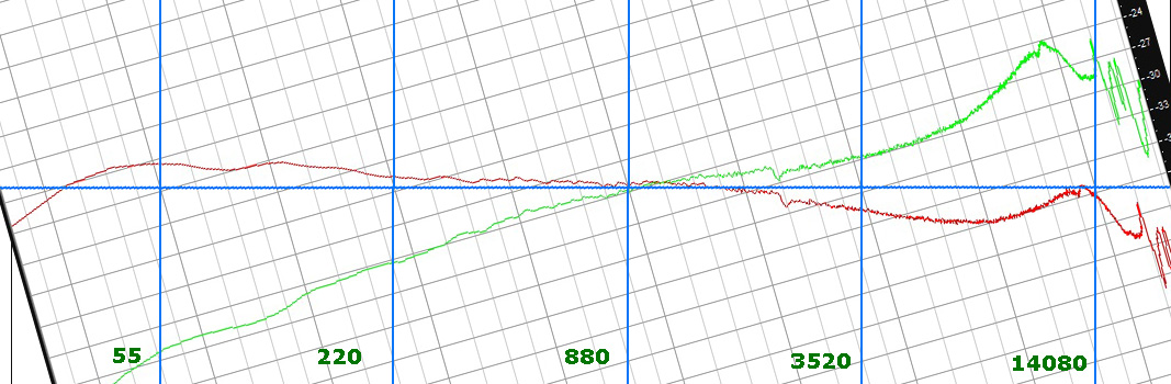

Scott, could you divide the flat gain trace from the RIAA preamp to normalize out the "imperfect pinkness" and mask the resonance at 14K? Just a thought, not a request.
I could, I'm set up for a round of measurements. I just tried the Telarc Omni disk and the pinkness is better, so much so that I'm wondering if these test LP's are good for anything. Maybe we should all get a ceramic cartridge that plows through the middle of the RIAA and have another glass 🙂. I'll try the Feickert one next.

Pink noise goes down with 3dB/oct on a linear FFT scale. In your images you have 10 octaves, so after Riaa you should have a slope of 30dB over this range.
Looking at the blue Riaa line, this is true for most of the FR.
Because after depinking the Riaa line is not flat as to be expected, you have probably processed with the wrong slope.

I have "depinked" your curve in Photoshop.
As you can see, over a large part of the FR it is within +/- 3dB, it's not that bad.

Actually those plots are 30dB (3 decades) my "mistake" was wishful thinking and mistaken. The tilt still bothers me. And as I mentioned 4 different test records give 4 different slopes. And even worse the crosstalk vs frequency on them is dramatically different. I've been working with less than the best software so I'm going to see if I can export some files to Python also.
I'm going to try some frequency sweeps to get to the bottom of this since we need to trust things are correct if we ever commit to the DIY test LP.
