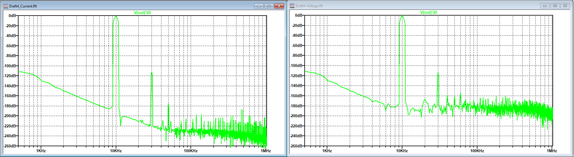

I'm particularly interested in the current input version, but that is just because my current MC preamp is based on a differential AD797 voltage input.Both look exceedingly transparent. Which would you chose?

This is the current input version.

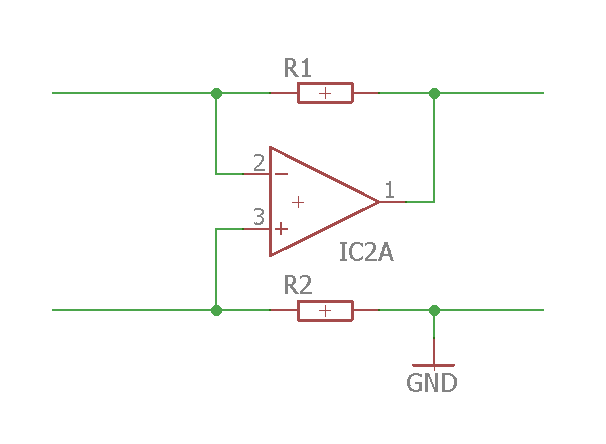

Hans, would not this input circuit do the same job? The impedances are balanced (R1=R2) and you could get rid off the NUL-knot...
No, I referred just to left part of your circuit. The couling-caps have still have to be inserted... This is basically an I/V-converter and R2 ensures balanced operation
Thank you for your contribution. Maybe you can draw a more complete circuit, because I don’t get the message.
This is what I meant, but now I'm a bit confused myself... 🙂 Never used phantom power...

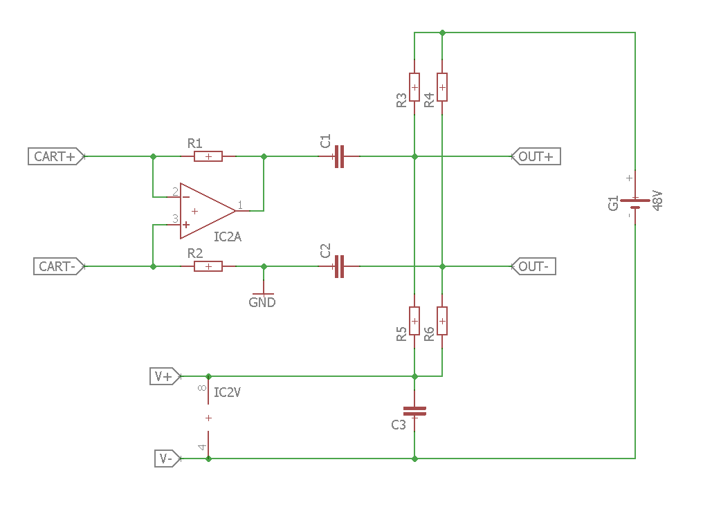

This circuit doesn’t work for several reasons.
1) the Cart has no reference voltage, the Nul in my case, so everything will collapse to Gnd.
2) when you give the Cart a voltage somewhere in between gnd and opamp supply, a DC current will flow through the Cart, that’s exactly what we don’t want.
3) when Cart is playing, opamp tries to Produce a voltage around zero volt, which is not possible with V- at Gnd.
So to let this work, The Cart should get a reference voltage somewhere in between and R2 should be connected to this same voltage. And there you are, that’s what I have done.

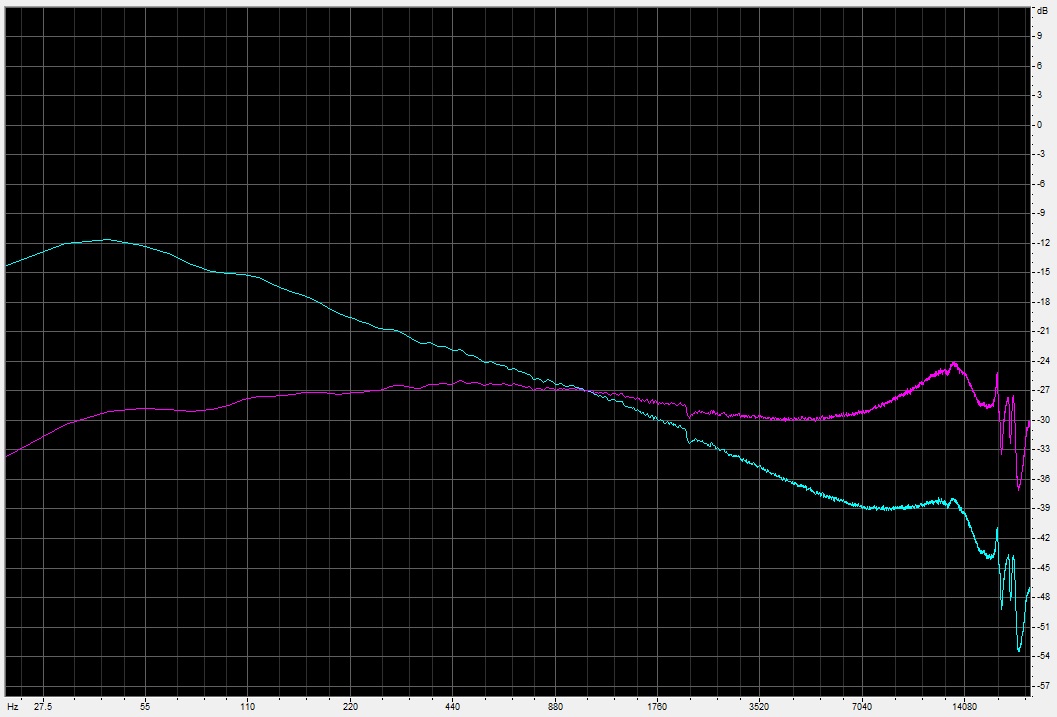

OK, I ran this last night and I hope it confuses others as it did me at first. Pink noise from one of the STR series LP's, I only have one TRS to XLR adaptor so I could only do one channel of the 2i2 direct differential in and the same channel through my pre-amp which measures with a synthesized RIAA pre-emphasis +-0.1dB. This is a Grado MI cartridge.
Plot 1 - Pink is direct in and blue is the RIAA pre-amp. Please bear with my reasoning. What I see here is with direct in we have the pre-emphasis acting like a negative "pinking" (RIAA endpoints are -20dB and +20dB over 4 decades). What's left are the two bumps when you straighten out the RIAA. The blue plot should be straight (the 14K peaking has been in every Grado I have ever tried) and 1/f (pink). All the plots are normalized to be equal at 1kHz.
Plot 2- I used an un-pinking FFT filter on the previous plot. I am disturbed by the slight residual tilt on the RIAA pre-amp, so I need to check a more modern pink noise test record, but it basically makes sense.
The noise floor with reference to a blank groove was within 1 dB on both plots.
