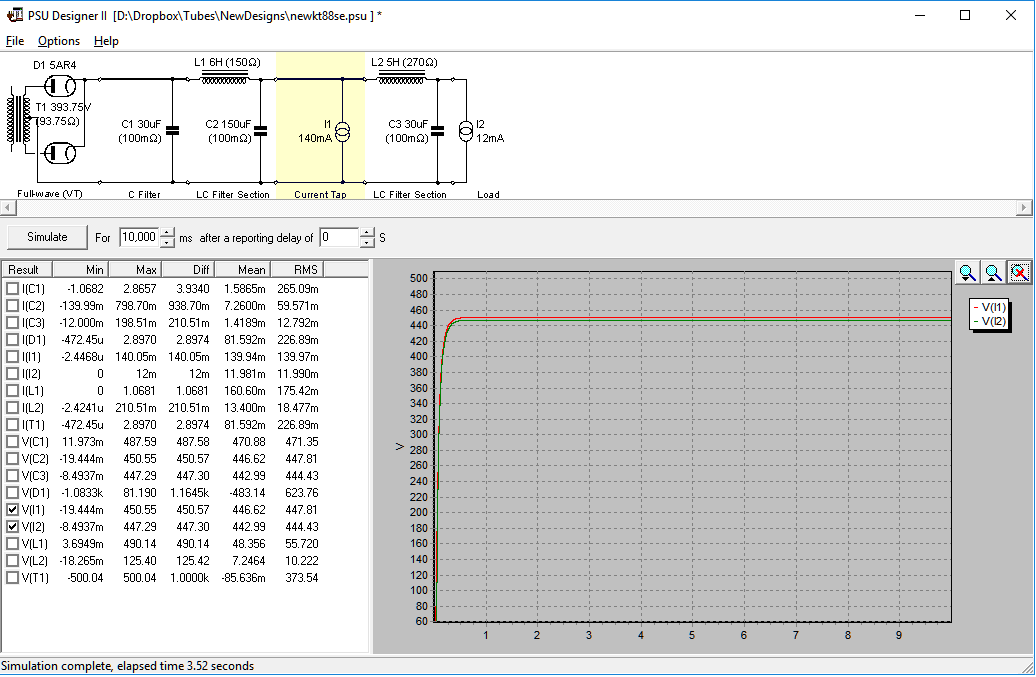

As an aside, how critical is having the capacitor before the choke, as well as after, in terms of performance?
Are we at the 'cork-sniffing' end of the spectrum, or is it a serious design flaw to omit it?
You can get reduced ripple using a capacitor input, but for that to be most effective as you have said your B+ goes way up using the transformer you have shown. Based on the PSUD2 simulation I did, with the choke input filter you have a pretty good spike at power on and about 500mV ripple on the B+. Someone please correct me if I'm wrong, but I think the ripple voltage is reduced at the output by the square of the output transformer turns ratio. If you are using a 5k:8, then 500mV/25 = 20mV ripple at the speaker. That is going to be fairly audible I believe.

Back to the drawing board then!
Unless I'm mistaken (and I frequently am 🙂) there will have to be at least two more RC filters, to drop the voltage to 320V and 310V for the output valves and driver stage respectively. Can I expect these stages to aleviate the problem at all, or do I need to eliminate the ripple closer to it's source?
edit:
I'm using a 2.5K:8ohm output transformer, not 5k;8ohm. Does that work in my favour, or against me?

2.5k:8 would make it worse, however; I figured you were going to use an additional RC stage for the driver, but if you are going to use an additional RC for the output valves, that would get you much closer to what you want. Something like the attached.

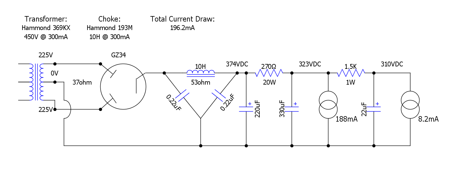

Matt,
What current are you going to be running the EL34s at? For first RC after the choke, the 250R resistor would need to be a 25W part.
Hi Scott,
Total current draw is 196.2mA, less 4.1mA for the driver. I've attached a more complete drawing of the power supply. Can't seem to get PSUD to export pretty pictures (or save for that matter!), so unfortunately most of the detail has been lost. These are the values I've plugged in:
I calculate the 220ohm resistor dissipates just shy of 14W, which is a lot. I've opted for a 20W part to be on the safe side.
Even so, I'm not really happy wasting that much energy. I'm thinking it might be in my best interests to think it through from the start. If I can't find a transformer to fit my voltage/current needs, perhaps I can adjust my voltage/current requirements to better fit available transformers.
Matt.
the 220 ohm is like a very small pipe which will stop any water flow changes.
The only thing that will enable surplus flow to collect is the 330uf capacitor, which means after a louder music section the amp will sound sluggish, limited by the 220ohm no matter how powerful the power transformer, it is going to heat up so much!

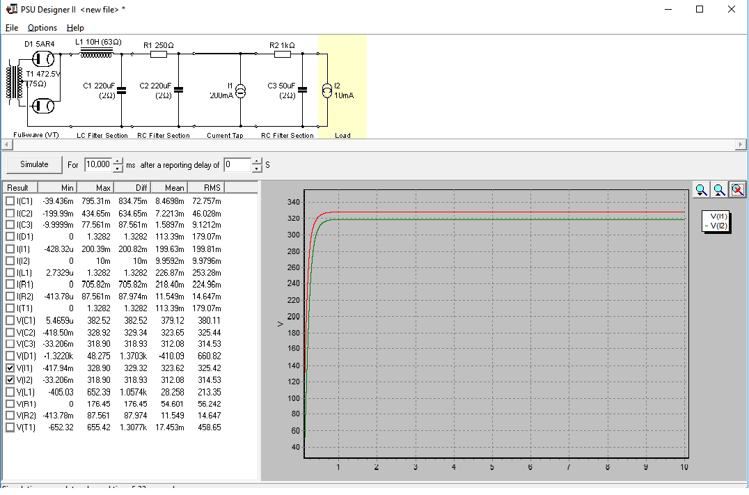

...Can't seem to get PSUD to export pretty pictures (or save for that matter!)...
In Windows: PrtScrn and a graphics program to crop and annotate.
PSUD should be saving its own proprietary project files when commanded. I have several here. However when I attempt to Attach, DIYA forum objects "Invalid". ".PSU" is not on the list of approved file types. It maybe could be, at Admin's discretion. You can trick the upload by appending ".TXT", but it is not really a Text file so would confound many people. Running through a ZIP encoder may be the bestest/safest way to pass .PSU files through the forum.

Indeed. The more I learn about power supply design, the more I realise I don't understand.
It's becoming increasingly apparent that this particular PSU is fundamentaly flawed; It seems a ground up rethink, of the entire circuit, is in order.

Matt,
Yes, that's a lot of wattage to dissipate. That's why it's easier to start off with the desired xfmr voltage to start with and use the capacitor input before the choke to get the ripple down first. Then you don't need to drop the voltage and dissipate all that energy. It will work like you have it though. You do realize you can run the el34s at a higher voltage. No problem with 400v or so and 450v caps are standard availability. Motor run caps are also popular for higher voltages. Take the AC rating and x1.414 for DC rating. These usually come in 370 or 440 AC ratings.
When you have your psud2 graph displayed, use alt - prt screen, then paste to MS Paint and crop like PRR said. Save as png or jpg and your done.

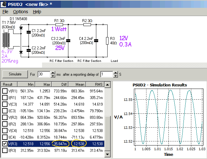

Matt,
For example, this simple power supply using polypropylene motor run caps achieves very low ripple and close to 1mV hum at the speaker terminals. The 150uF cap shown is actually three 50uF in parallel. This is for EL34s, KT88s, or 6550s.

the 220 Ω is like a very small pipe which will stop any water flow changes.
The only thing that will enable surplus flow to collect is the 330uf capacitor, which means after a louder music section the amp will sound sluggish, limited by the 220Ω no matter how powerful the power transformer, it is going to heat up so much!
Yep. It is for this reason that one doesn't "design to a voltage spec" for the finals. It is a common mistake - especially for people who like using "design tools" - without really knowing the math itself that makes their designs accidentally work on paper.
There's one thing to keep in mind: Up to "the final" stage, the lower stages use so little current, and so well averaged by RC filtering, that they can be done in exactly the CRCRC… fashion the OP imagined. The final tho? It seriously just needs to be transformer → rectifier → capacitor → smallish inductor → capacitor. If it HAPPENS to be "320 volts", well alright. If it is 343 or 361 or 299, also "alright". More is better, but only up the dissipation and design limit of the output tube. And luck.
Moreover, the output transformer - especially in a SE design - is itself quite a filter. it does a good job isolating any unfiltered-out power supply hum from the plate of the EL–34 (or whatever) final tube. Nature of inductors. Even if they include transformative secondaries!
