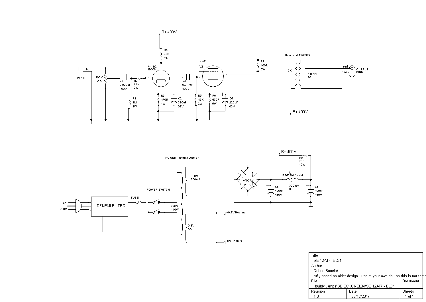

This tread was not for nothing. I was trying to design a similar amp as you and it helped me to get to this design 🙂. I don't know if i'm going to build it. I would like to simulate it before i try, but i don't know how to do that...
Did i make obvious mistakes? And how do you simulate this?

WAXX:
(1) your input jack is "upside down". The tip is connected to input of tube, not the "ring" or shell.
(2) C1 strictly doesn't need to be 400 volts. There is no HV path to U1's grid. Even if tube fails.
(3) The gain on ECC–81 is high. gm = 5.5 ma/V nominally; with plate resistance, maybe (g = 44) or so.
(4) The C2 of 330 μF is overly large. 47 μF delivers –1 dB at 15 Hz. In general, smaller capacitors are better capacitors, linearly
(5) The R4 = 24 kΩ … only dissipates about 0.5 W nominally. 5 W is a bit overkill. I might edge toward a 2 W carbon-comp or metal film. Much improved sonics compared to a wire-wound. And easier to get.
(6) C3 is a poor choice, given R5 of 47 kΩ. The –3 dB knee is at 72 Hz. You'd want that closer to 10 Hz, ideally. Simple scaling gives the answer: 0.047 μF • ( 72 ÷ 10 ) = 0.33 μF.
(7) R5 of 2 W dissipation is ridiculous. It is a near-zero current almost-at-ground resistor. Just use a ¼ or ½ watt standard resistor. Also 45 kΩ? You want the closest 'standard value' resistor. E–24 or E–48 scale, so 47 kΩ. Not 45 kΩ.
(8) It really isn't clear why you'd specify a 220 μF cap for U2's cathode bypass, and 330 μF for U1's. “More for the final”. Now … I'm not saying 220 μF is a bad value. It just is stark contrast to the U1's cathode bypass.
(9) on your power supply, it is ALWAYS better to have 2 "filter" stages at half-inductance, than 1. Drive the final off the first stage, drive the input off the 2nd stage. 5 Hy is enough for each.
(10) Personally, having had my fair share of diode failures, I'd DOUBLE UP the 1N4007 rectifiers. 2 in series for each position. Just IN CASE "one goes".
