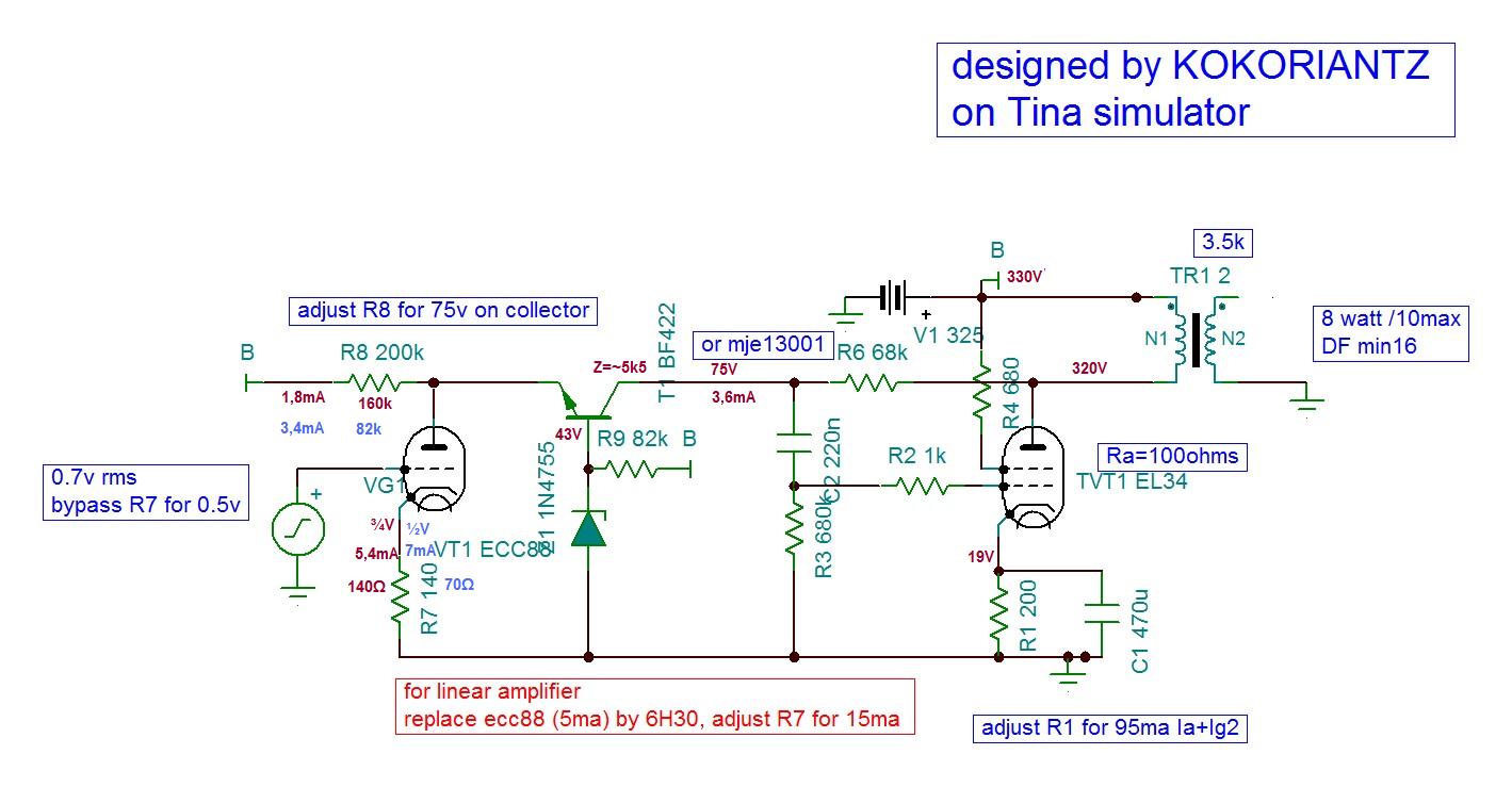

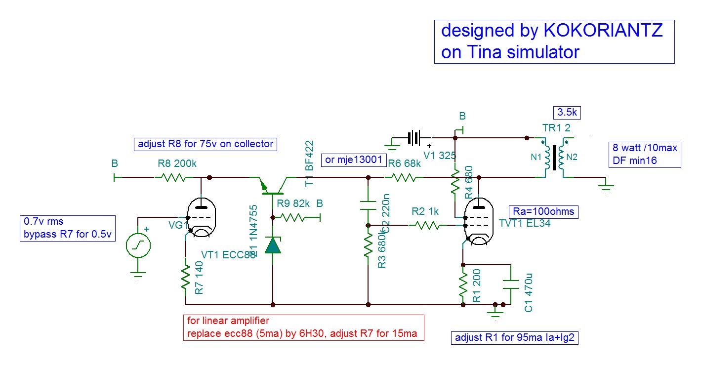

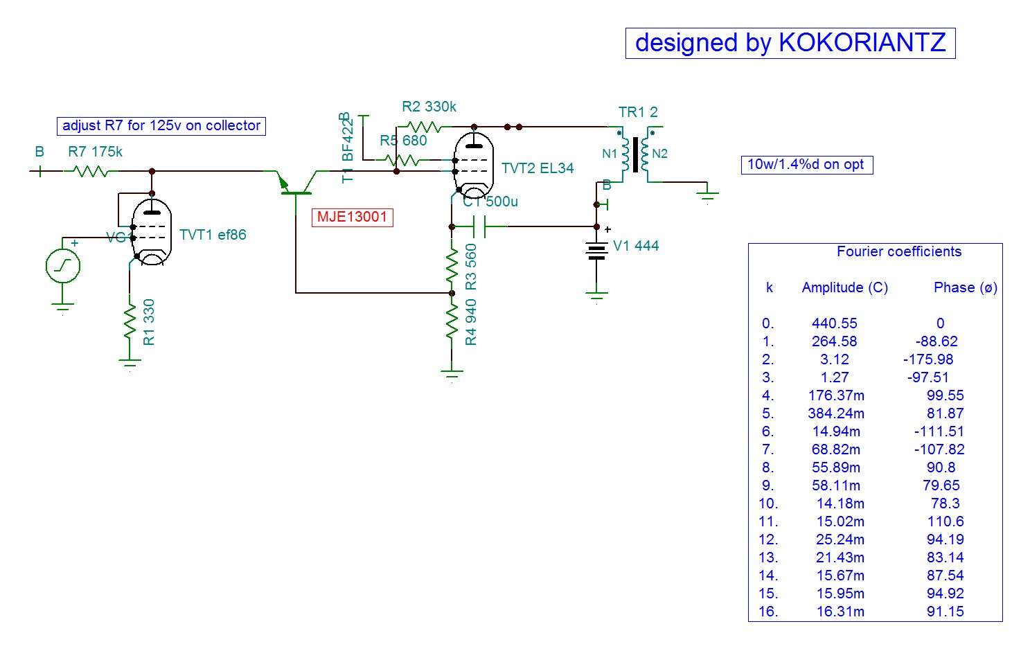

reinventing the wheel
Extra power,higher DF,lower distortion from SE pentodes
try 3.3ohms (your design Ri) in series with your speakers and listen about an hour or two, than decide.

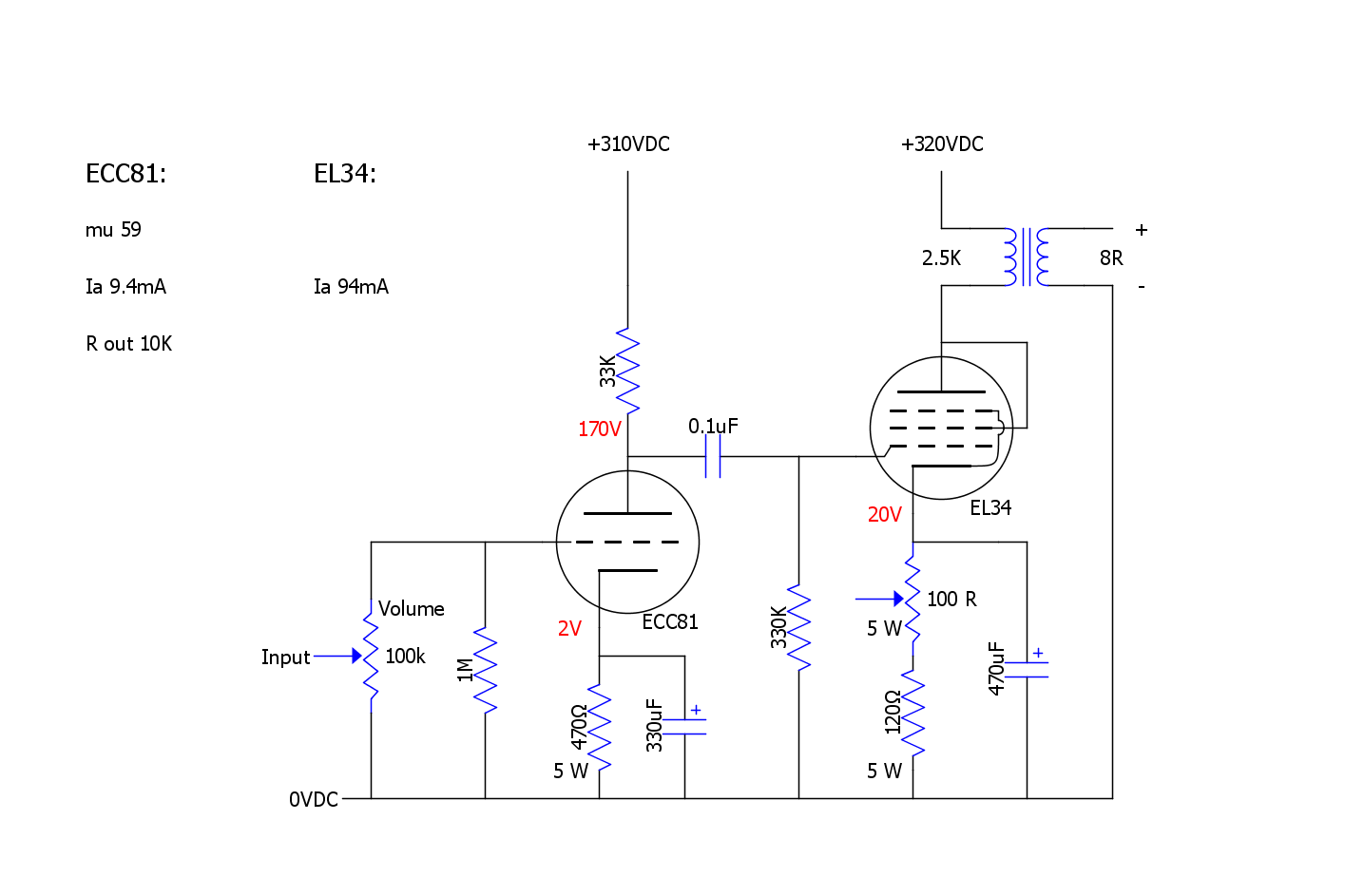

Good evening all,
I haven't had much time lately to work on my project, so the power supply is still to do. I have had time to re-work the driver stage.
Following the advice given I've re-designed it around an ECC81, as opposed to the EF86 I was using earlier:
One triode drives each channel, saving on parts and space, which is a win/win situation 🙂.
Any thoughts? I'm aware that this is just about as simple as you can get, but I'm trying to keep things that way for the time being, until I understand a little more about valve theory, and indeed electronics in general.
I've calculated the R out of the ECC81 as 10K, which is on the high side. Will this load the output valve too much? If so are there any simple fixes?
Thanks,
Matt.

Your 12AT7 operating point pencils out, but the cathode resistor doesn't need to be a 5W part (it dissipates less than 0.01W).
The 12AT7 operating point doesn't take advantage of the generous plate dissipation available with that tube, but I'd say build it as-is first, then you can mess around with changes later. With your available voltage, loading the 12AT7 with a plate choke or CCS might be a good idea down the road.
I would consider adding a small (ie 47 ohms) placeholder resistor in between the 470R+330uF to ground. This way, later on if you want/need, you can adjust the audio out come by adding NFB without rearranging all your pretty layout and wiring. I would also add a grid stopper resistor (ie: 10K) to the grid of the EL34 for the same reason.
If he's married to triode operation, feedback shouldn't be necessary.
A 10K grid stopper is really high for a triode wired EL34, but not such a problem if it gets wired as a pentode.

Thanks for the advice. Nice to know it works on paper, at the very least. I fancy the 5W is a typo, although checking my working I had not calculated dissipation, so I may have been hedging my bets. I hadn't realised it'd be quite so low.
Regarding the 'generous plate dissipation', am I right in thinking that's another way of saying I could be using a higer voltage?
Reading around on the subject, it seems that a CCS is a good idea (or at least currently fashionable, no pun intended🙂), but I don't properly understand what they're doing, so I will steer clear until such a time as I do. Adding silicon would also require additional power supplies, which I'm keen to avoid at the time being.

...rearranging all your pretty layout and wiring...
You must have me confused with someone else 🙂.
Joking aside, thanks for the advice.
Matt.
If he's married to triode operation...
Not quite married, but at this late stage I think it would be considered a jilting at the alter 🙂.
Matt.
