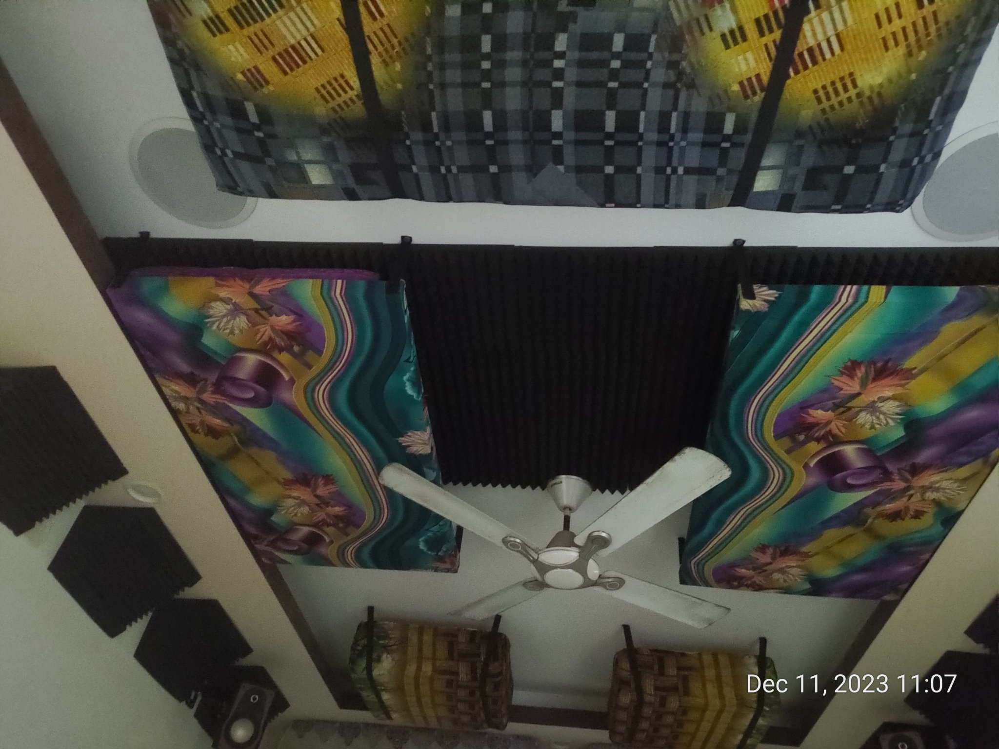

Hemi anechoic ( on the roof)! Such a great experience. The first generation of Hidley's room came from a night were they setted up a pair of Westlake ( Hidley's own brand of loudspeakers) on the roof of a studio for a party. He was blown away by rendering.
Another example of what you'll read of a no no is Blackbird studio C also known as Massenburg's room. Georges Massenburg implemented a fully diffusive room with help from D'antonio ( RPG owner). In theory it is a no no but in practice it works if implemented with a non repetitive sequence ( random)... Pano experienced something similar in his 'lava cave' when he lived in Hawaii...

Although this what my roof already looks like with some decay elements and FR treatment(airgap sandwiched treatment between thin 2 inch absorption). All these did bring positive changes in listening as these changes were all incremental. So there will be some rework if I dare to do any changes. I think we will continue further in PM without deviating much on this topic.
