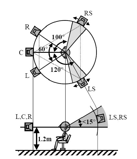

With surround loudspeakers in a 5.1 ITU-R-BS-775-1 configuration in-room...
...and with the tweeters at ear height while seated, I find that having two ESS AMT-1s stacked on top of each other with a bit of neoprene spacer between them to angle the top AMT-1 upwards ~15 degrees does a nice job of spreading the vertical polar coverage without audible hole in the output pattern vertically.
So that would mean zero degrees down angle (i.e., AMT at head height while sitting) and +25-30 degrees upwards.
I've tried many other approaches to get 90 degrees of horizontal coverage down to ~600 Hz and enough vertical coverage angle to make the room feel alive instead of dead.
For front-only left-right loudspeakers in a typical stereo layout, I've found that the tweeter vertical coverage angle requirements (psychoacoustically) are about the same.

The reason why I was differentiating between front loudspeakers and surround loudspeakers in a 5.1/7.1, etc. array was due to the basic 5.1 multichannel loudspeaker array functions (i.e., "ITU"). I simply gave an example that I use in my setup now.
I think you might have missed that distinction in the sentence fragment that you quoted, above. The primary purpose of surround loudspeakers in home theaters and higher quality multichannel arrays is to provide LEV. Surround loudspeakers also need to provide ASW, too.
I also referenced the front left/right channels typically used in a stereo setup and gave my impression of the vertical coverage requirements of a tweeter/high frequency driver/horn/etc. for stereo only.
Actually, what I described is the polar opposite of "head in a vise" that is typically found in planar dipole stereo setups with that distinct limitation of "head in a vise" performance. Anywhere in my listening room outside of the first meter or so from the front wall, you can move around and listen to a stable soundstage image when playing multichannel music. Having this capability in my setup was one of the goals in my setup's development. I simply reported on what I found along the way with regard to vertical polar coverage needs in a loudspeaker at higher frequencies.Could serve as the definition of the so-called "head in a vise" situation, with all the precise angles and levels. I'm pretty sure most DIYers dont have the latitude to implement it inside of wherever they live.
In my setup, I can walk from side wall to side wall while playing multichannel music, and still have a stable frontal soundstage image and enveloping ambience that is unchanging. I do admit that it takes a bit of work to achieve, but I do consider myself one of those "DIYers" you refer to.
Perhaps you're not familiar with standard multichannel arrays, i.e., the ITU layout (among other multichannel configurations)?

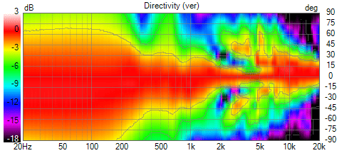

Here's a (anechoic) vertical response of one of my designs, normalised to the on-axis. For this design I chose the midrange as the design axis.
design:

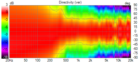

Here's the (anechoic) vertical response of another one of my designs:
Design:
Yes there is huge difference in dynamic range (>10dB difference). So when I level match and bring down the big system by 10dB, I still really enjoy both.
So, in room, with all the reflections, I can't say the difference in vertical directivity is a major factor...

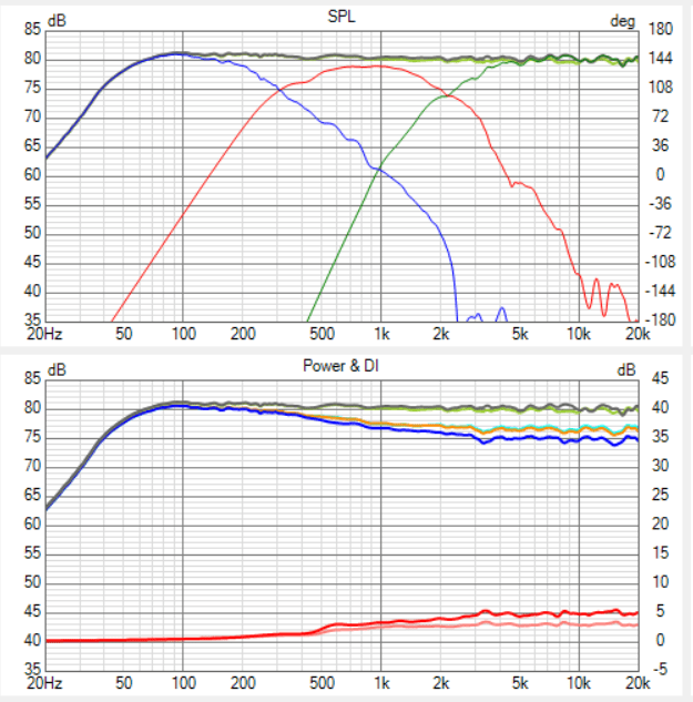

More investigations on directivity ongoing...
