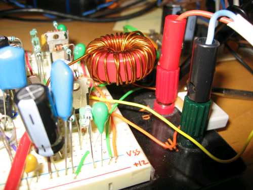

Maybe we should aso discuss placement of the coils.
I'm workng on a muck up for a single ended design, and have a filter of 20uH/1uF on the output. The coil is a Micrometal T157-2 as described in a earlier post.
I think the coil produces quite a lot of noise that couples into the amp!
Placing a finger on the coil reduces the noise a lot.
Moving it around also changes the level of noise.
Question is how should it be placed on a final PCB😕
From paper by Bruno on Hypex web, it can be read that Toroids are to be avoided (don't really believe that), but also that it is important that the coils are placed flat on the board with a sufficient ground layer under.
I tried to take a pice of grounded alu foil and placed it nea the coil, but it seems to have almost no effect.
Maybe it's more the 2" of wire thet is connecting the coil more that the coil.
I would guess that the coil should be placed as close to the mosfets as possible.
Despite what people says, toroids actually produce very strong stray magnetic fields in the near field and in all planes, cancellation is only achieved in the far field. E cores are easier to handle because they unly produce stray magnetic fields in a single plane which may be chosen for minimum interference.
Try to place the toroid 20cm away from the breadboards.
