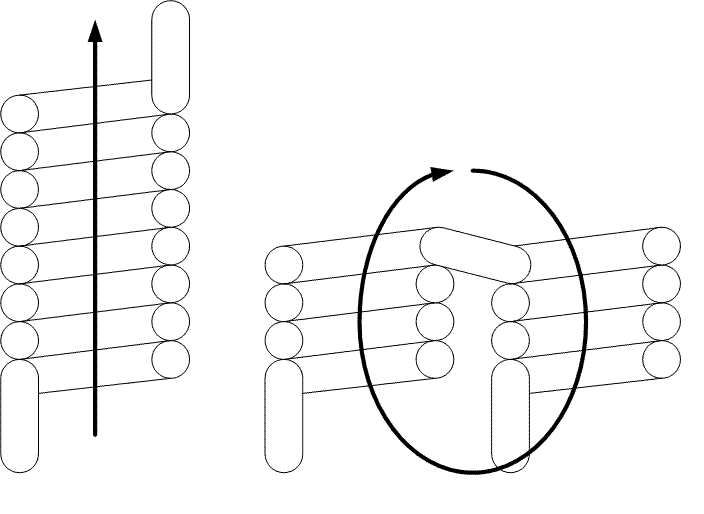

One way of reducing EMI is to use two coils elecrically in series but mechanically parallel- so that the fields cancel to some degree.

phase_accurate said:One way of reducing EMI is to use two coils elecrically in series but mechanically parallel- so that the fields cancel to some degree.
that's interesting. Can you please make a practical example for a non-technician like me?
Thomas
If you have mutual coupling between two coils so that the fields partially cancel out to reduce the stray flux, you will also have a reduction in inductance. You can't get something for nothing here!
Normally we don't do it like that because you are relying on the proper magnetic field generated to maintain the inductor performance. This is one reason why two inductors are placed such that the magnetic fields are perpendicular to each other in speaker XO design. The same applies in output inductors.
With the RM core or Toroidal design, you are not canceling the magnetic field but sort of containing it.
I think you are comparing apples to oranges here ! In an x-over you definitely don't want the tweeter highpass to interfere with the woofer's lowpass but I don't see a problem where a single inductor split into two halves interferes with itself.
And yes, inductance could be lower in some cases than using a single coil but that depends on construction (hint: two coils of half the length) but it would still be higher than the inductance of an air-cored toroid of approximately the same dimensions.

Just for an experiment, I took two 2mH inductors and put them on top of each other such that the widings were in different directions and connected in series. Resulting inductance is 2.6mH. I do not believe that this will actually behave like a 2.6mH inductor because if the magnetic fields are not balanced, the resulting signal will be distorted.
Has anyone actually tried this in practice?
The additional wiring to create the same inductance would be increased such that the resulting inductor would not be a good inductor.
You would have to place them beneath each other and wired such that the inductance increases. Then a large part of the field lines will go through both coils like in an R-core transformer. It does definitely not cancel the stray-field but it reduces it.

phase_accurate said:You would have to place them beneath each other and wired such that the inductance increases. Then a large part of the field lines will go through both coils like in an R-core transformer. It does definitely not cancel the stray-field but it reduces it.
Regards
Charles
If the inductors are connected such that the inductance increases, now the inductance will be 5mH, and the coils actually run with the windings running the same direction, thus the EMI problem would be worse.
I doubt there is any actual application using two coils, it just contradicts basic physics.

Oh, side by side.🙂
This does contain the magnetic field, but I wouldn't call than cancel. But I do wonder what it would do to signal passing though it.😕 These have to be matched very well to avoid distortion. Same in R-core transformers. But transformers are operating at a fixed frequency, this kind of arrangment with the way flux changes with frequency, I would think there would be quite some distortion.
I nevcer said that they really cancel but the stray field will be reduced in the mid- to far- field and that could make a difference in some applications.
And I don't think that the topology alone will lead to nonlinear distortion if used with air coils

Indeed: no combination of linear coils, balanced or otherwise, can produce non-linearities; there is no "magic" in magnetic fields: they simply add and substract vectorially.phase_accurate said:And I don't think that the topology alone will lead to nonlinear distortion if used with air coils
